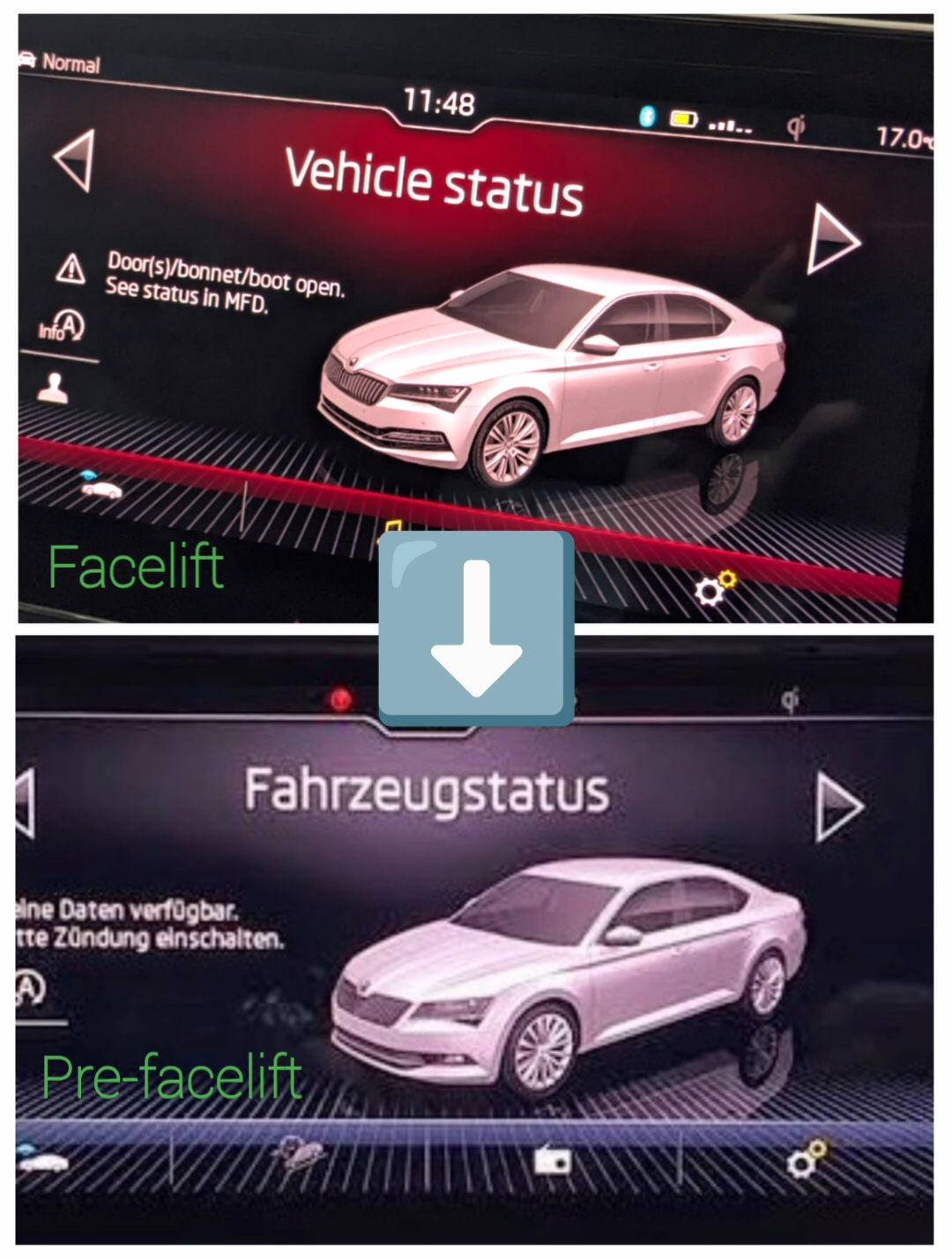

Anyone know how I can change the car variant/skin on my Columbus MIB2.5 infotainment from a facelift Superb (top pic) to a pre-facelift Superb (bottom pic)?
I have a MY17 Superb which I  recently did a conversion from MIB2 8" Columbus unit to MIB2.5 9.2" Columbus - as a result, the car shown on the infotainment screen is now a facelift Superb.
I want to change this back to a pre-facelift Superb.
The OCD in me is twitching everytime I see the screen!!

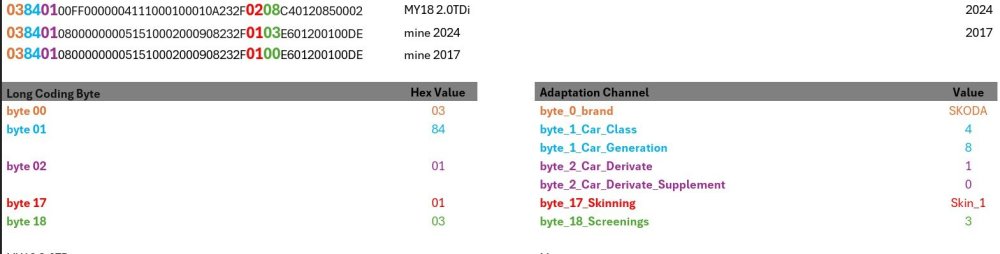

from the little i can find on Google, these are the codes (associated to 5F long coding):-
- 038401 = Superb Sedan Liftback
- 037901 = unknown???
- 038402 = Superb Combi
currently mine is set to 038401
byte 0 = brand
byte 1 = car class/generation
byte 2 = car derivate/derivate_supplement

Crazy... think I've got the image with latest update.. kinda silly but not big deal, maybe someone with nonFL model can give us first 3 byte of 5F long coding string to compare with ours. Main is 03 84 02

after i did the MIB2.5 upgrade, my 5F long coding starts with 038401.
weirdly, before i did the upgrade, it was also 038401.
confusing big time!!!
which leads me to think the info is stored elsewhere, somewhere, but i can't figure out where.
nothing on the internet seems to help with resolving this case.
i'm guessing urs is 02 at the end cause u have a Wagon/Estate?
mine a sedan/saloon.
Correct 3rd 02 estate version
So I had another look at the coding again.
Comparing mine to an MY18, the first 6 codes r the same, i.e. 038401.
But I noticed Byte 17 and 18 r also related to the Skin and Screen.
Prior to me doing the MIB2.5 upgrade, byte 18 was set to "00".
Post the upgrade, it changed to "03".
Perhaps if I change this back to "00" it might revert it to the Pre-facelift image.
Will try it some time in the next few days and report back.
Edited by JR RS

@JR RS I tried change byte 17 no luck...
