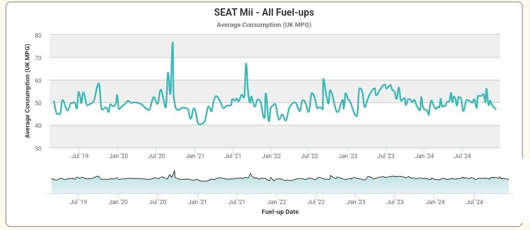

Coming up on 60k miles in an owned from new SEAT Mii (these were all 59 BHP I think?).
Best ever tank average was 76.6 mpg and average is 50 mpg (all brim to brim)
