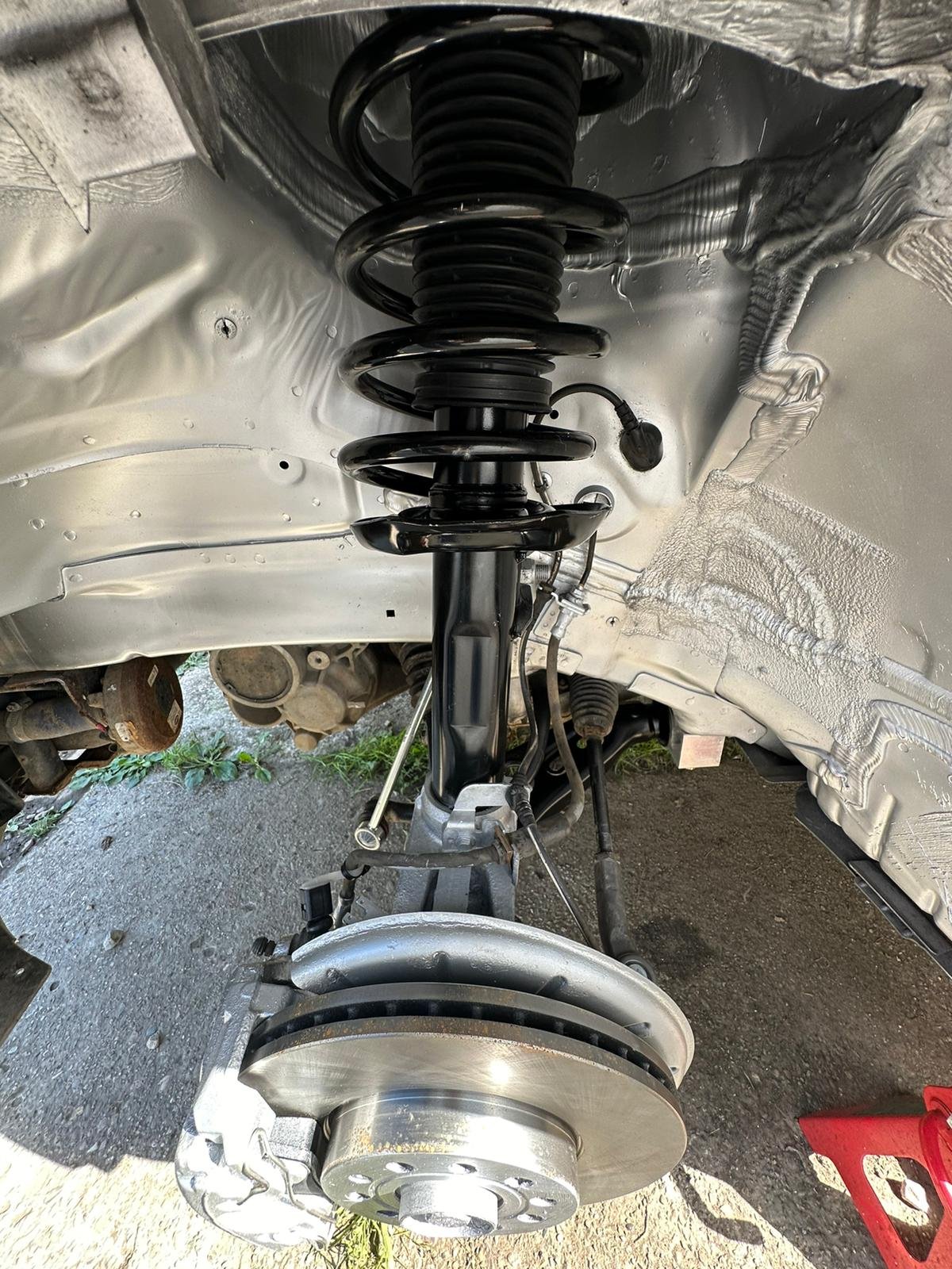

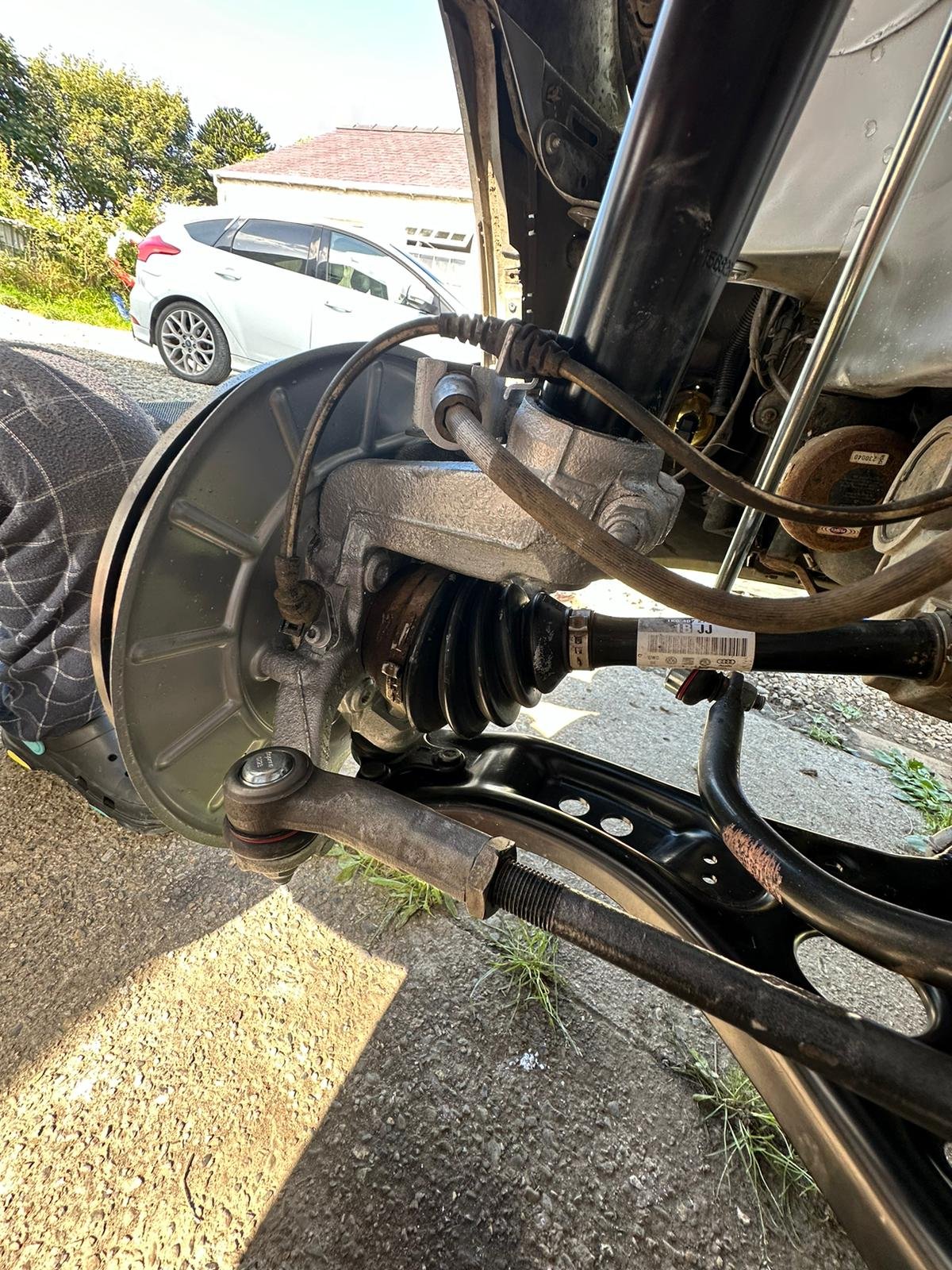

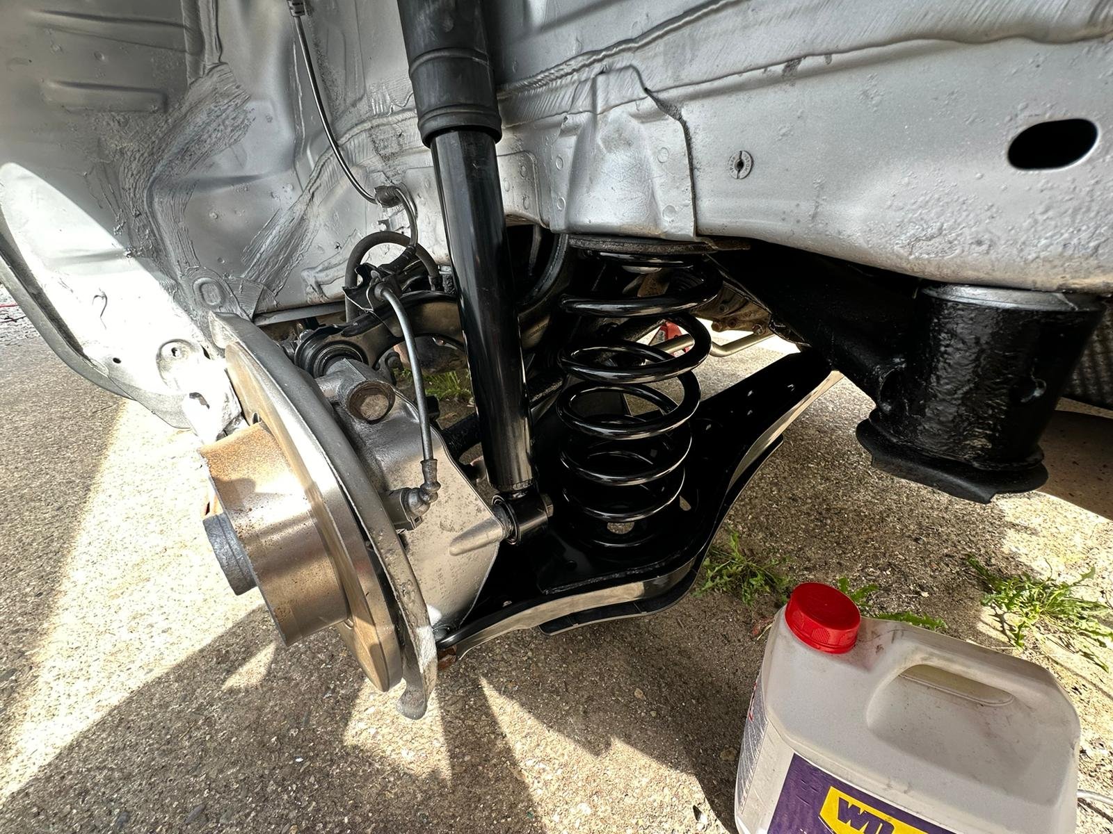

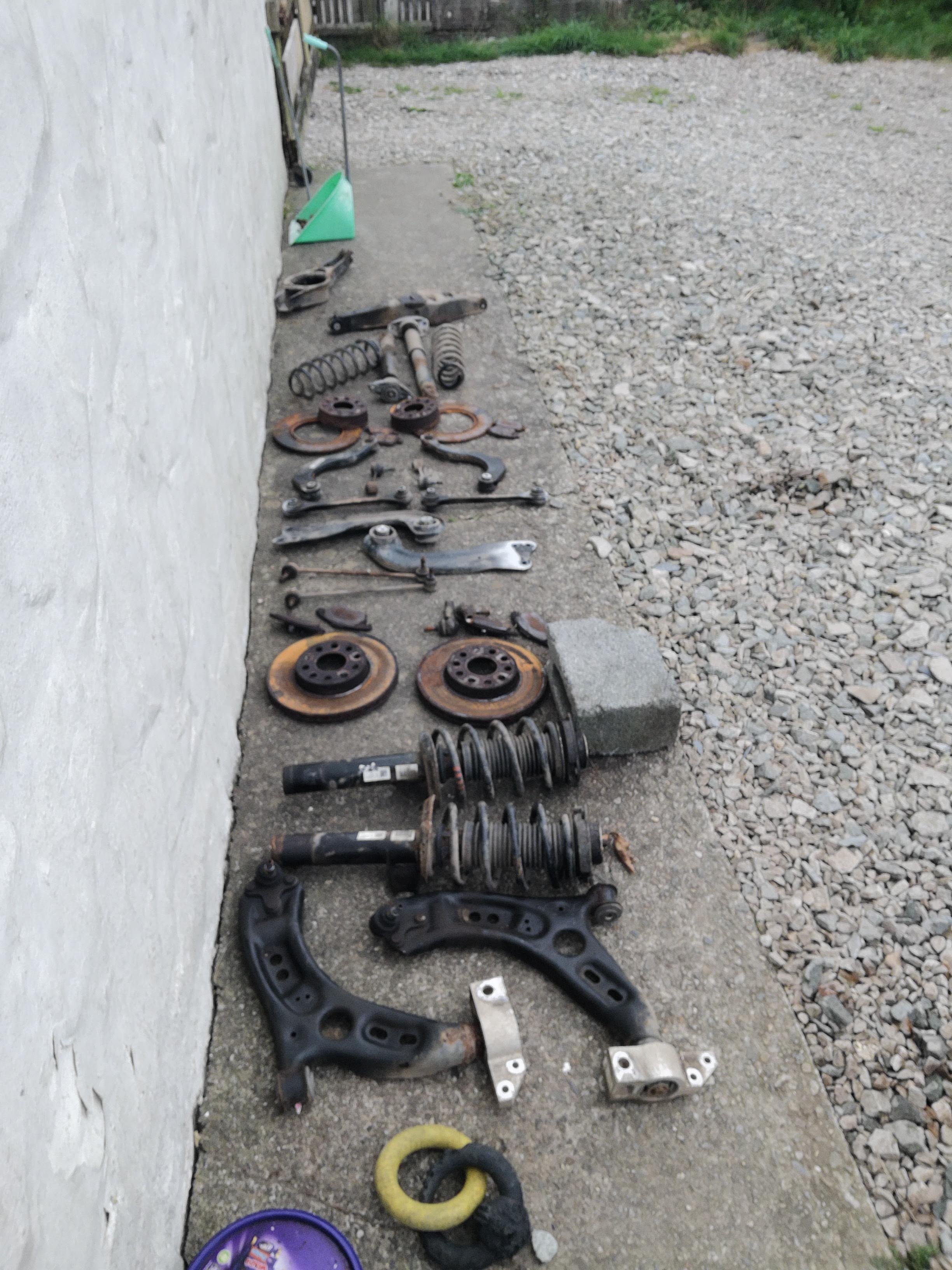

It's recently had an overhaul of rear subframe, suspension and breaks, can belt and water pump and even a pollen filter 🤓 pic of parts of parts replaced

Can't be much original left on your car judging by the pile of bits. Well done, bet it drives like new now.

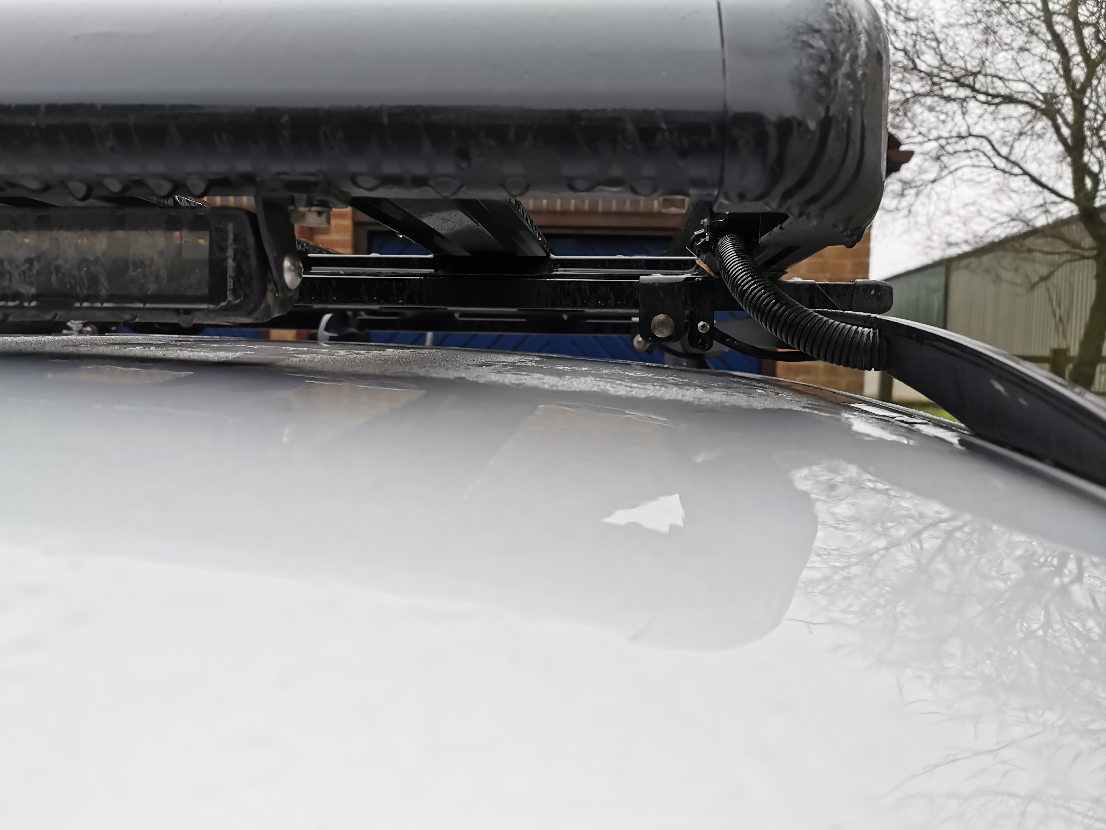

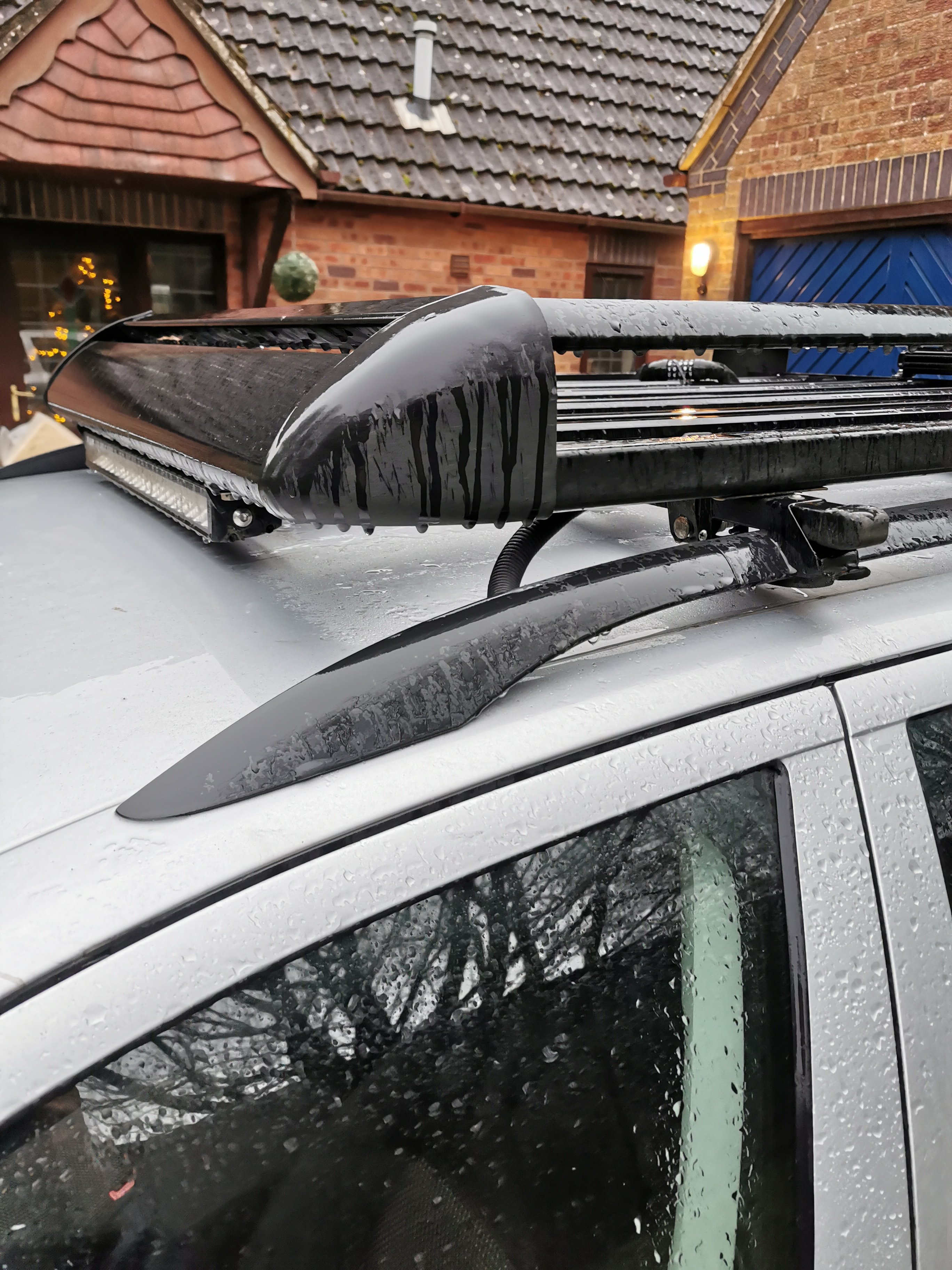

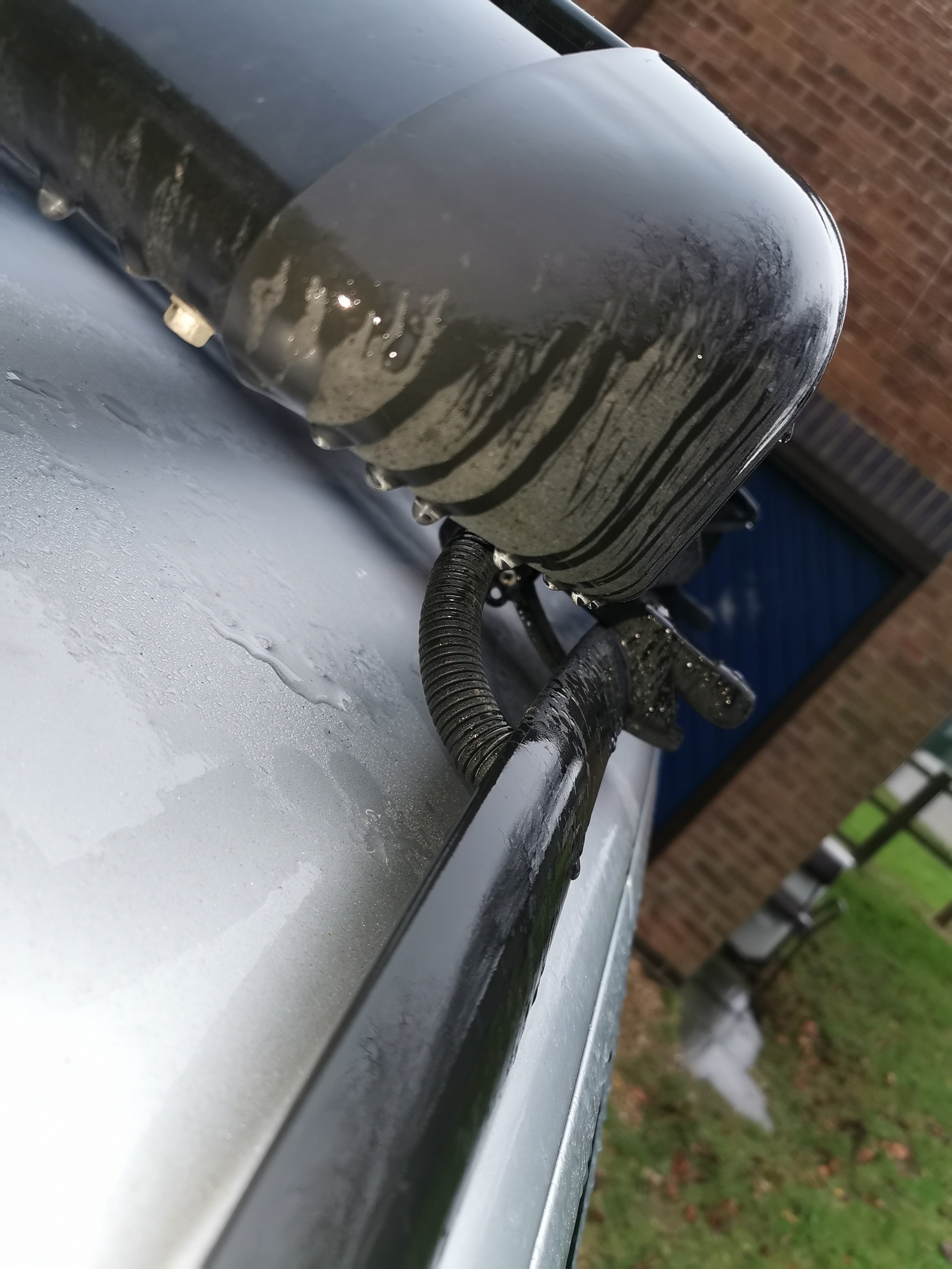

I've recently fitted some lights and roof rack with independent power and charge system - I've wired it so the aux battery (300ah - max 600ah) also serves as a jump pack/booster.
All the switch gear, fuses and tow electrics are housed in the small grey box!
The RF remotes are really handy cos they work from 100mtr away so all the family have a fob and can use the car at night to light the way as needed 🤓
What's my geek score?

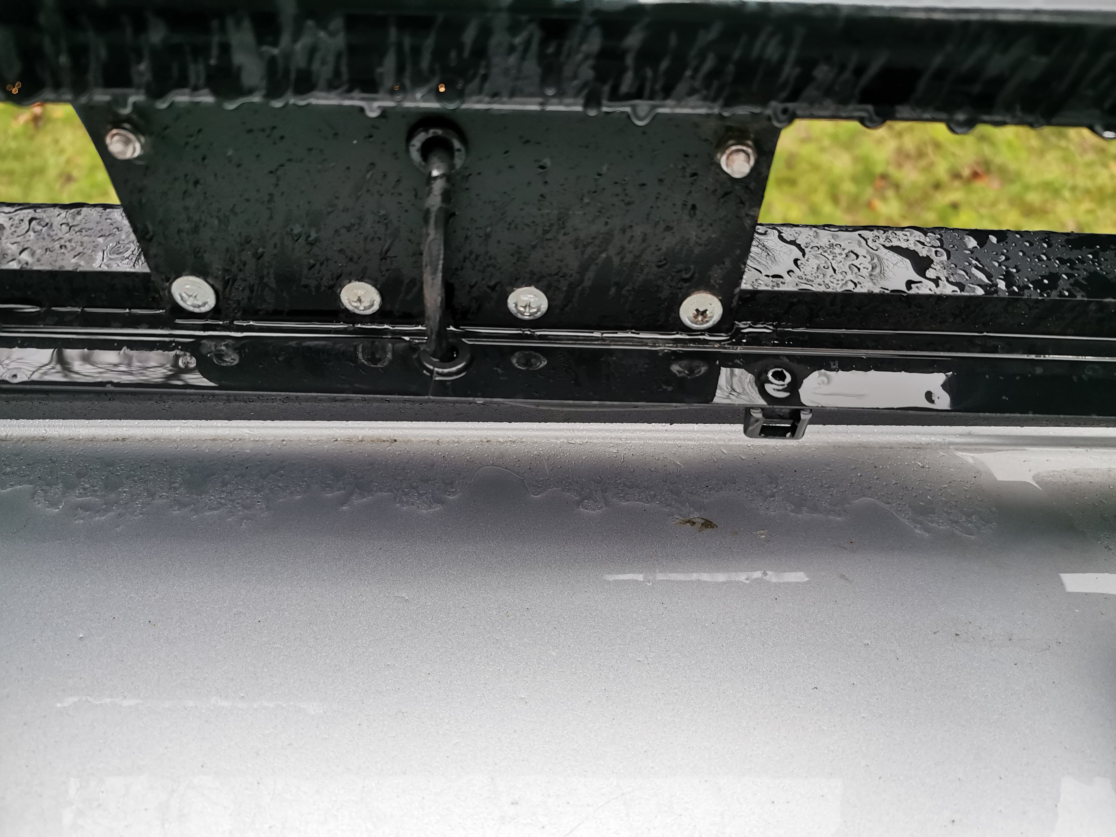

All the cables are under and secured to the roof rack
All cables come the the front corner with fitted conduit and then enter via existing hole in front roof bar mount  - this car used to be an ambulance in a previous life, I used all existing cables that were left behind (the roof rack to power supply is all new cable, obvs)
The quality of the ambulance installation was below standard to say the least.
The general condition of the car and wiring is now to a more acceptable standard and one step away from becoming a zombie apocalypse battle tank 🤣

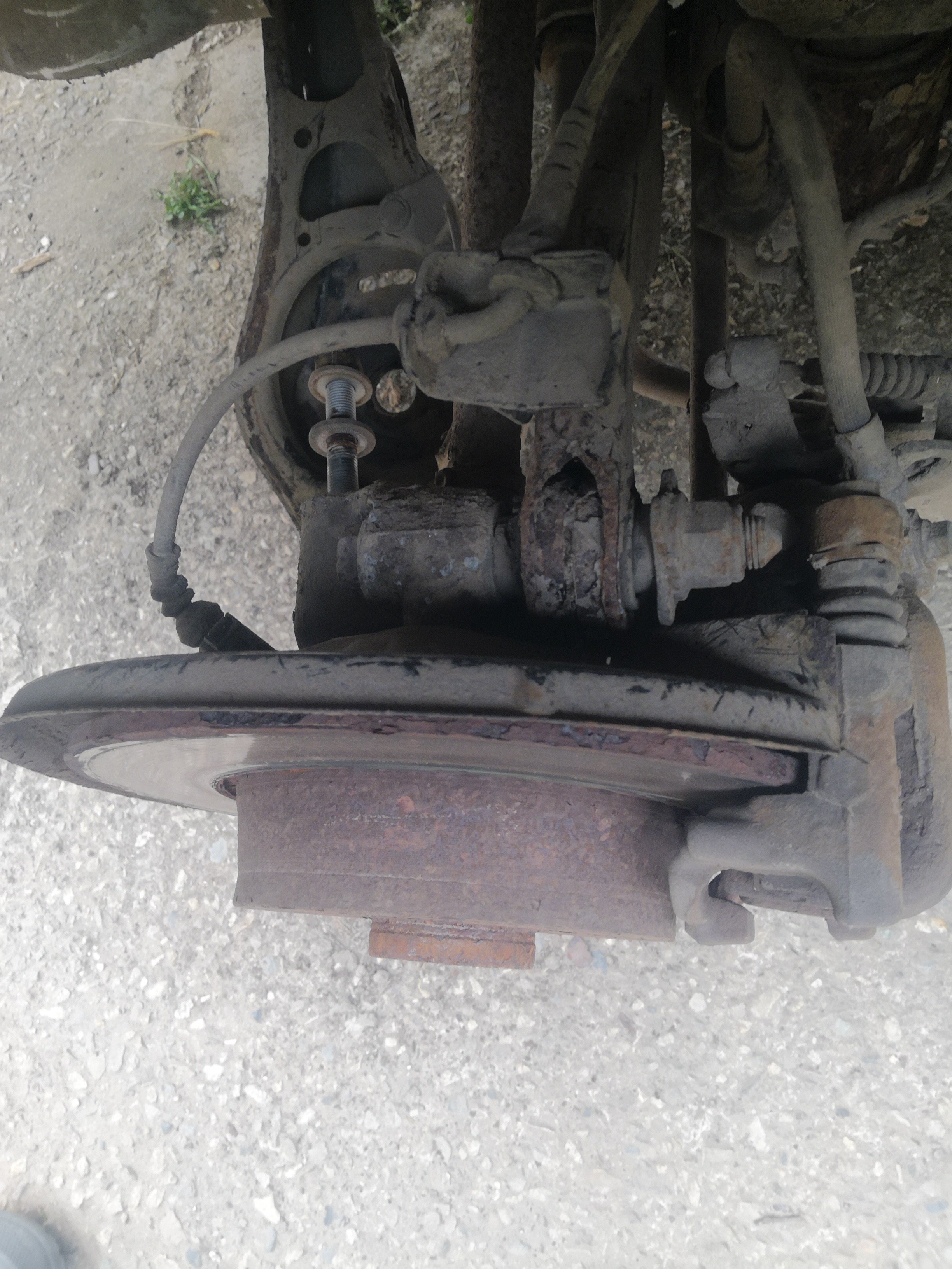

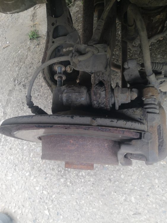

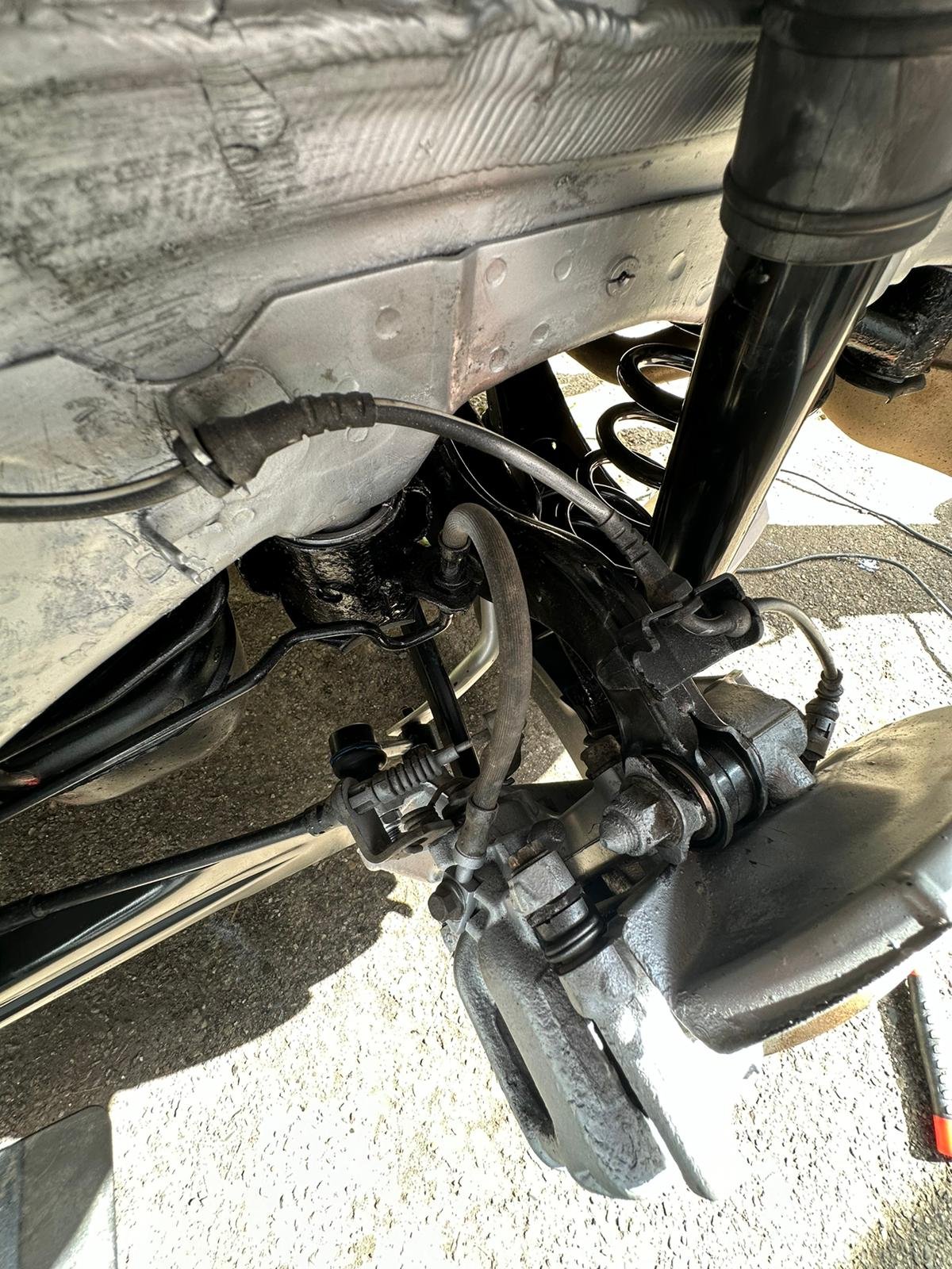

When I did the suspension overhaul I took the time to strip out everything I could, removed any rust and painted with hammerite or stove paint.
I even took the anti rollbar off and painted that!
With the rear frame stripped it was an easy job to clean n paint everything but it was hot, really hot. I had to drink beer to survive 🙏🍺
Thats a very nice job. Did it once on an old volvo940 and it drove like new and also lasted for years. Need to do that on my 2012 octavia estate before it gets too bad. The older 08 plate I reckon is now past it. By the time I rubbed it down and treated all the rust its going to be cheaper buying another one plus guaranteed I would find a few holes that need welding which I am not very good at and hate doing anyway. Got loads of space at my place so old cars just end up sitting as parts donors. It is turning into a bit of a scrapyard/graveyard though but has saved me a fortune over the years. At the moment I have 8 various vehicles or so called projects plus 2 on the road. Saving up for a 4 post lift.

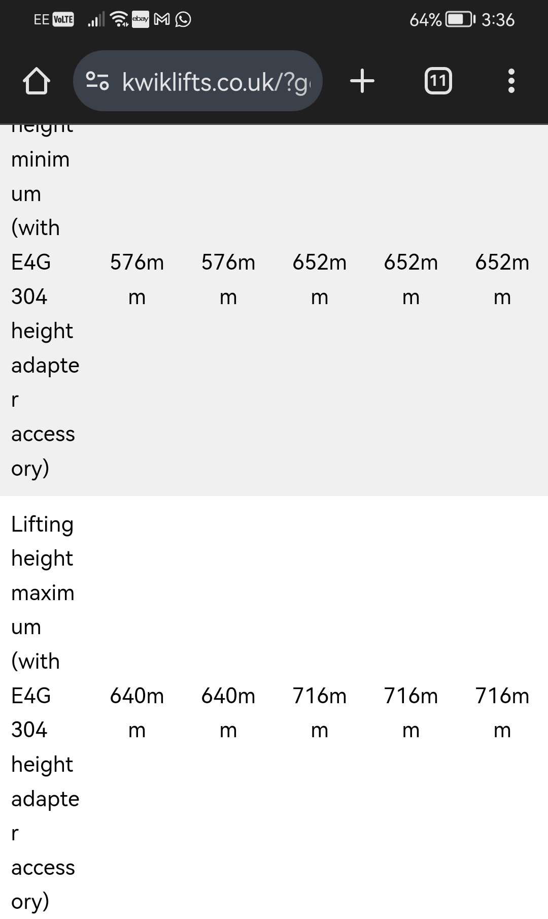

Have you seen these before?
I'm considering the investment... I don't have the height for a 2 post lift or I'd have one (you can get new 2 post lifts for around 1200 quid now'a days!)
https://kwiklifts.co.uk/?gclid=CjwKCAiA65m7BhAwEiwAAgu4JNiY9f6LqHjAk1dVOTTgTNG6XGsDh2EWX8oQxpuFAHLiJ0Jl536nfRoCPTIQAvD_BwE
450mm lift height (which will be less allowing for clearance to slide lifting blocks in is less than my trolley jack can achieve, if there is height enough for the columns of the 2 post lift can you not use a limit switch to prevent contact on the roof? I'm sure you would gain more working height and also free access underneath where it is needed.
Max lift is about 700mm
These are handy as separate units and can hang on a wall when not in use and if needed you can transport them
I've got about 700mm from my roof rack to the wooden joists
Would much rather a 2 post but it's not sensible to have one.
I'd have one outside but I love in rented and I'd need to install a concrete pad at my expense... Ball ache 😅
