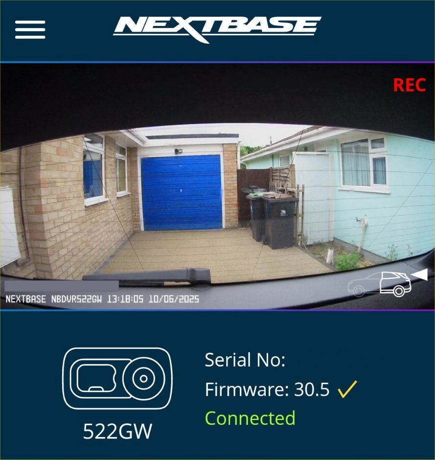

Just finished installing a Nextbase 522GW Dashcam (Front and rear). Pretty straightforward if you also get the OBD power cable aswell. Cables run under the rubbers around the door frames, and will tuck behind the roof lining at the windscreen and hatch seal. Excess power cable will tie up behind the OBD socket, and excess rear camera cable will hide in the roof lining at the hatch opening.
Brilliant adapter made by Dashcams.co.uk fits the rear camera to the hatch/roof lining step instead of the rear window. No faffing about trying to get the cable through the rubber between the hatch and roof. (I got the triple pack of adapters as I wasn't sure which one would give the correct position.
I'd recommend the DC02 (camera view shown below), or possibly the DC01 if you want it a bit lower. The DC03 is too short.

That’s a great tip! I have a two camera setup waiting ready for when the new Elroq arrives and getting through the tailgate on any car is always a PIA…
Do you get any vibrations with the rear camera mounted this way?

Nope - the roof lining is quite sturdy, and holds the adapter firmly. Also the rubber surround is very grippy. The rear camera has a 5mm sticky pad holding it to the adapter which also would damp any vibrations...

Thanks for replying, I gather the VAG grommets are tough to remove and break easily. I will be ordering a DC02 this afternoon 👍

Also note: I couldn't remove the triangular cover behind the mirror over the windscreen sensors, but you can slide it down just enough to get a small gap for the cables.
I've just tested the Dash cam out properly and all is well except that it take ages to download anything to my mobile, if it actually decides to connect and not stall during the transfer.
It seems all Dashcams I've had have had this problem, so I'll keep a spare sdcard in the car to swap with the one in it and view/copy what I need on my PC.

Yeah there seems to be a bit of a knack to getting those covers off. I have seen a few YouTube videos and I’ll see how I get on when the car arrives…
How did easy did you find removing the A pillar covers or didn’t you bother? I would want the cable install to not affect the air bags. I suppose similarly with the B pillar air bags and the seat belt covers?

I didn't remove any covers so as not to maybe disturb the airbags, I just used a credit card + plastic pry tool to prise them up enough to slip the cables underneath the edges. I couldn't get the join in the cover over the rear seatbelt/window to split enough to get the wire in without crushing it, so I just left it exposed for the bit between the seatbelt and the hatch rubber. It's hardly noticeable and doesn't fowl on the seatbelt or parcel shelf.
