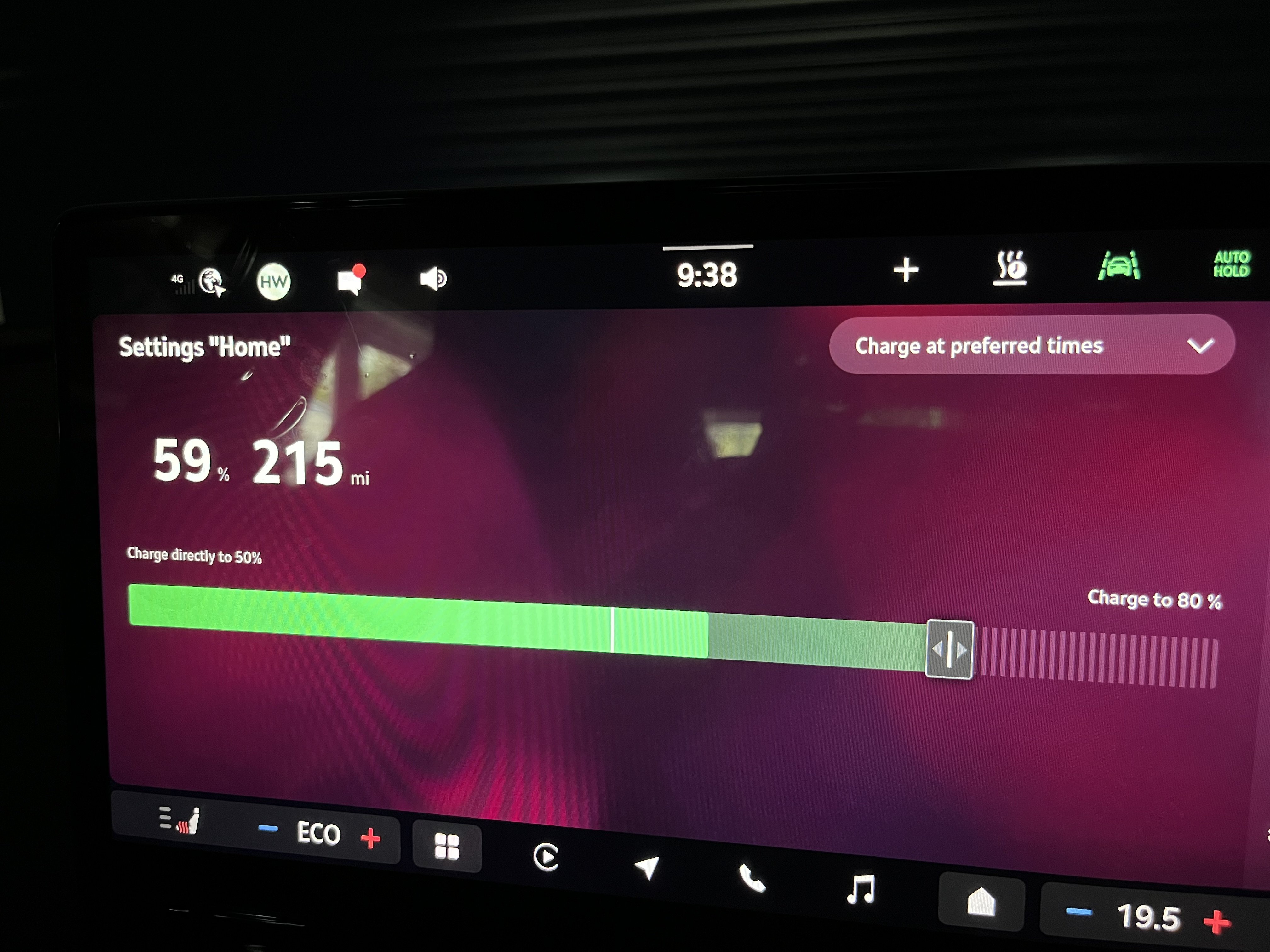

Thanks our screen looks like this
When you set the times in the schedule make sure your target percentage is achievable within the time you set, otherwise it will charge outside those times as well.
Your screen is showing "charge immediately to 50%" so if you car is less than 50% when you plug it in, it will immediately charge. We dropped ours to 20% as we're not likely to go below that.
