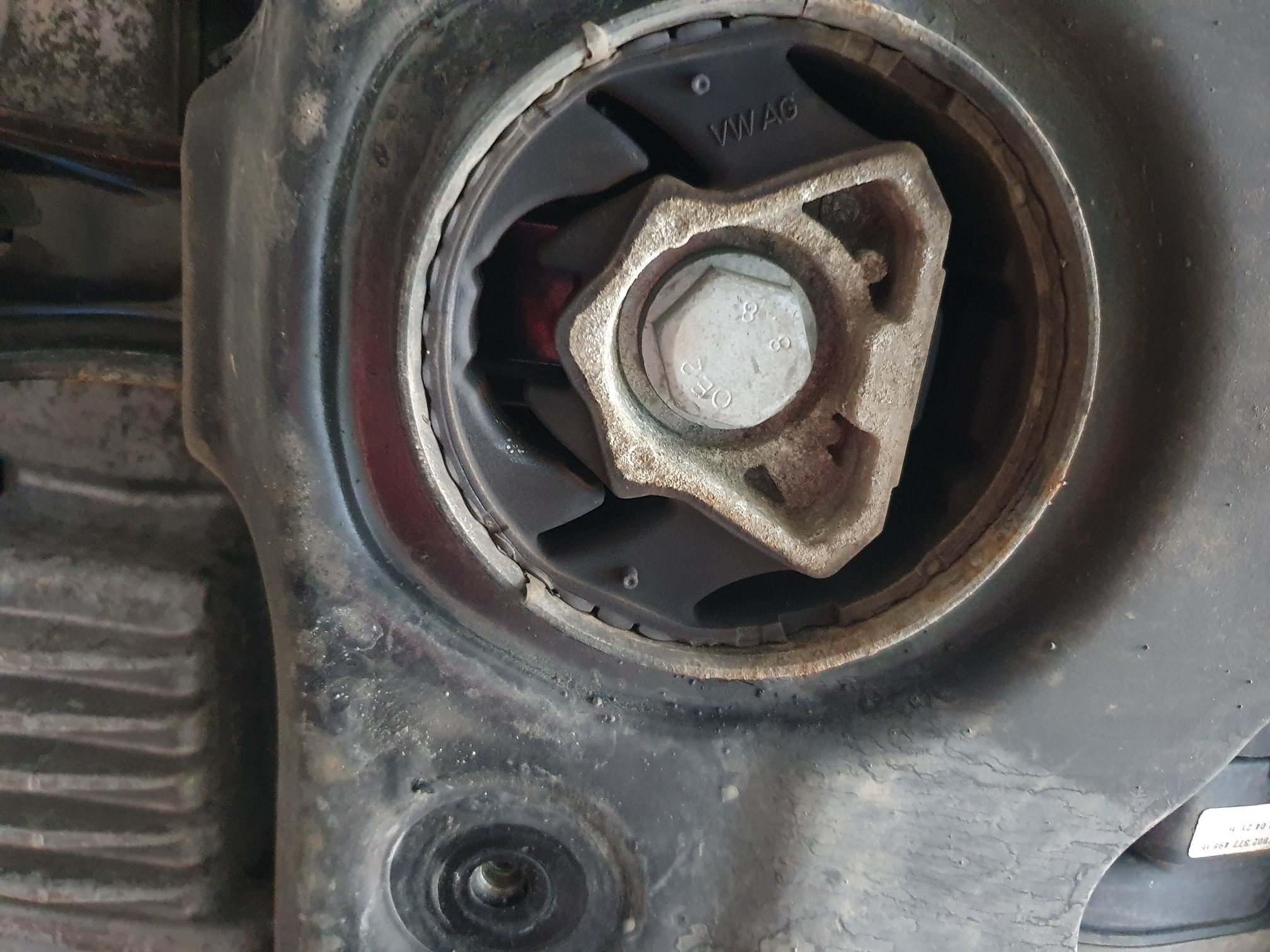

Not sure what the metal is, aluminium maybe? I guess the rubble is what absorbs the load in the main but I’m no engineer.
There is a little tab at the bottom of the triangle, but the bolt head is also recessed because they’ve put more material inside the triangle.
Spoke to the mechanic about getting a new mount so that the insert can fit and he said it’s a lot of time as they’re pressed straight into the subframe. So they drop the subframe down so they can get it in the press. All of a sudden, 3 hours labour becomes an expensive job for the gain.
Its not even worth removing material from the insert because of the build up around the bolt head; you need to end up with a much shallower insert, but then it wouldn’t be flush so the bolt head is not pulling against the mount.

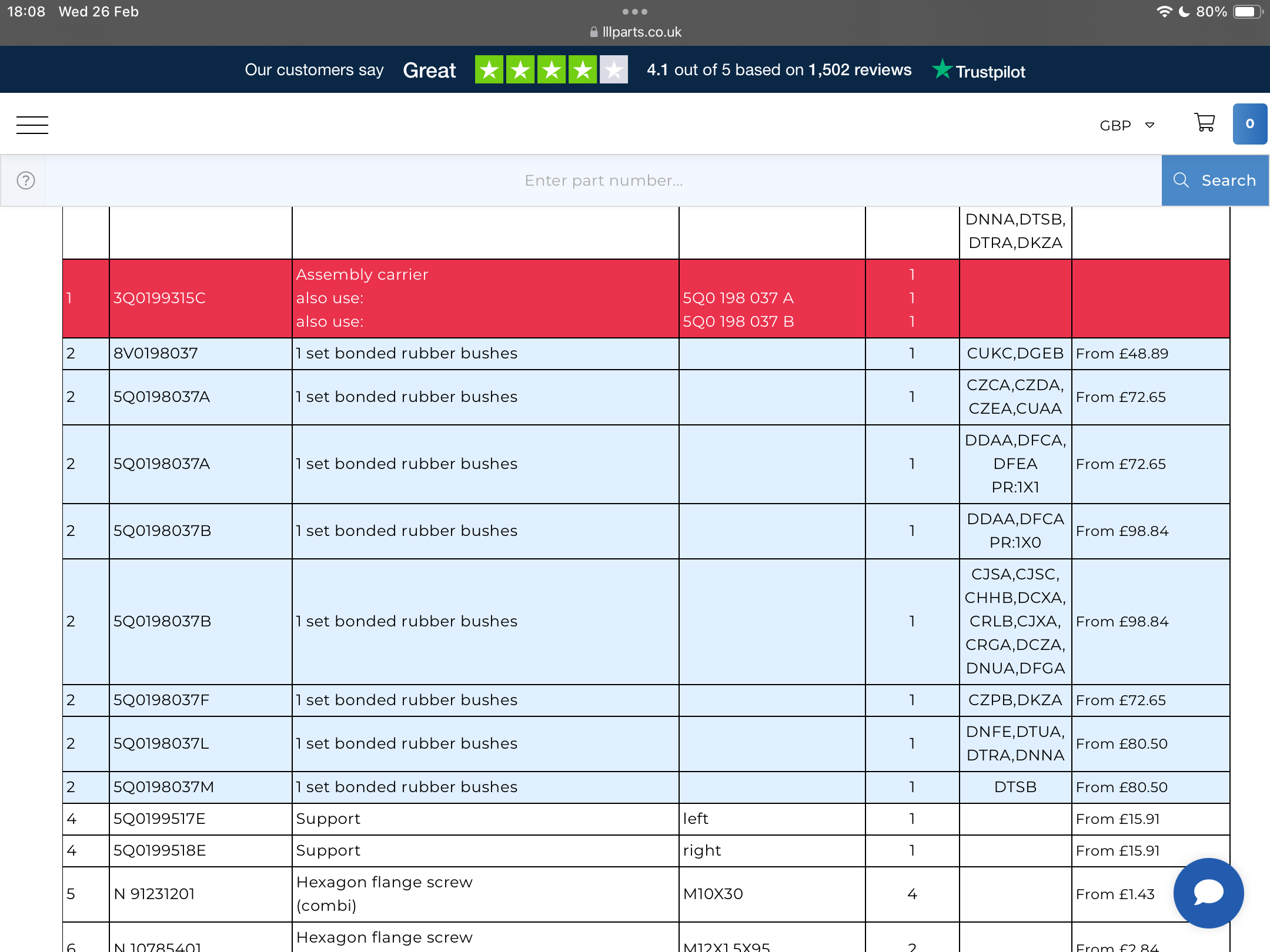

23 hours ago, travs said:
@leolito - you've got the same engine code as me - I think you're going to have the same part as me I think (second to last blue line).
Yeah, actually I follow you faithfully like a little pup, because I know I might get into some of this later! Luckily for me, I am on reduced rations until I free some availability once I sell some stuff ... so for now I am gathering info ☺️

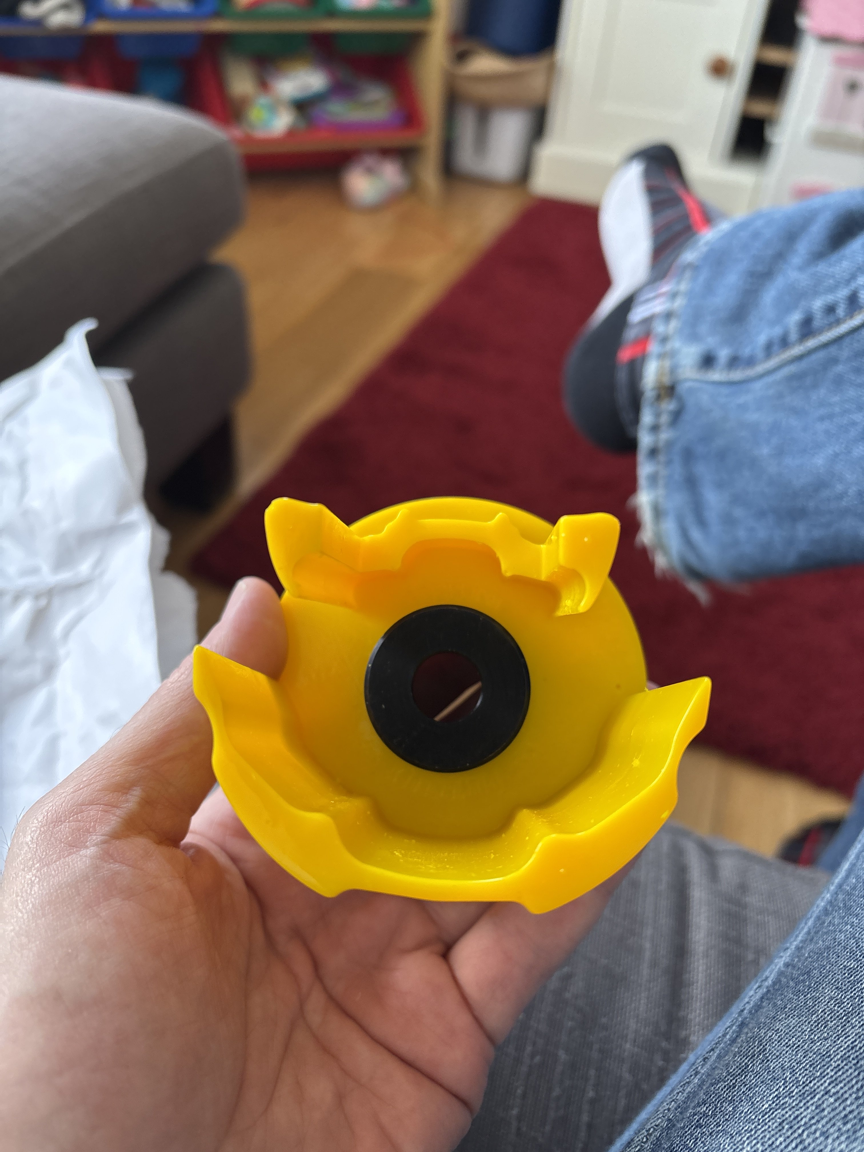

I’ve ordered the powerflex part now so if that does fit, then I’ll confirm and it gives you an option. Which is also half the price of the aluminium version too.
These poly ones come in different colours for different stiffness in order:
red(softest for diesels), yellow(petrol), purple(tuned), black(stiffest for track). I have yellow on order.
Powerflex received. The bottom section should definitely fit in the slot in the mount’s rubber; the top may need to be modified to fit as the cutouts have been altered in the revised mount. But given this thing is pretty soft and rubbery there’s hope it’s robust and adds a bit more firmness.
Lastly, whether the bolt holder fits into the bolt recess now that the inside of the metal isn’t empty is the final challenge/hope. Ramps sourced to have a good look this week!
Edited by travs
And finally put to bed.
Had to cut down the legs to fit it in and noted from a YouTube video to jack it up into the voids in the rubber; but the bolt cap fits and feels pretty good in place so happy with finally sorted.
DNFE owners be warned.
Edited by travs

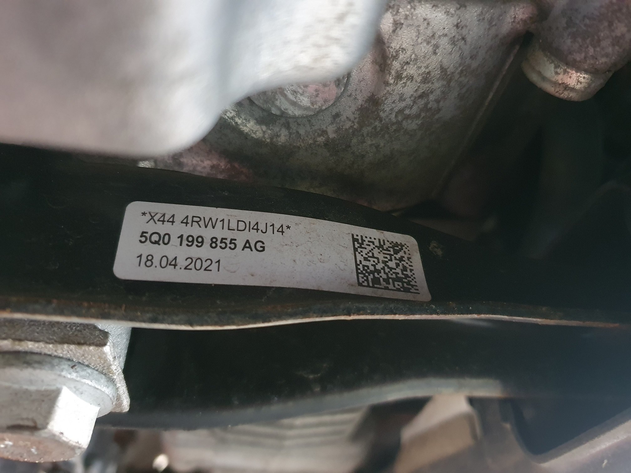

Finally, last week when I changed the oil and pads I remembered to look at the dogbone.
I confirm I have the same "Batman" shaped rubber as travs.
Soon will be shopping time ... should get the bolt as well, probably.
