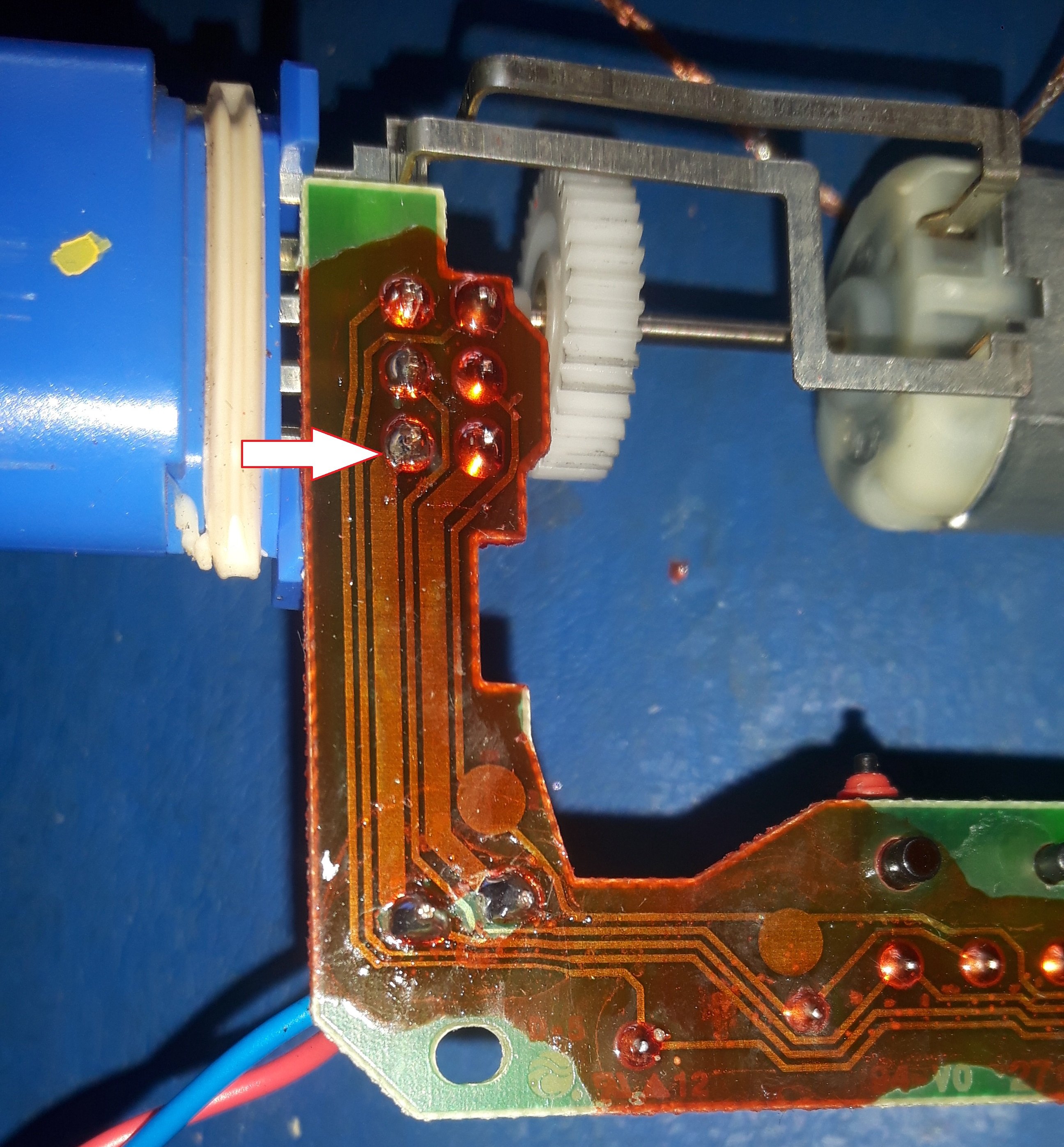

Hi Pete, agreed on the microswitch. I cant find the post I read about the car door locking unit which pointed me towards poor soldering in the unit. What with the interior sensor disable button not lighting orange when pressed and the iffy pattern of flashes of the little red indicator light on the top of the door card somethings amiss. Went to look round the breakers yard for a fabia alarm siren , none present, checked several golfs as well and passats , could not even find the alarm sirens on them ! i was looking under the front panel below the windscreen and also the drivers wheelarch , most odd, i must be lokoing in the wrong place. Anyhow I guess i will have to actually buy one from Aliexpress.

Possibly my pic and vid?

Im not sure Pete, quite possibly , do you have a link please ? I would like to get some more knowledge as re-flowing the soldered joints is something I can do easily enough.

Link to lock microswitch (actually the earth) solder thing:
Locking misbehaviour, another possible cause - Skoda Fabia Mk1 (1999-2007) - BRISKODALocking misbehaviour, another possible cause - Skoda Fabia Mk1 (1999-2007) - BRISKODA
The lock repaired in that thread remains in service, fault free nearly five years on.
