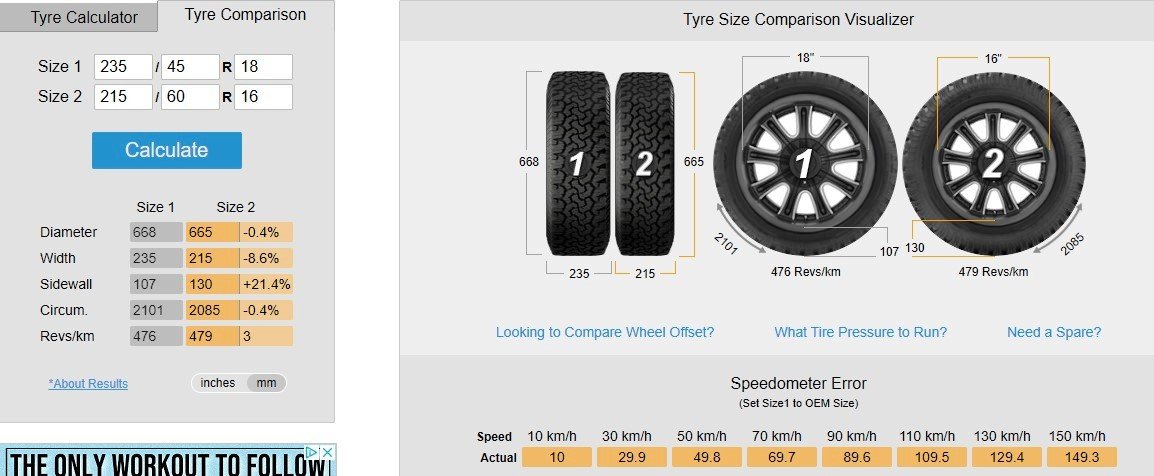

If the internet info I got is correct - always check, double-check and cross reference any information you get from any source internet / sellers / manufactures even, note I haven't check this - here are some pictorials to give you some idea.
The list I looked at show two different size wheels in 18" - 8.5" wide ET 41 and 8" wide ET 41 I've gone with 8" as just an uneducated guess, your wheels will have the size on them, probably on the inside face where you can't see them unless you take the wheel off the car.
So 8"wide 18" (ET 44) wheel with bloody silly 235/45ZR18 94W tyres (could be worse could be 19" wheels) against 16" 6.5" (ET 41) wide wheels with say 215/60R16 tyres.
HTH.
Info from these sites. -
https://www.wheel-size.com/size/skoda/
https://tiresize.com/tyre-size-calculator/
https://www.willtheyfit.com/
ETA: 16" tyres give over 20% more sidewall than those bloody silly 18" if all the info is correct.
