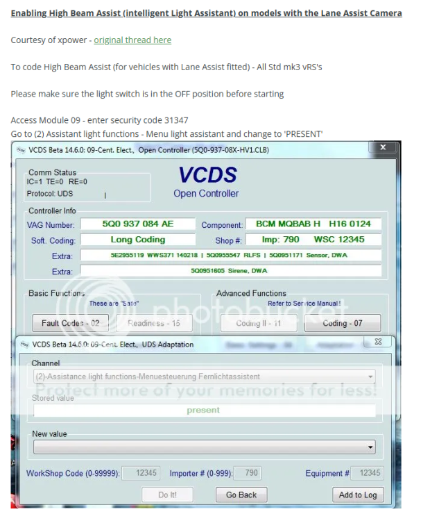

I have a 2019 Octavia III vRS, which has Lane Assist (as I believe they all do), and therefore a camera which theoretically means I can activate auto high beam and traffic sign recognition.
I have been into the list of verified adaptions/coding and tried to do both of those things, however have hit a brick wall.
Problem 1 - High Beam Assist
The channels seem to no longer be as simple as 1, 2, 3, etc., so when I get into adaptation channels, I get a list as long as your arm with things like:
  • IDE08786-ENG142228-Assistance light functions-Masikerung_Regenfunktion
  • IDE08786-ENG141985-Assistance light functions-Regen_Lichtsensor
and so on and I don't know what any of it means. Am I missing some sort of setting to change the channel list to something I understand?

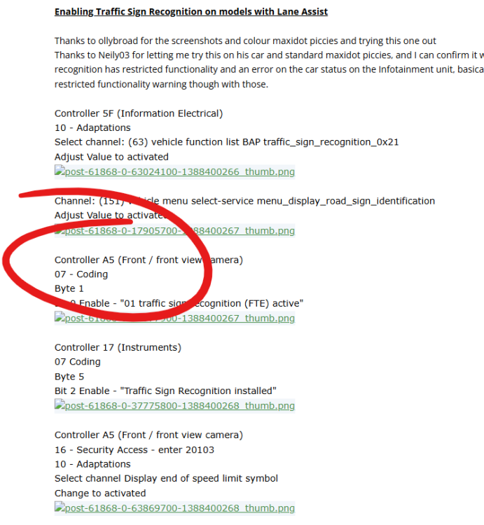

I have also gone through the instructions to enable traffic sign recognition - again, car has Lane Assist and an MIB Amundsen
Same problem with adaption channels - there is nothing that I would identify as "Channel 63"
Problem #3 - I don't have Controller A5 for the front/front view camera as a selectable option.
Did something happen in MY19 or 20 that changed the way the coding works?

However I have since found updated instructions which show the correct channels to look for on facelifted cars, so I am going to try again later.
