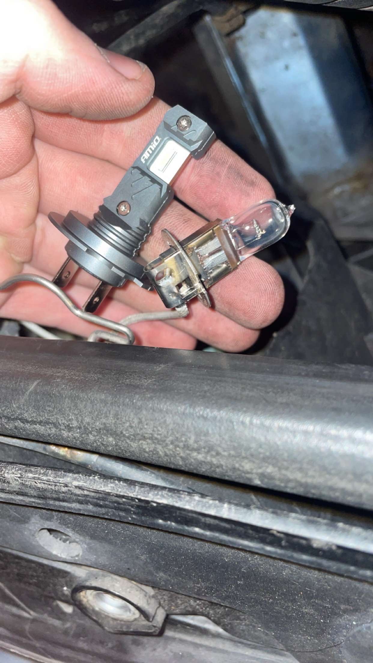

Hi lads, so i bought leds (h7 and h3) for my fogs, dippeds, and full beams.
My dipped beams plugged right in perfectly. But my fogs and full beams seem to be different, 1 prong, wired in.
Could i just strip the wire back and wrap it around the two prongs or do i need to get a different kind of bulb.
Lad in the bulb shop said something about it being a UK import, so it may be different.
Well, the LED unit in your photograph is an H1, H4 or H7 (not sure which). The halogen is an H3, as distinguished by having one bayonet and one wire attached to the bulb. I think you have at least some wrong LEDs.
i have h3s as well, does the bulb just come out and i stick in the h3?
Physically yes, they'll be plug and play. I do not guarantee that the LEDs have the correct focus and/or will not activate bulb failure detectors.
Hopefully not. I got canbus bulbs for that reason. I’ll try pull out those old bulbs and see if i can get h3 in
There seems to be wires inside the bulb holding it back
