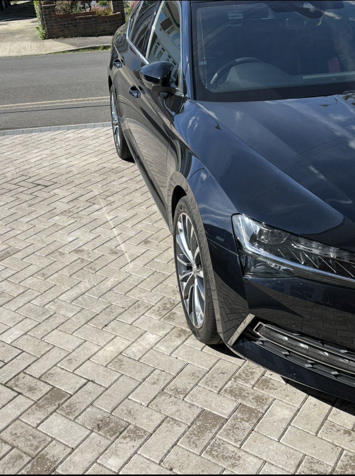

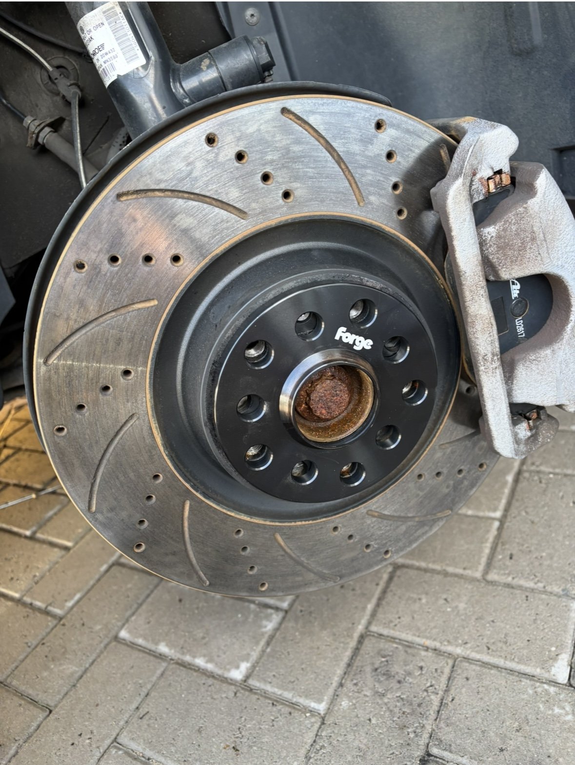

@travs Would you be able to share a photo of how your wheels look in the arches with your 11m spacers fitted? I'm just wondering if I might want to go with 15mm or more. 11mm on the face of it, doesn't seem all that much, and I don't want to get into an expensive 'trial and error' approach.
Here you go. Stupidly I didn’t take a before pic from the same angle but that’s with the spacers. And with the spacers placed on the hub

Smashing stuff @travs , thank you! 😀 Are you happy with the 11mm, or would you go bigger ideally?
For me it’s fine. The standard stance was always too thin for me but I’ve always held off spacers because of the potential negative if done badly/wrongly. So this size is a decent enough compromise. I couldn’t see myself going wider.
Got it, thank you for following up. What potential pitfalls should I be wary of? I will likely opted for the same spacers as you.

If you're able to change a wheel and get some 57.1mm (VAG CB) spacers, I don't see why you'd have an issue - it's virtually the same process as refitting a wheel normally. Issues only arise when you're messing around attempting to centre spacers and the wheel.

Apologies - by VAG CB I was meaning VW Audi Group centre bore. In other words, the exact hub spacing of 57.1mm. By using hub centric spacers you're absolutely fine, however I just wanted to mention it, as a surprising number of people don't use them.

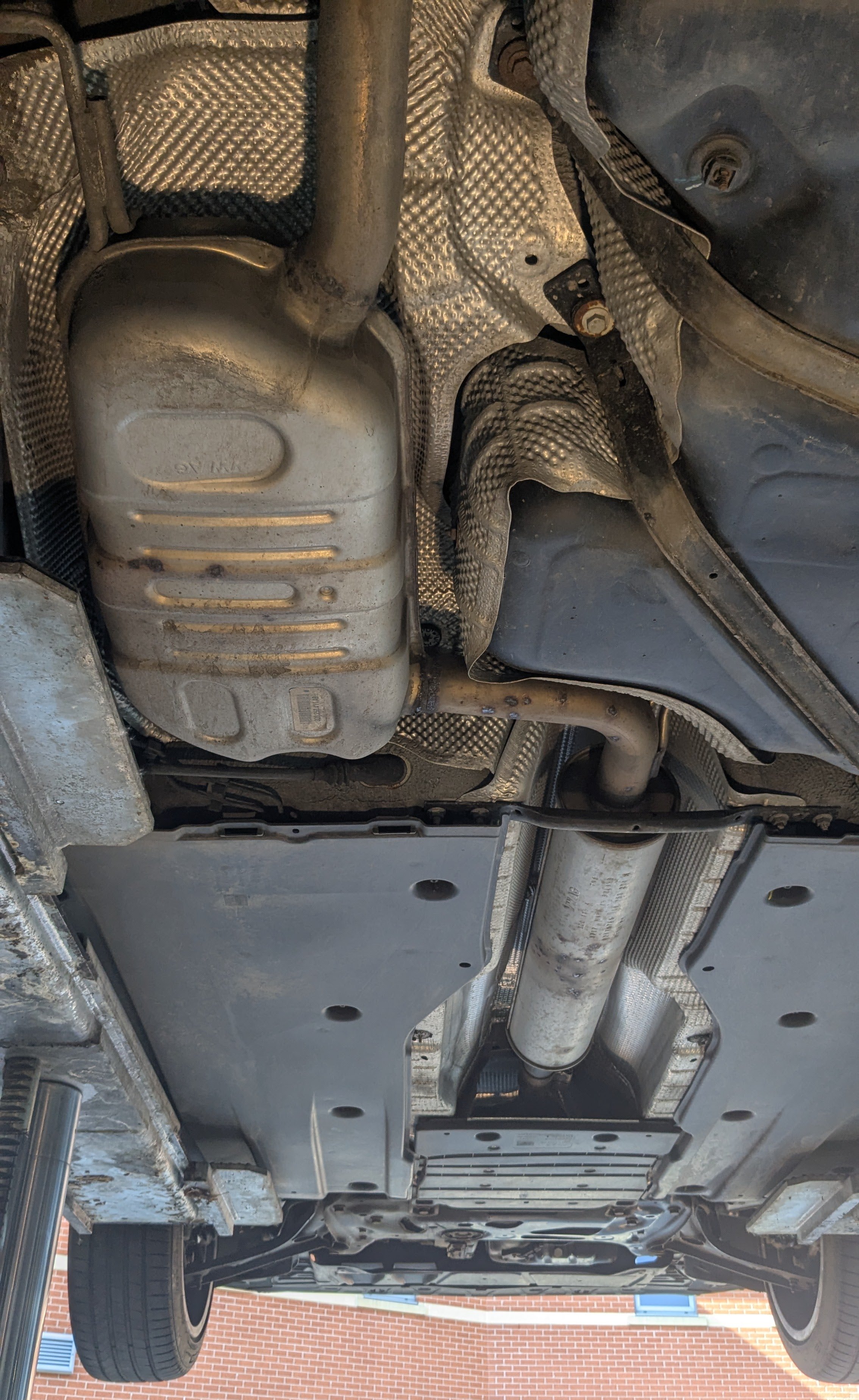

Anyway, got it, no to a backbox delete. Backbone to the resonator question. I have attached a photo; I'm stupid (if you hadn't already twigged), so bear with. Is the rectangular box at the top, the resonator? What is the long cylinder in the middle? None of the VAG photos I've come across feature this section - it seems I have two 'bits' between the cat and backbox, whereas others have just one.
I am really struggling to find any 'off-the-shelf' res delete with anti-drone (presumably the extra j-pipe section tacked on) for my vehicle, they're all for larger engine sizes or different models etc. All my quotes are coming back at ~ £200 fitted, and are just straight pipes 👎

@netman82 Unless I'm being a fool, the box part (further back) is the back box and the cylinder shape is the resonator.
