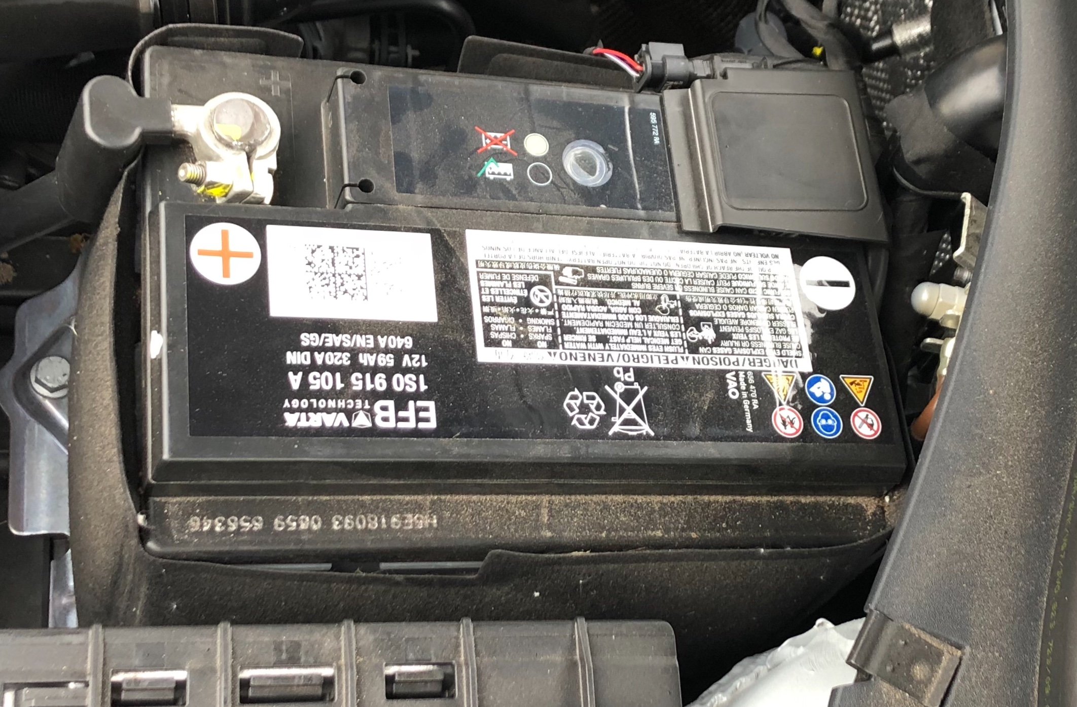

I had a 2019 Superb 3 (company car) which came with a Varta battery.
I’ve just found a photo of it.

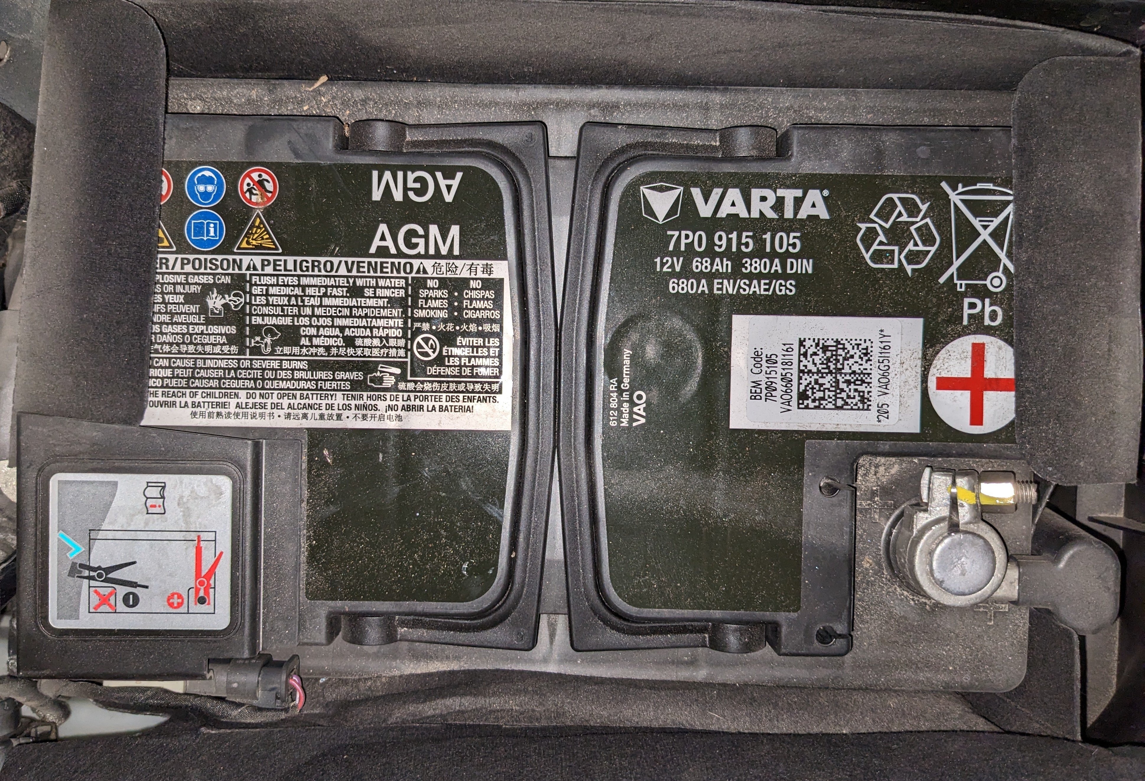

Edit: I've just checked the Octavia and that has a Varta AGM fitted, which has the appearance of OEM fitment, rather than aftermarket.  I don't know if it's original, as I've only had the car a matter of weeks.
Can I check the serial number with OBDeleven?
Edited by daveo138

There is usually a date stamp into the top face of the negative terminal, format is WWYY. Stamp matching production year would indicate battery is probably original.

I've just checked the negative terminal and it's stamped 05-15, so end of January.  The car was registered on 3rd March 15, so it would appear to be original.
I will give it a charge tomorrow, as it isn't being used much at the moment.  In fact it hasn't been used much since the last owner traded it in last August.  The battery seems to be holding up well, as the start-stop seems to work whenever I forget to turn it off 😀

@daveo138 Just a note, yours is actually EFB - not AGM. Still not doing too badly at 10 years old though.
Edited by Warrior193
added information

The EFB was in the old Superb.
The 10 year old battery is AGM.
Probably wasn’t clear from my original post, but I knew what I meant 😁

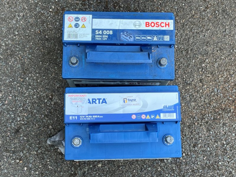

I was looking at the Varta battery as thats whats on the car but the bosch is the equivalent and I have read up they are made in the same factory and the Varta is more expensive on both sites.

Good point about Varta and Bosch.
When I had a Rover 75, I replaced the Bosch battery with a Varta from Tayna. As you can see from the photo, the casings are identical.
