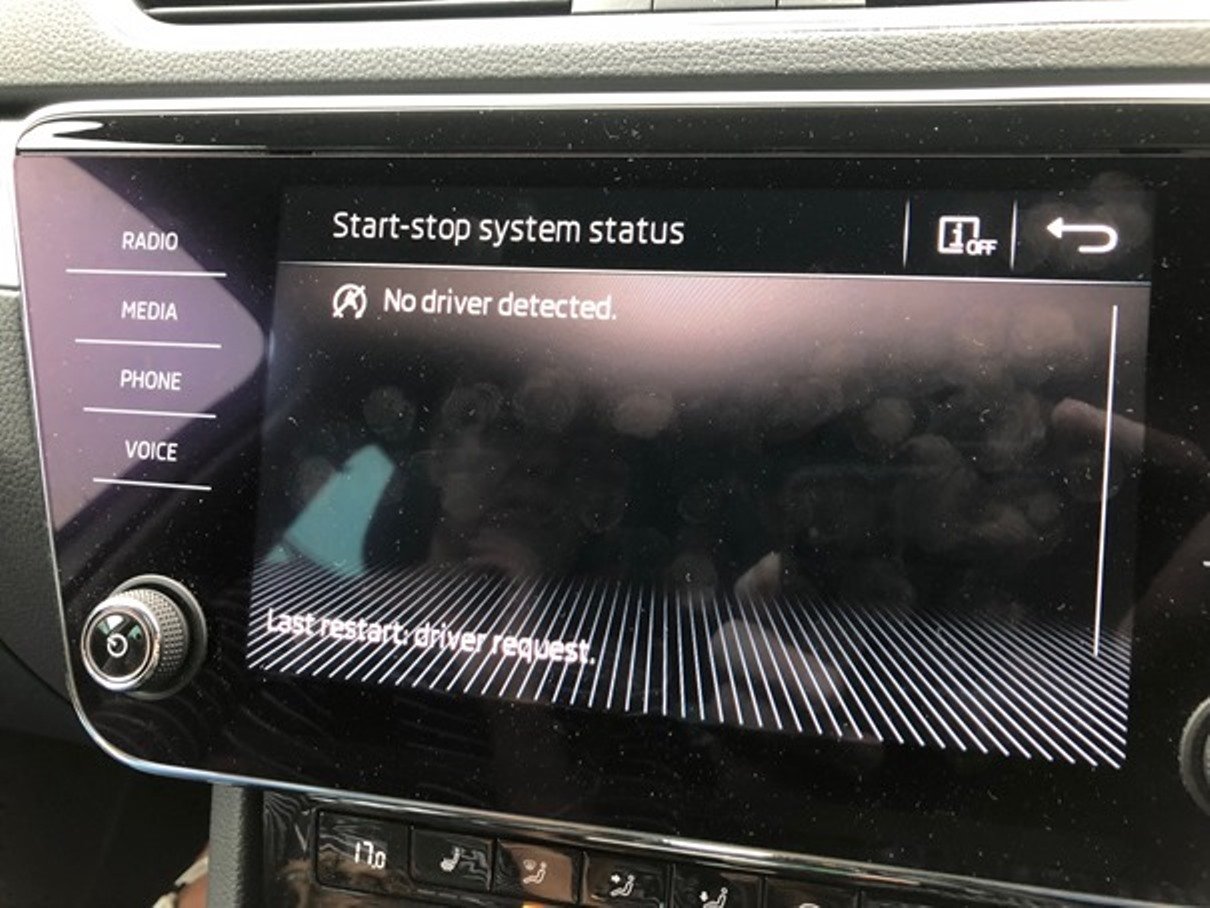

I'm after some help as I have recently bought the car and stop start isn't working, so from my previous car was a vauxhall astra and had the same fault and it turned out the battery wasn't holding enough charge.
I have checked the voltage at the battery on the Octavia and its really high at a standing of 22 volts and when the engine is idling its even higher at 26 volts surely this cant be right?
The battery is a Varta AGM 68ah which I have checked is a stop start battery so the correct one is fitted.
The main display also shows that there is the a high power consumption so the stop start wont engage.
I'm not too worried about the stop start not working but the high battery voltages at idle and running is very concerning but this is my first Skoda so I'm not sure on how they run voltage wise but my previous Astra the battery was around 12 to 13 volts at rest and about 14 to 15 volts when running.
Any help would be greatly appreciate as I dont wont to ruin the battery or alternator or this could be how they run but it doesn't seem right to me.
Thanks in advance to anyone that can help put my mind at rest or can advise if it is a fault on how to retifify it.

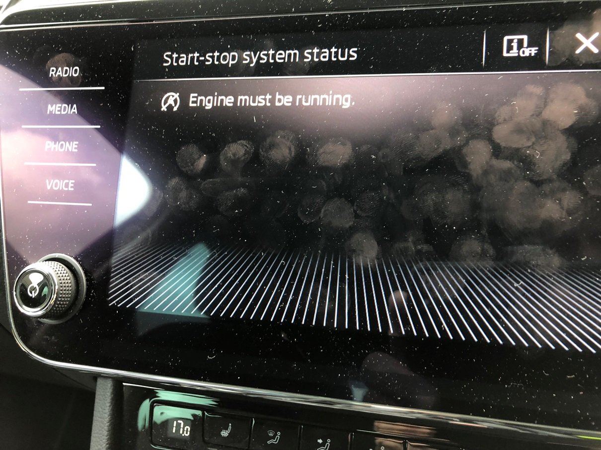

Has anyone any ideas to why the stop start doesn't work still as the battery has a good charge and the main display always states says there is high power consumption?
This is without any air con, heater or demistors on everything high drawing is turned off, it occasionaly says that the engine needs to be running which at the time it was but that is intermittenly displaying on the main display.

Your ECU is reporting a high drain, which in turn will not allow stopstart to operate. The tedious part of the analysis is now identifying which part of the car is responsible - is the heated windscreen really off when you switch it off, for example? A scan may or may not help here. Good luck
Varta is not an OE supplier so the battery has been changed, when it was changed was the car's battery management system recoded?
Do you have any obvious extra electrical devices such as a dash cam, cool box, etc.?
Failing that something is not turning off when it should, and the best way to get more clues is a fault code scan with e.g. VCDS or OBDeleven.

I have tested the battery on cranking and on the first start the multimeter went down to 7.94 volts and then once started the battery was being charged at 14.79 volts so hopefully the alternator is working fine.
The second start the voltage went down to 9.6 volts and I checked the voltage between the positive terminal and the earth and it was close to the running voltage between the battery negative and positive so the earthing for the battery seems fine.
The stop start hasn't worked since I have had the car which has only been about a fortnight, I have been on a few longs runs aswell and its made no difference.
There's no other electrical bits connected up on the car, I have no way of checking if the battery has been coded or how old it is though.
It looks like the battery is on the way out, the astra that I had before in the end was getting harder to start and eventually gave out and wouldn't start at all. Is it the same with the octavia's so if I just keep an eye on it until it gets worse as its starting fine at the moment or is it likely to cause more problems?
There's a lot more electronics on this car compared to the astra and there similiar ages but I suspose the Skoda as it's Volkswagon running gear is more advanced, which also means possibly more to go wrong.
Is there any preference to the OBDeleven or the VCDS programming? As I'm not sure on which to buy but would like to change the battery myself to save some money on the garage fees and also change some of the bulbs to led's which I have read up will cause error codes.
Thanks again for all the replys, they have been a big help
Assuming the meter used is accurate, dropping to below 8.0 volts on start is a confirmation your battery is failing, very likely a decent battery test meter will show high internal resistance along with seriously reduced capacity.
If replacing battery, ensure the new one is correctly adapted (coded) into the vehicles BCM - either OBD (with necessary functions) or VCDS will be able to do adaptation.
