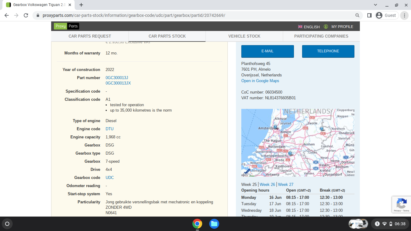

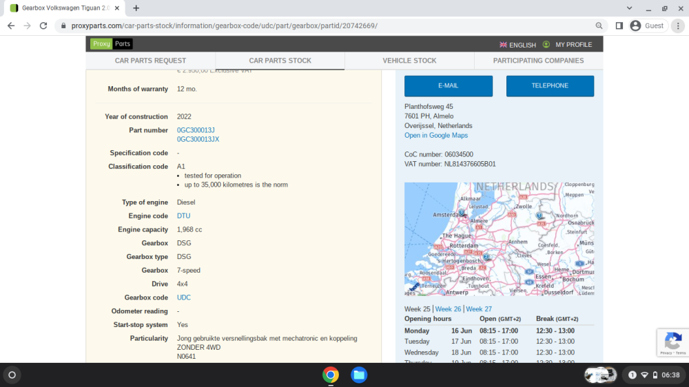

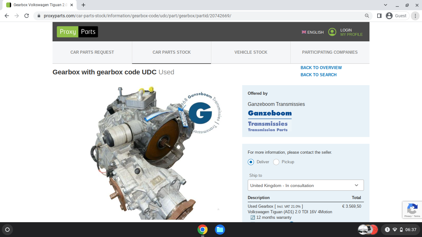

@Bap33 Sorry i really do not know for certain and can not check as my mate that is the gearbox specialist is on his holidays. But a UDC is a DQ381 as far as i believe.
Edited by Ootohere
Hi @Ootohere,
My engine code is DTUA. According to your screen shots, it could be a DQ381 actually. Thanks!

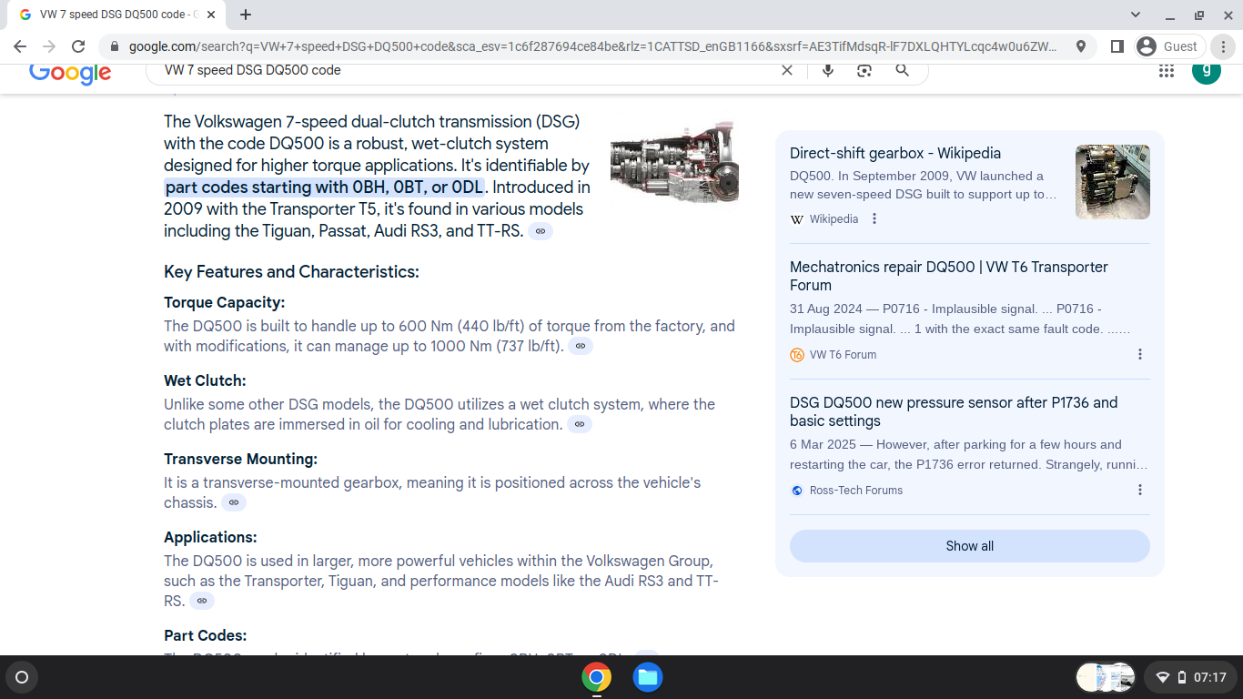

AI
so still learning and it even takes into account stuff on here even if we are wrong.
