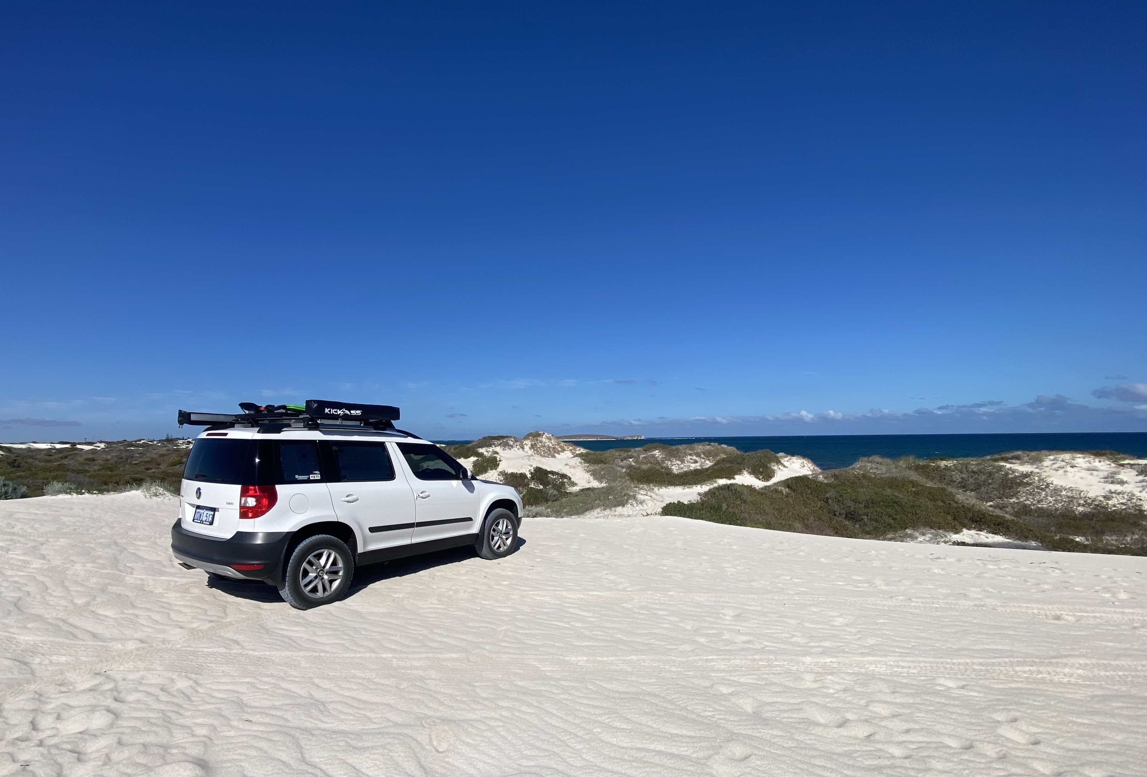

Hi Scott and Alana
Just wanna let you know that I have been following your videos on the Yeti after watching what Darkside has done to theirs. I can’t seem to find many articles or videos outside yours and Darkside that has done mods to the Yeti. Looks like we might be the minority.
Quick Intro - I’m from Perth in Western Australia. I have owned the Yeti since 2017 and have slowly added several accessories and mods to it over the years. I’ve used it as a daily and for my camping and fishing trips. It’s got -
  • DIY roof rack carrying recovery tracks, 100w solar panel, side awning, shower awning, camp table and just recently, a uhf antenna
  • Removed driver side passenger seat and mounted a 30litre fridge
  • 30mm lift kit
  • 16” Tiguan ET33 wheels with 215 65 Kuhmo AT52s.
I recently tested the bigger tyres and lift kit in the sand dunes in Lancelin and it didn’t get bogged this time, finally! Being able to reduce tyre pressures to 15psi without worrying that the rims are going to touch the ground is a game changer.
Happy to share more photos and ideas’
Hi @Chua 👋. I love hearing from other owners that have modified their Yeti. Hopefully a few more Yeti or just fellow VAG owners in general will come out of the woodwork with their off-road or overlanding cars so we can all share ideas with things that work or things that just really don't work 😄. Your car looks great and I'm always going to be jealous of your near white sandy beaches you have over there 😎. Although I hear that the corrugated roads are not too enjoyable 🙈😁. Have you got any pictures of the side awning and shower awning setup? Alana's idea is to slowly turn our Yeti into something overland spec over time 😀.
