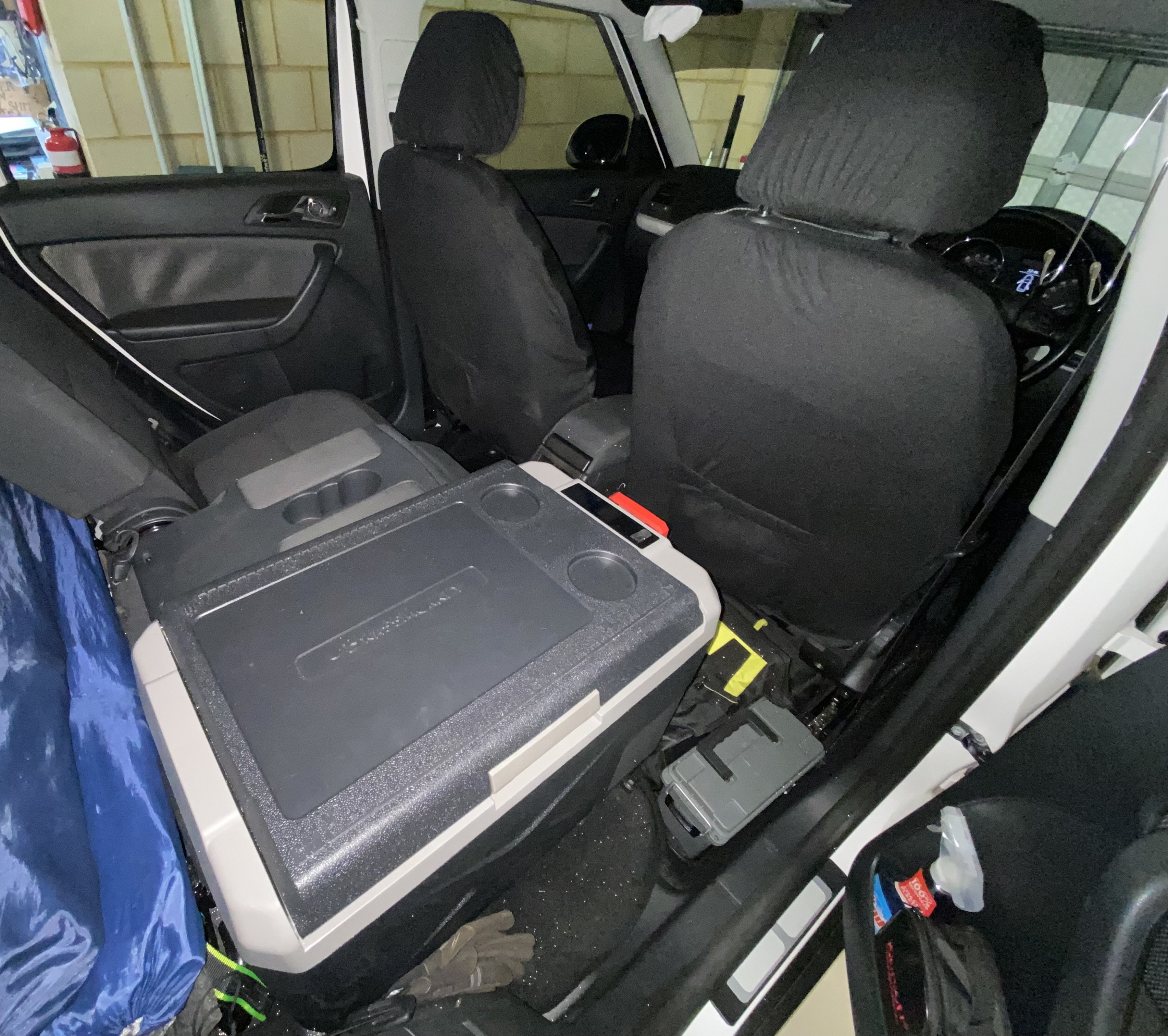

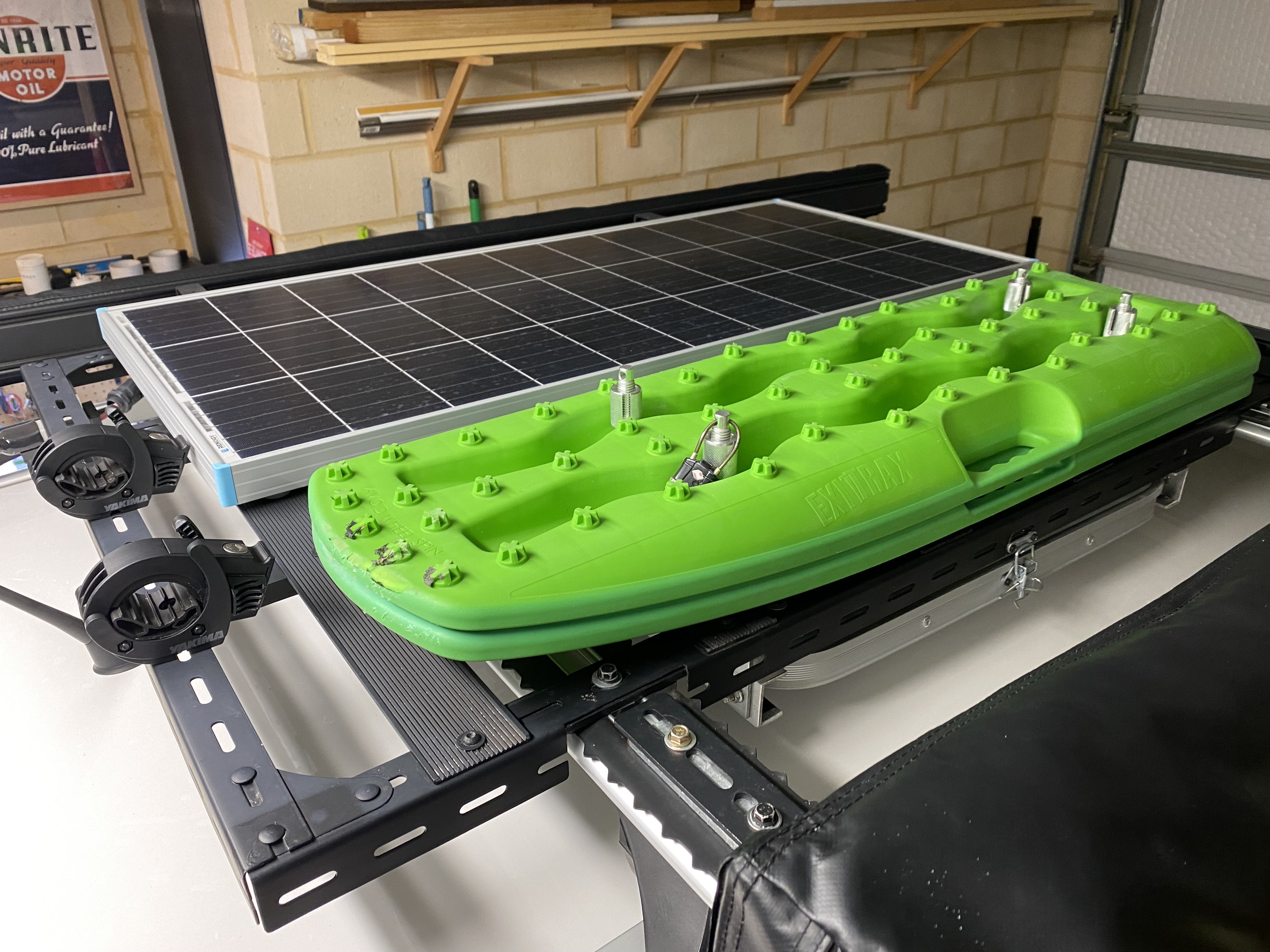

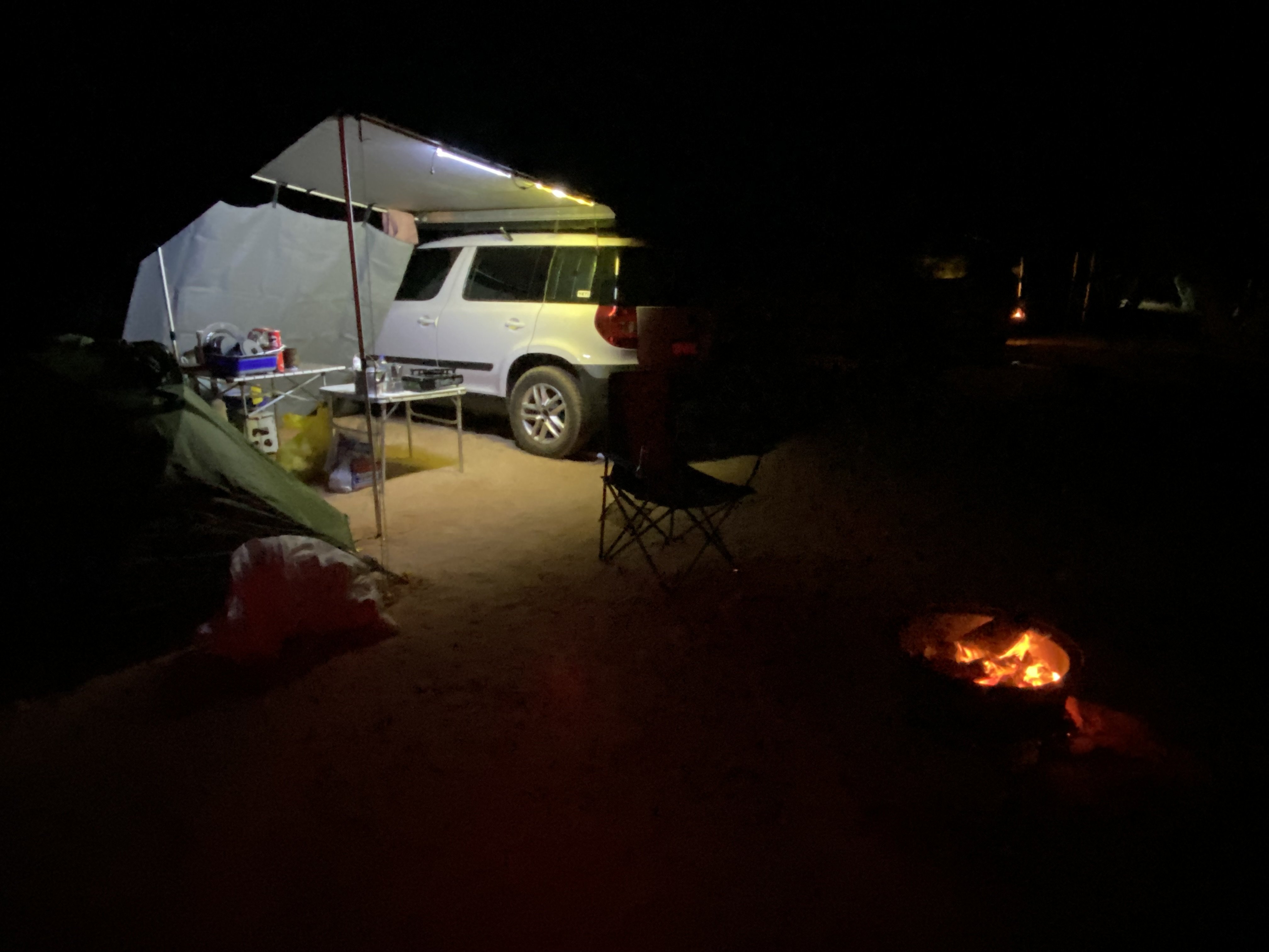

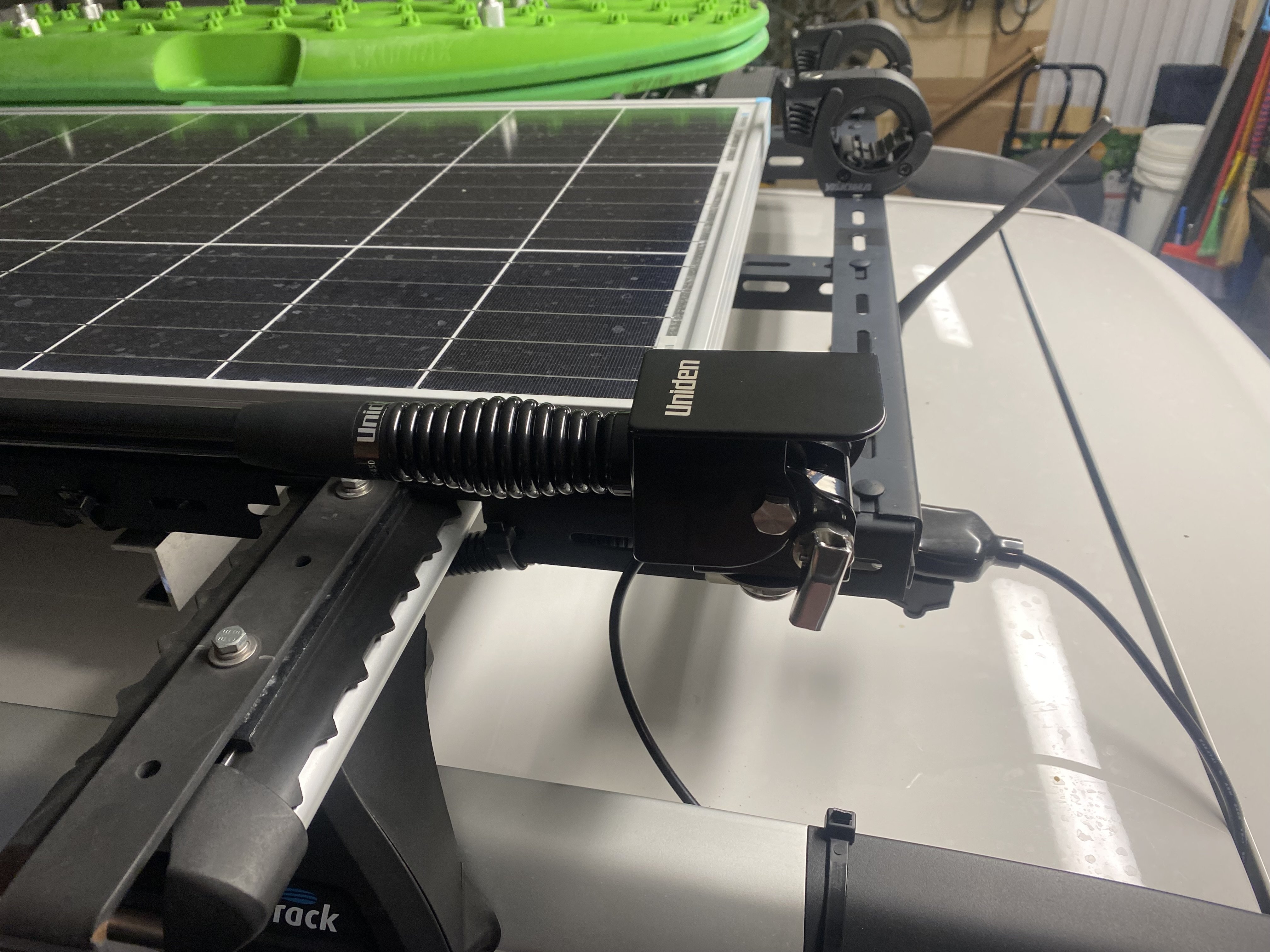

Hi @Chua 👋. I love hearing from other owners that have modified their Yeti. Hopefully a few more Yeti or just fellow VAG owners in general will come out of the woodwork with their off-road or overlanding cars so we can all share ideas with things that work or things that just really don't work 😄. Your car looks great and I'm always going to be jealous of your near white sandy beaches you have over there 😎. Although I hear that the corrugated roads are not too enjoyable 🙈😁. Have you got any pictures of the side awning and shower awning setup? Alana's idea is to slowly turn our Yeti into something overland spec over time 😀.
So far driving around WA. I’ve not come across many corrugated bitumen roads. Some dirt roads yes but rarely tarmac.
I’ll take more pictures of the setup over the weekend when I get back home. IMG_1814.jpegIMG_1815.jpegIMG_1865.jpeg

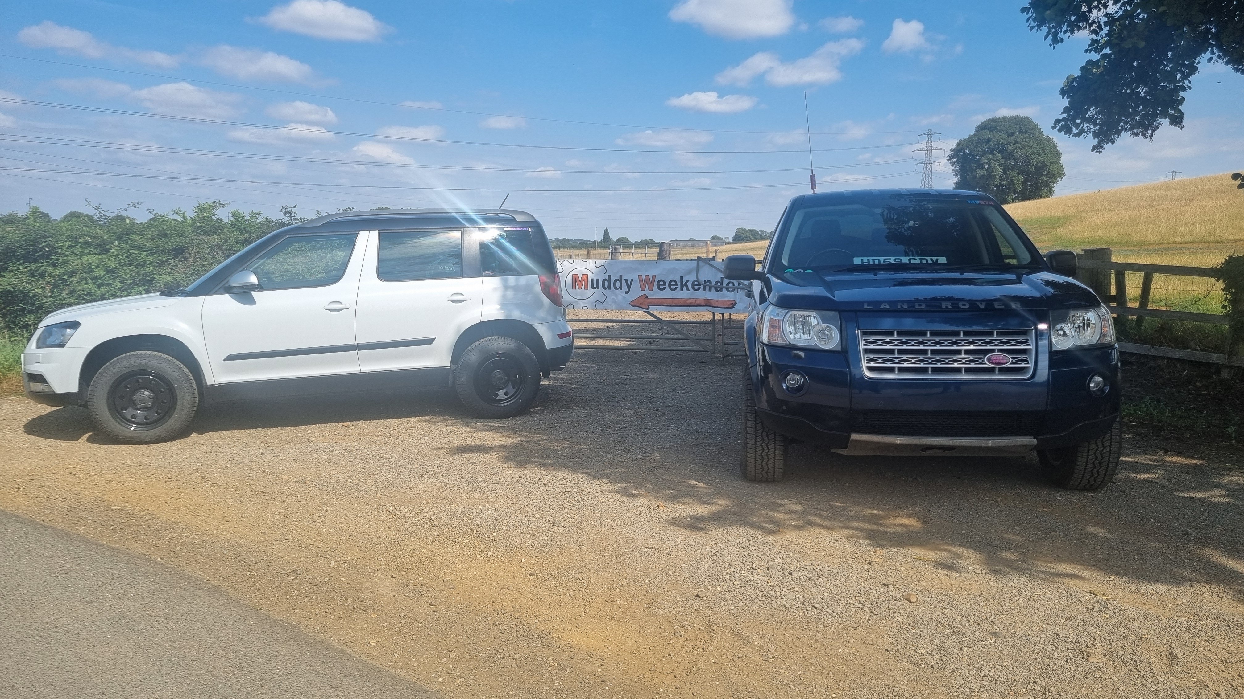

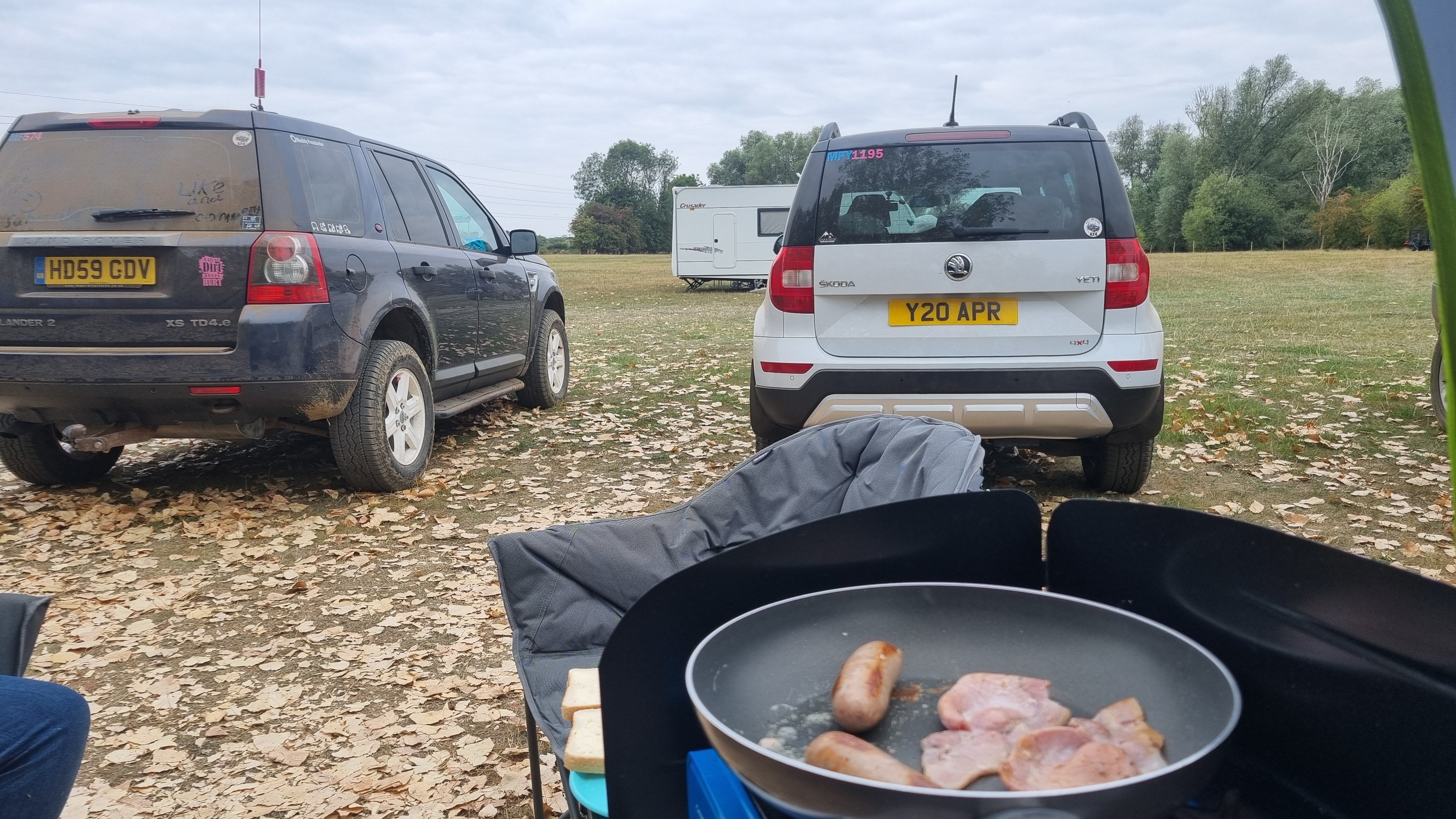

Between Alana and myself, we are part of a Facebook group called the Muddy Freelander Group. The group is run by a company called MuddyMods that specialise in Freelander parts and modifications. Each year they put on an annual event called Muddy Weekender for anyone and everyone on the group to meetup.
Not only that, MuddyMods hire exclusive use of both of Billings off road courses to use for the weekend. For anyone that has been to the Billing off road show, it's that place and those courses 😁.
Seeing as we don't live too far away from the event, we took both the Freelander along and also the Yeti. We were super lucky that on the Friday, Chell and Warren from MuddyMods let us tag along as they setup the course on the Friday evening ready for the weekends action.

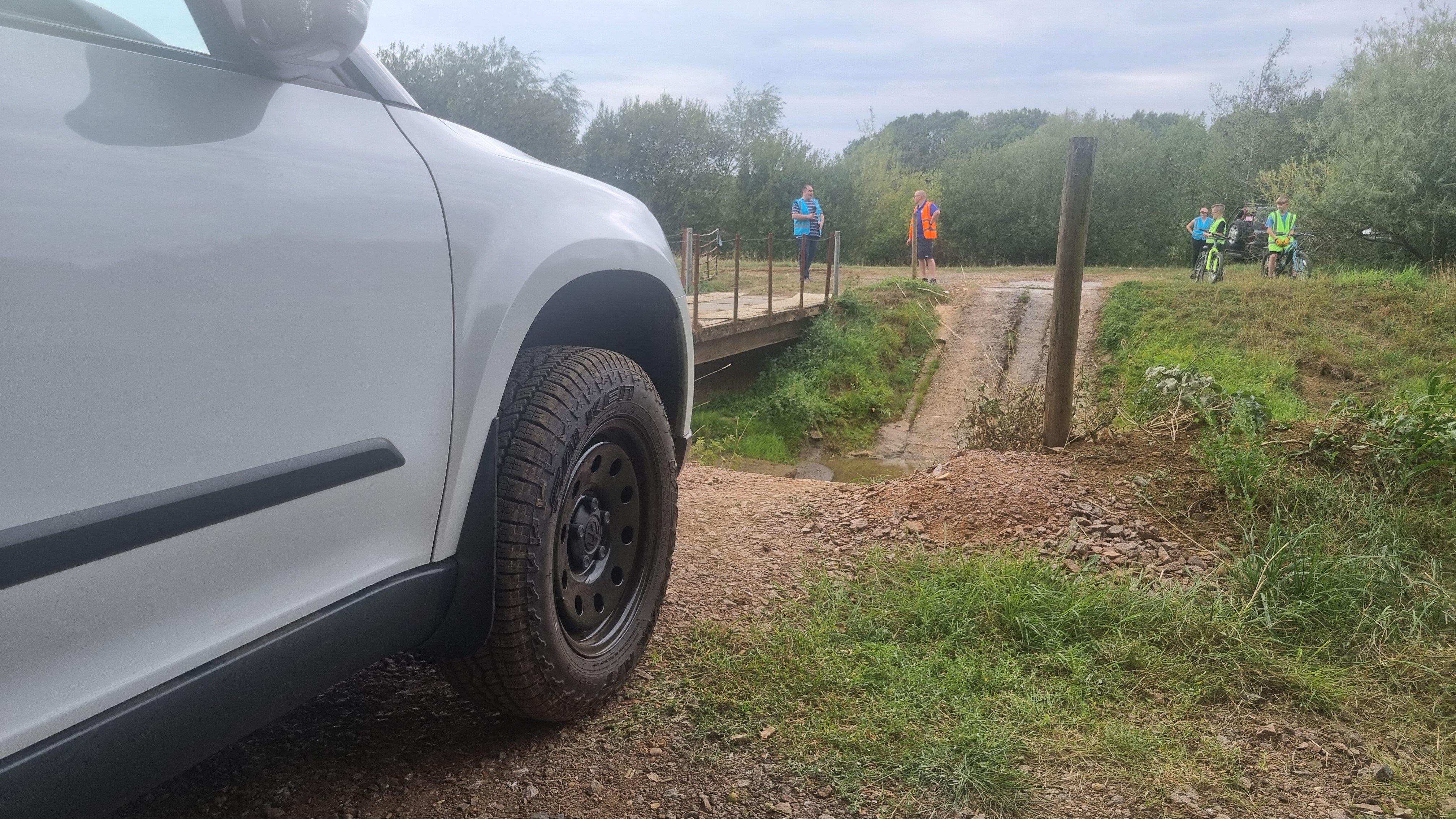

Alana's grown very fond of the Yeti and the course overall is a bit much for our Yeti in its current form. That didn't stop us having a little go at 1 or 2 bits of the course as we went around 😁.

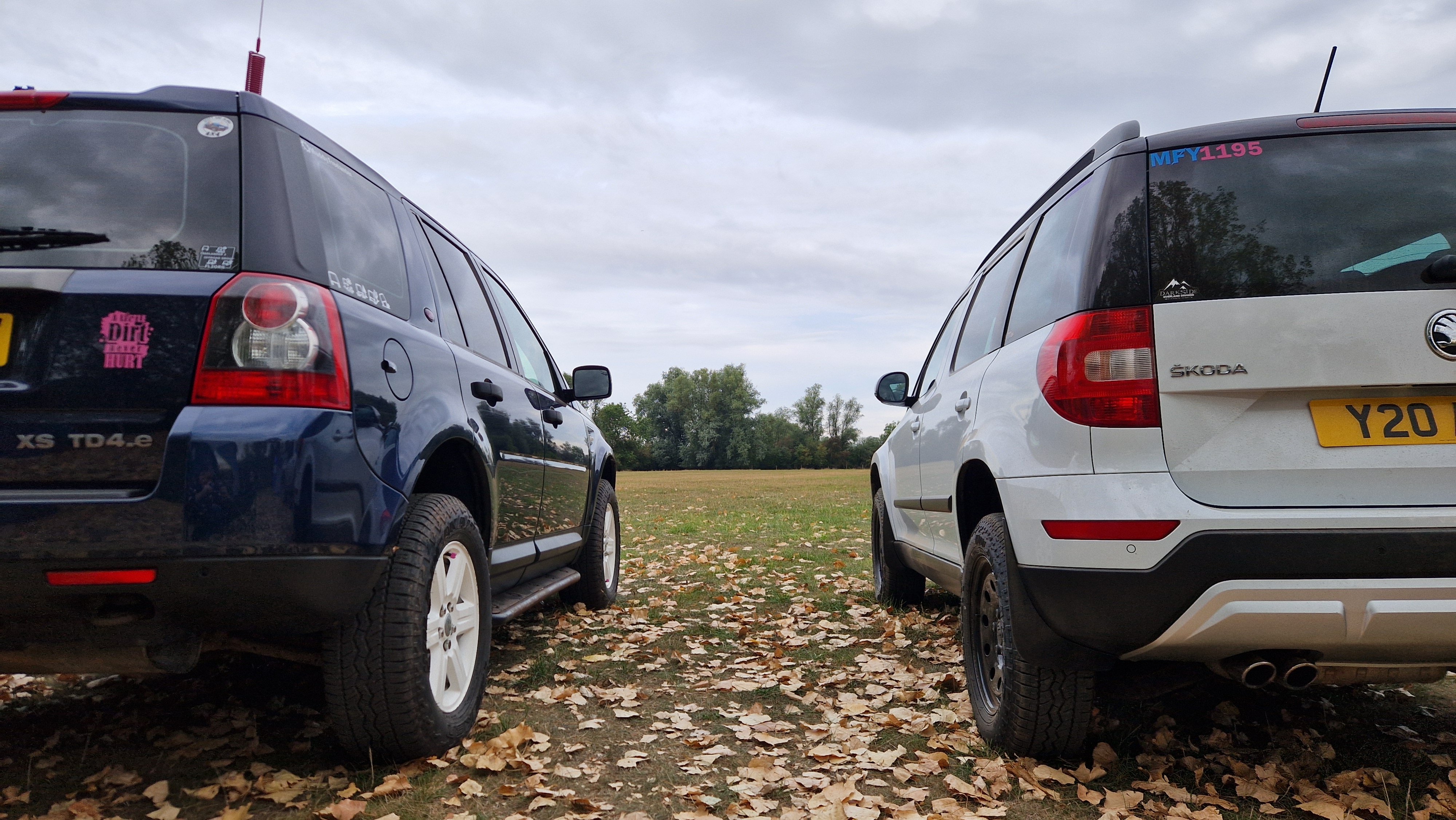

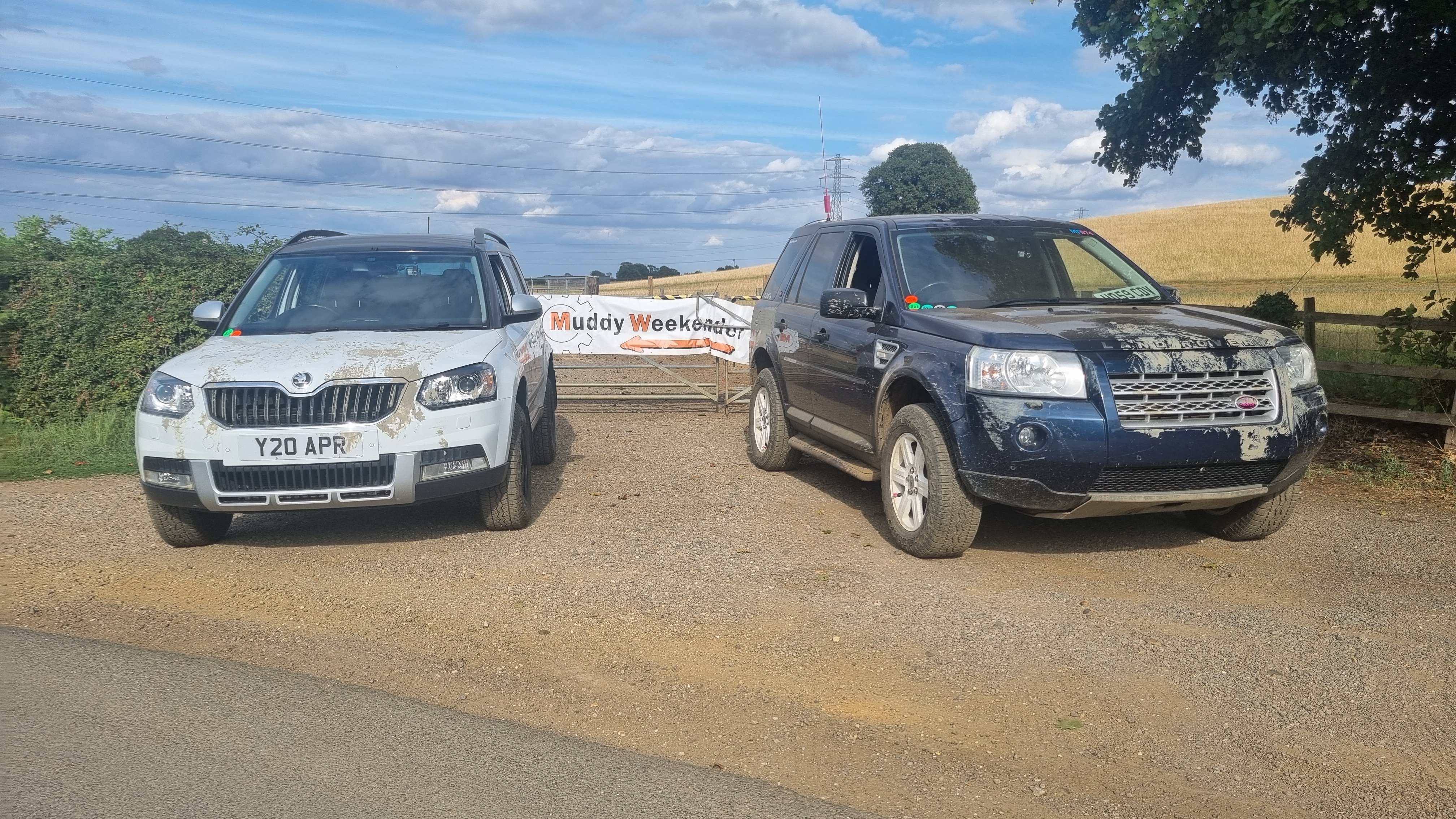

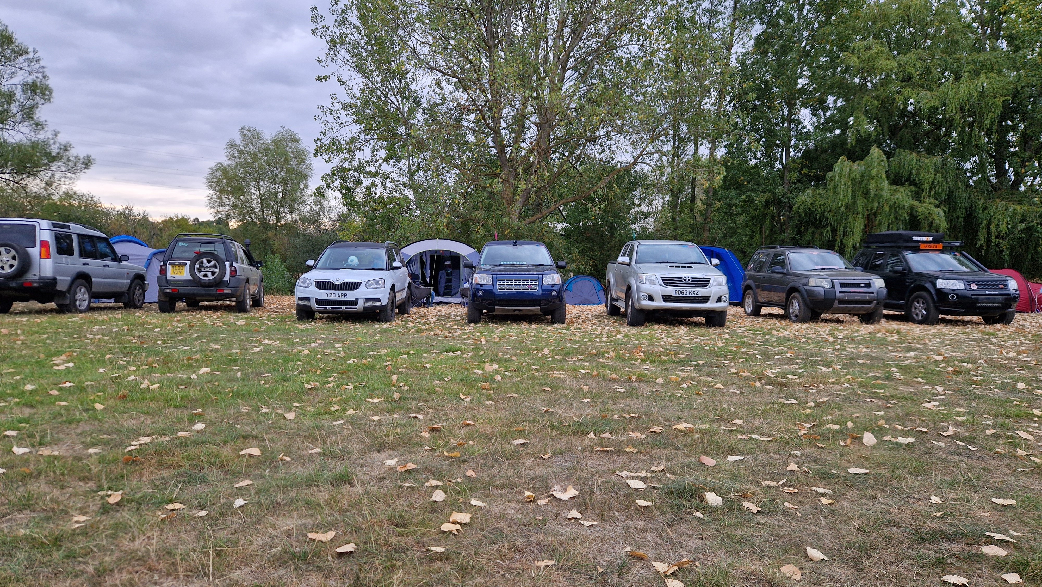

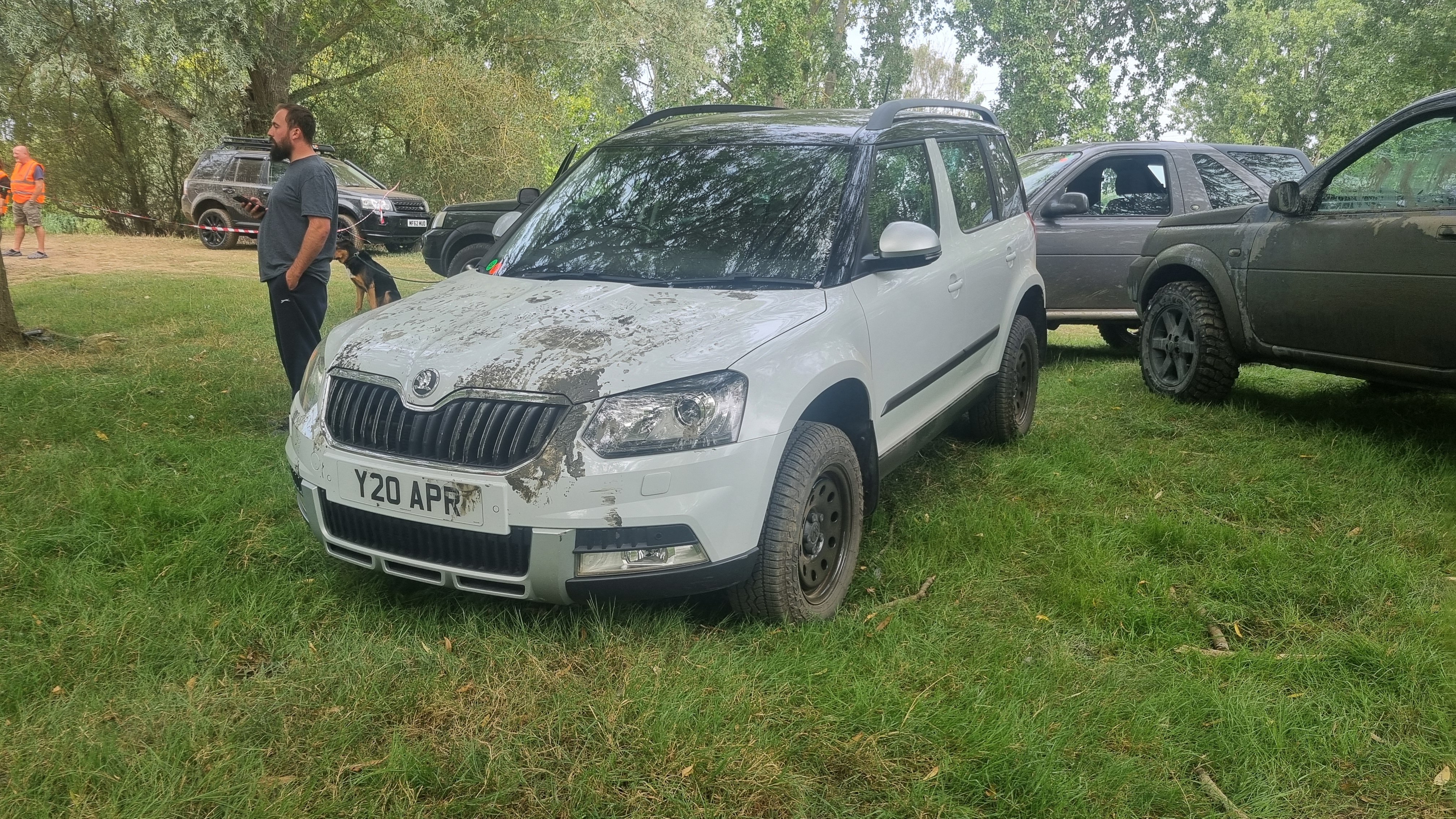

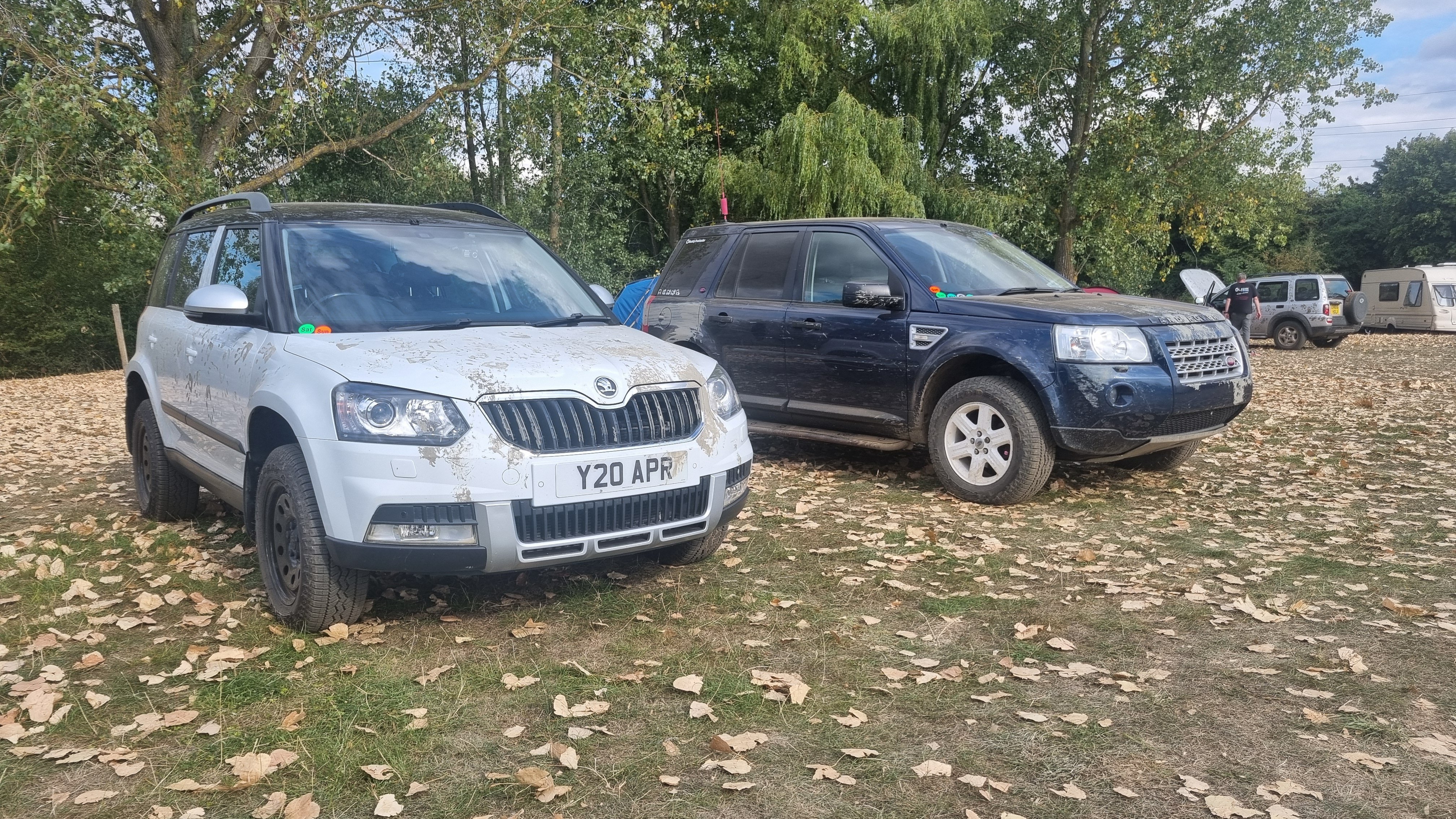

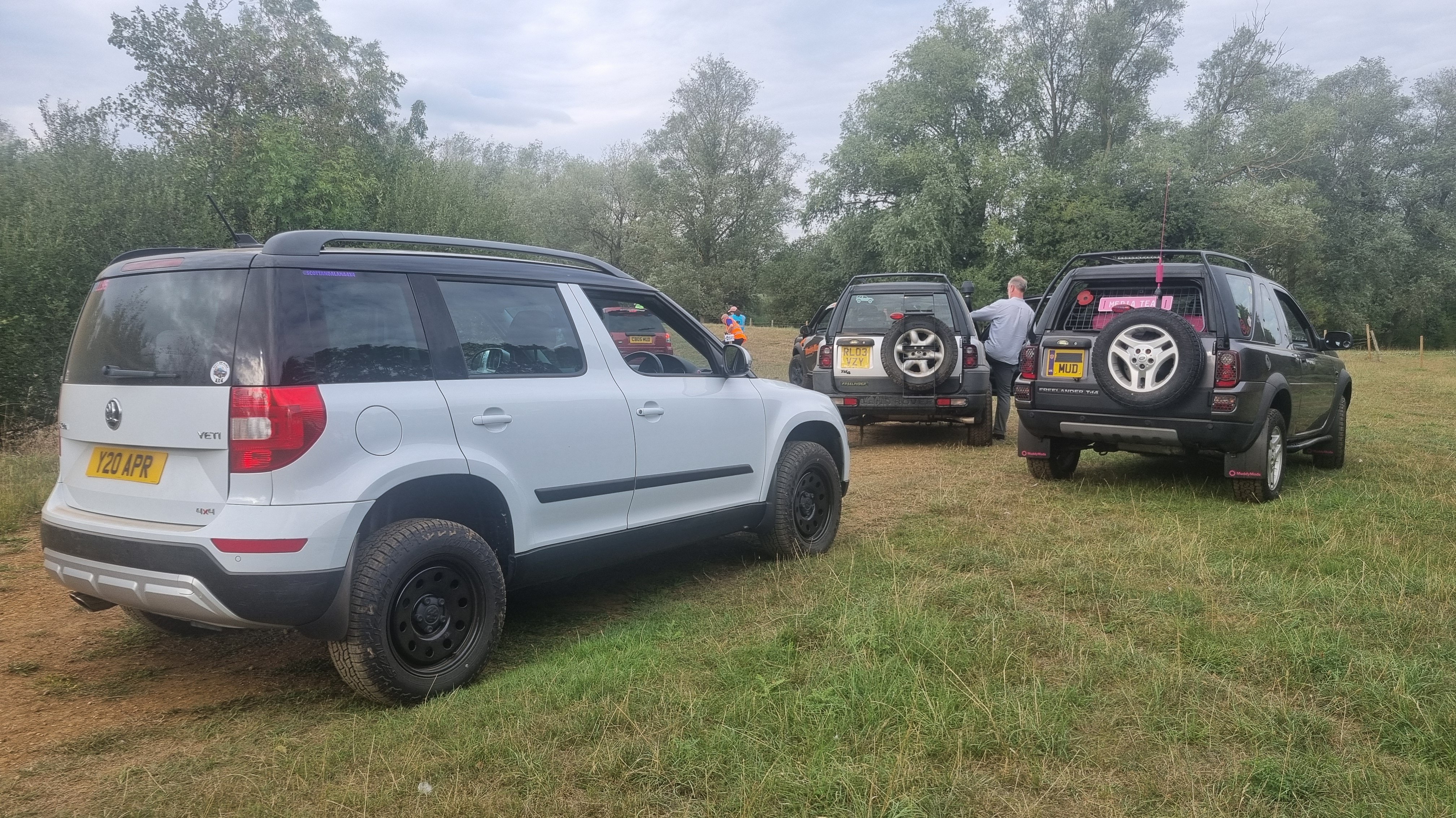

A few pictures from our weekend...
If you squint a little, our Yeti almost fits in 😁.

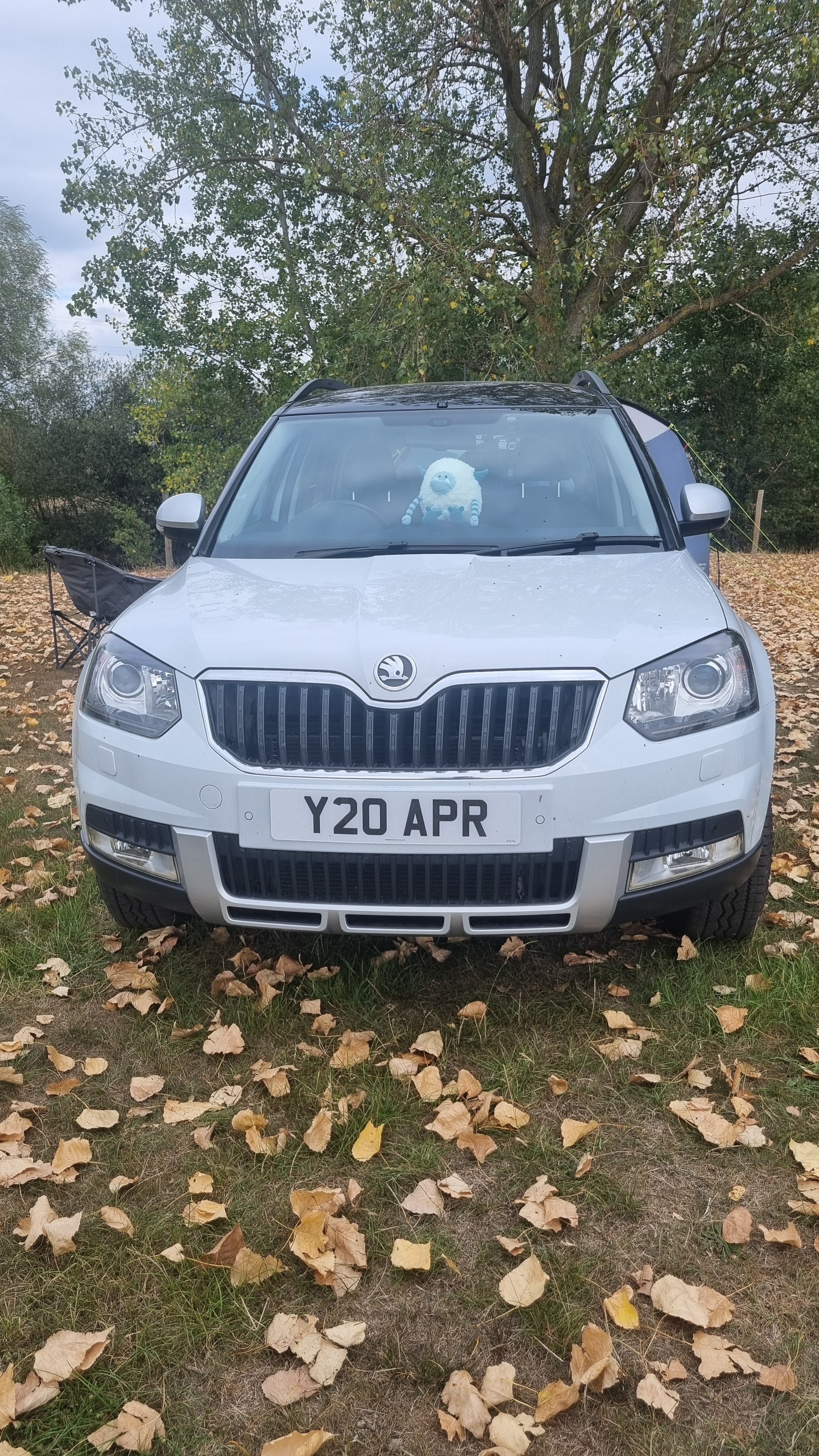

Yeti chilling out in the Yeti 😊.

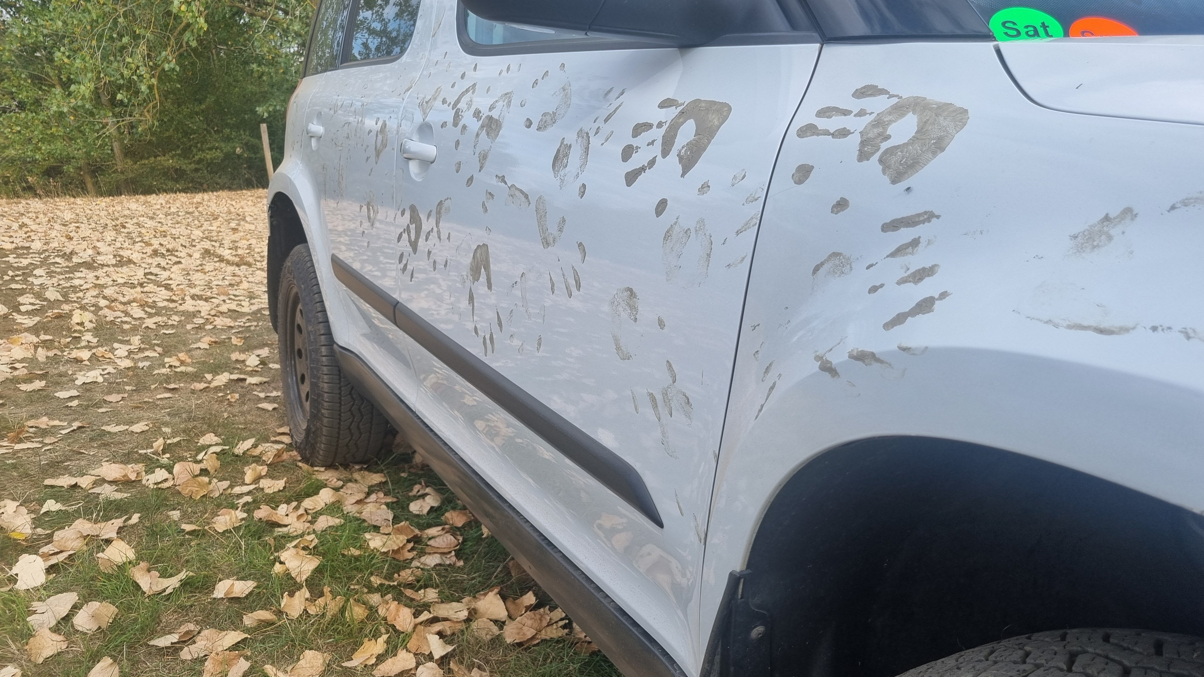

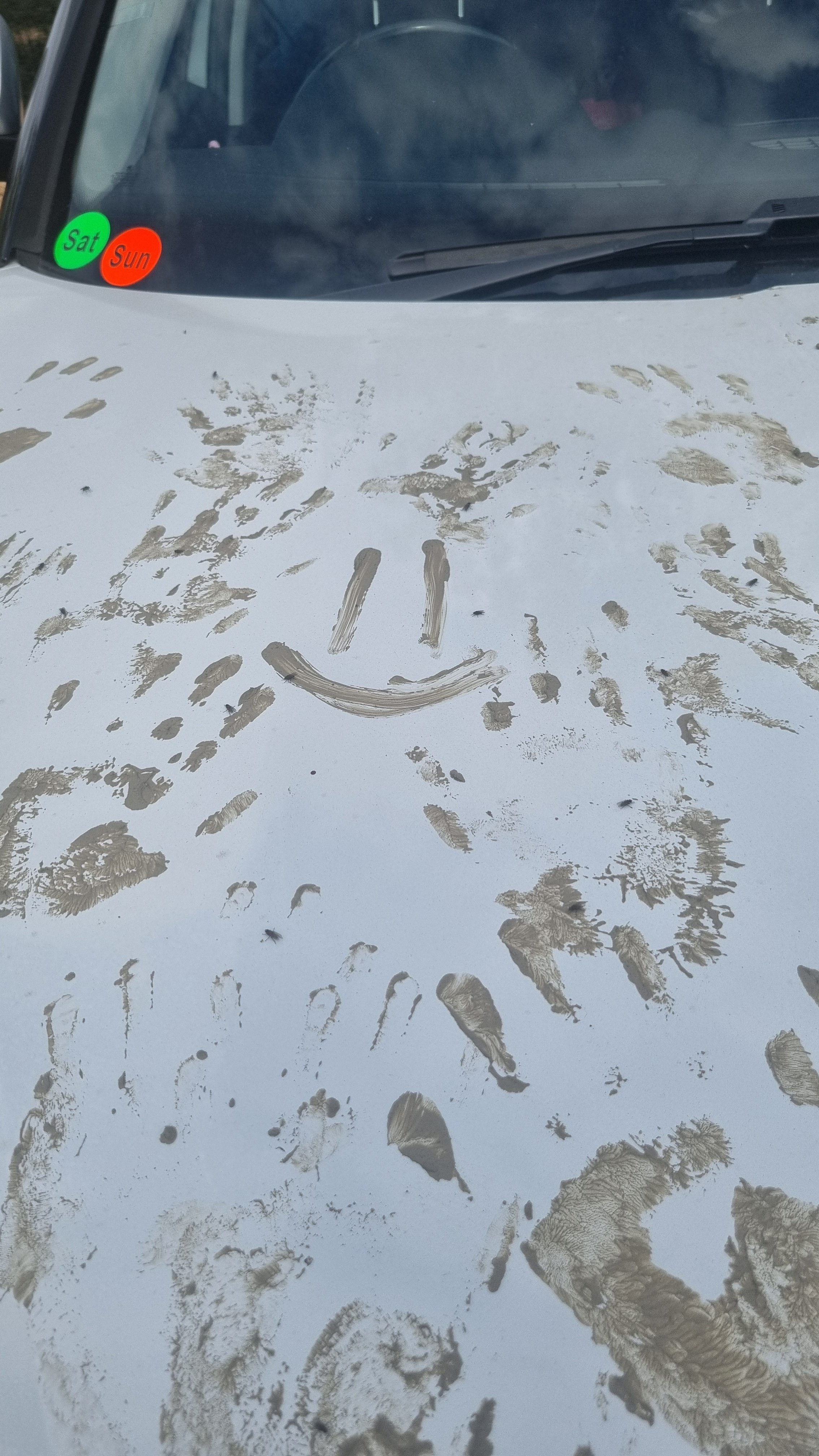

Don't leave a white car unattended when there are muddy people around 😂.

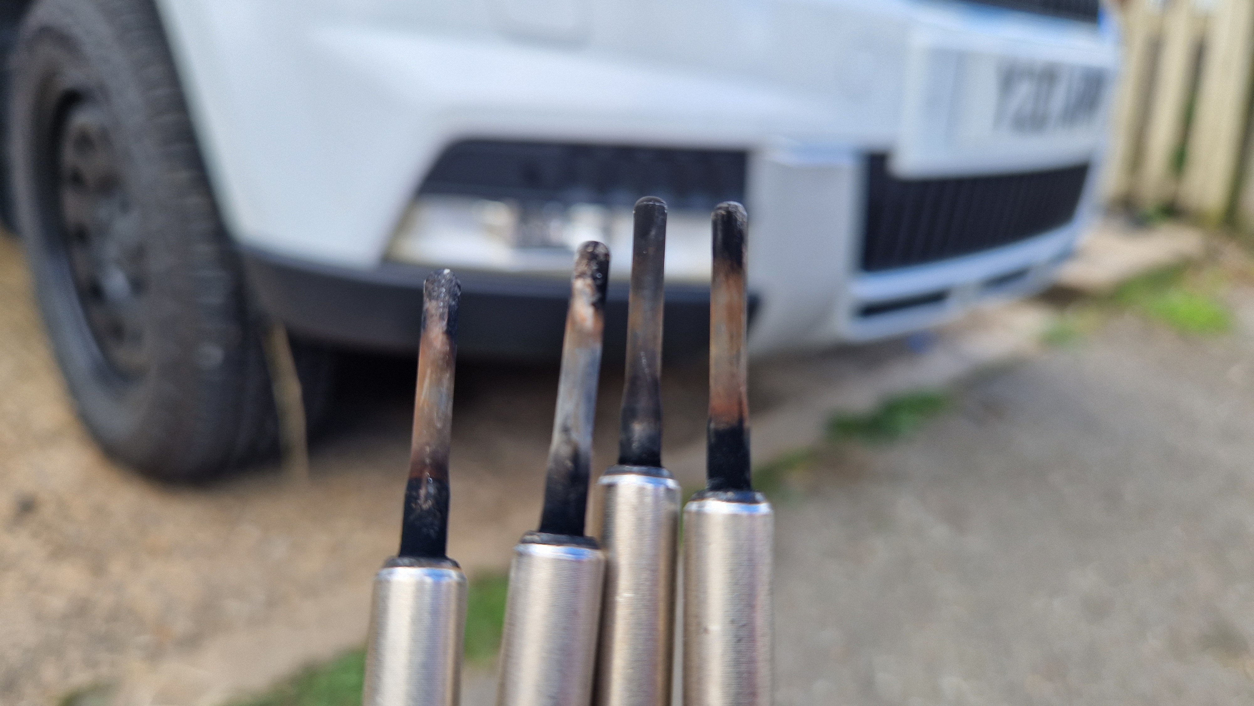

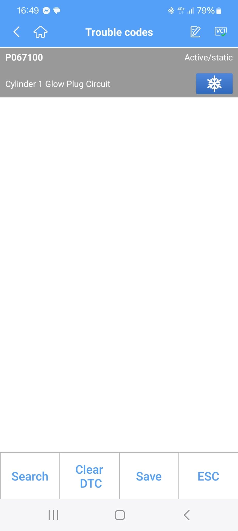

After many miles of happy motoring the engine management light has shown itself on the dash of our Skoda Yeti! After a quick scan with our Autel AP200 Bluetooth diagnostics reader, it showed us the code P067100 and the description "Cylinder 1 Glow Plug Circuit".

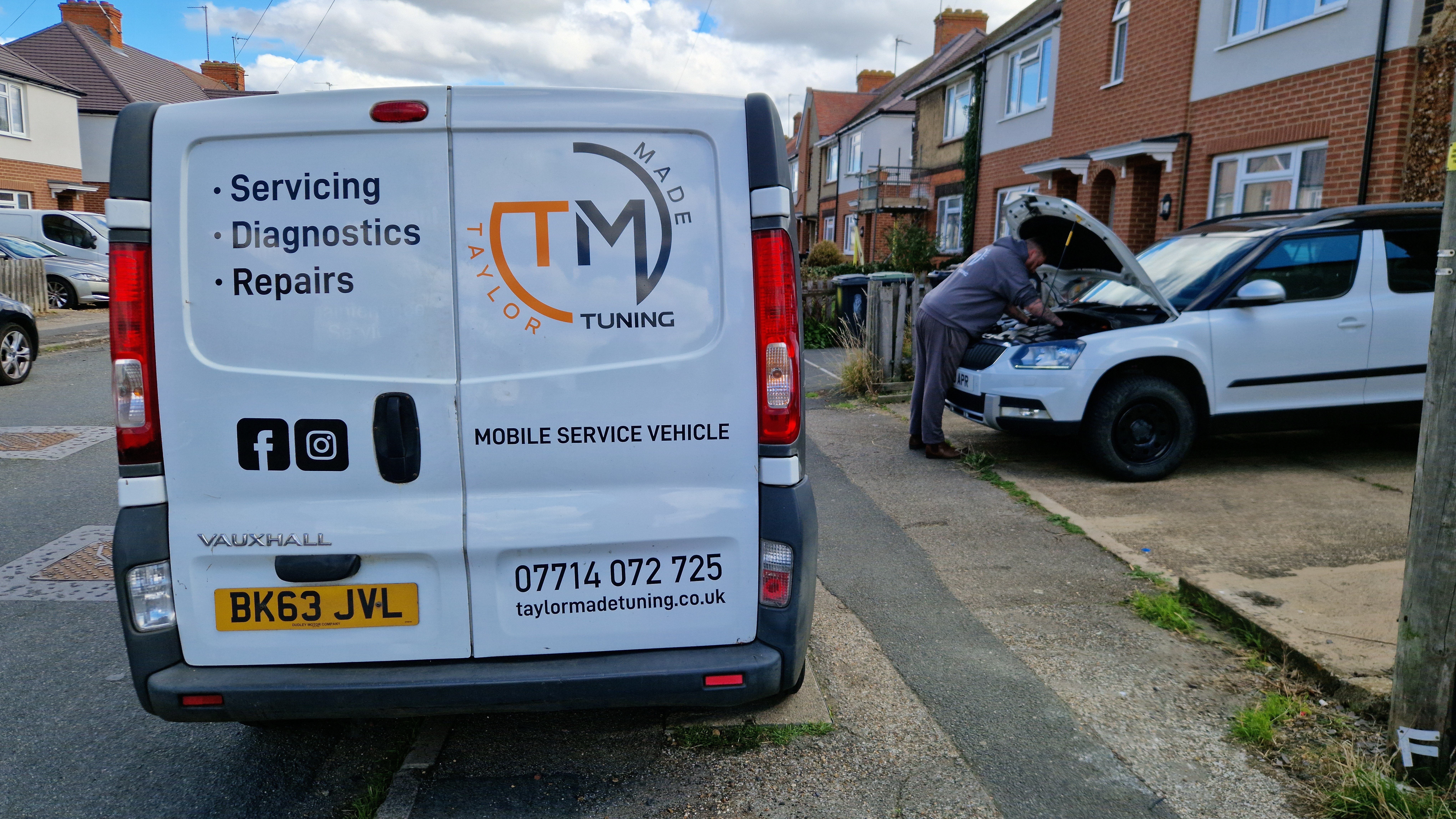

We decided not to tackle this job ourselves for the fear of twisting the head off of 1 of the glow plugs and having an even worse problem on our hands 😄. Instead we called out Taylor Made Tuning, a local mobile mechanic to do the job for us.
A couple of notes, do your research before buying glow plugs for a Yeti. I cannot be sure but I think the EA189 (non-adblue engines) have 4 normal glow plugs fitted. The newer EA288 (adblue engines) have 3 normal glow plugs in cylinders 1, 2 and 4 with cylinder 3 having a pressure sensing glow plug fitted. Please double check this before taking it as gospel.
Before doing the job, take the car out for a drive to heat up the engine. This will aid the removal of the glow plugs.

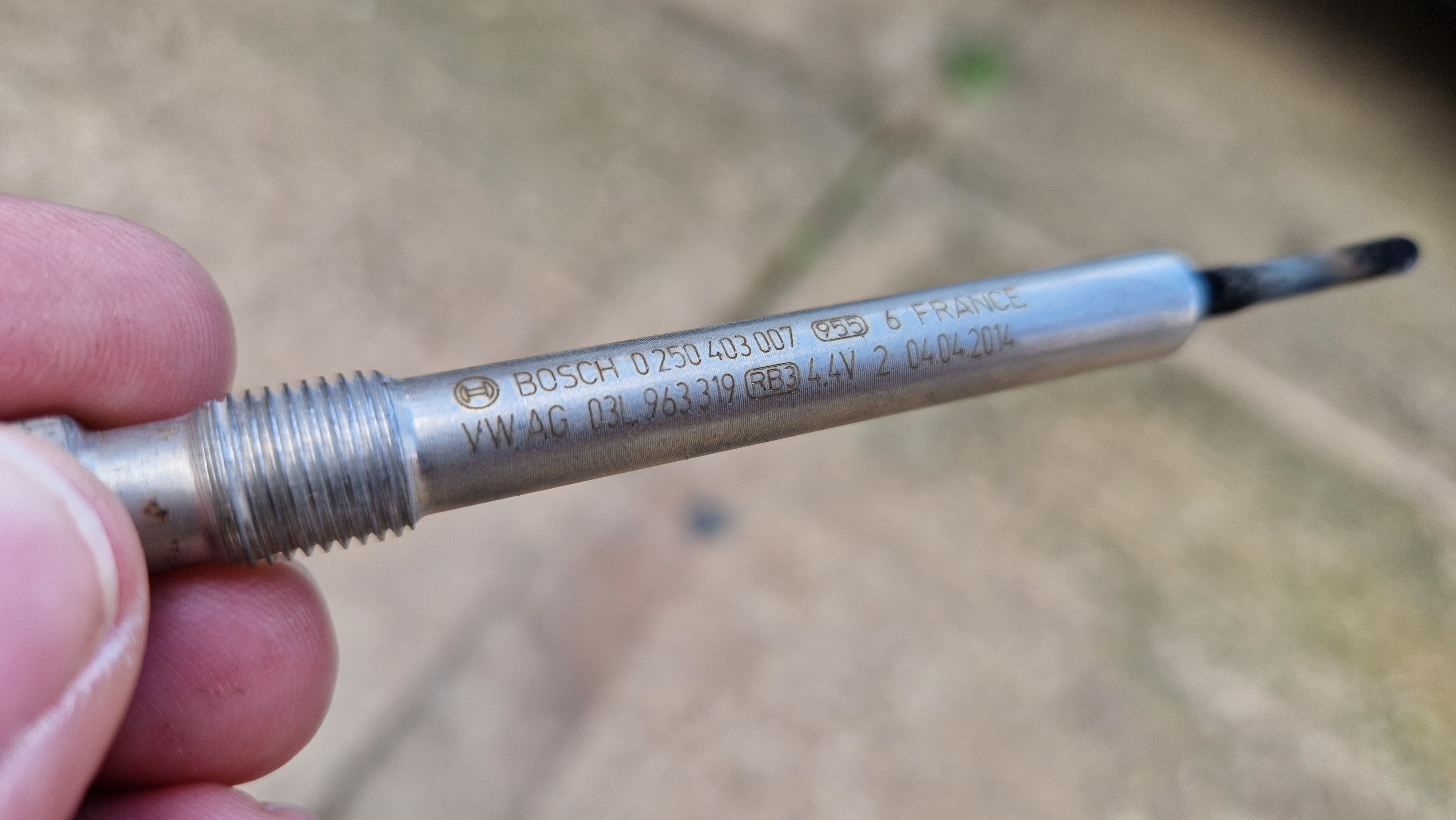

The glow plugs that were removed which we believe to be fitted from the factory were Bosch with the following information...
0 250 403 007
FRANCE
VW AG 03L 963319 (RB3) 4.4V 2 04 04 2014

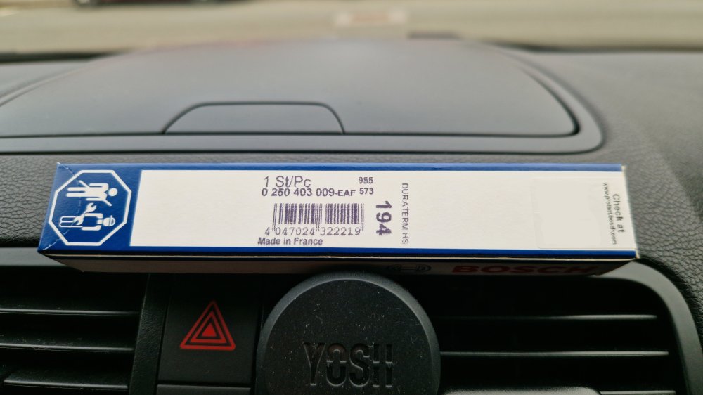

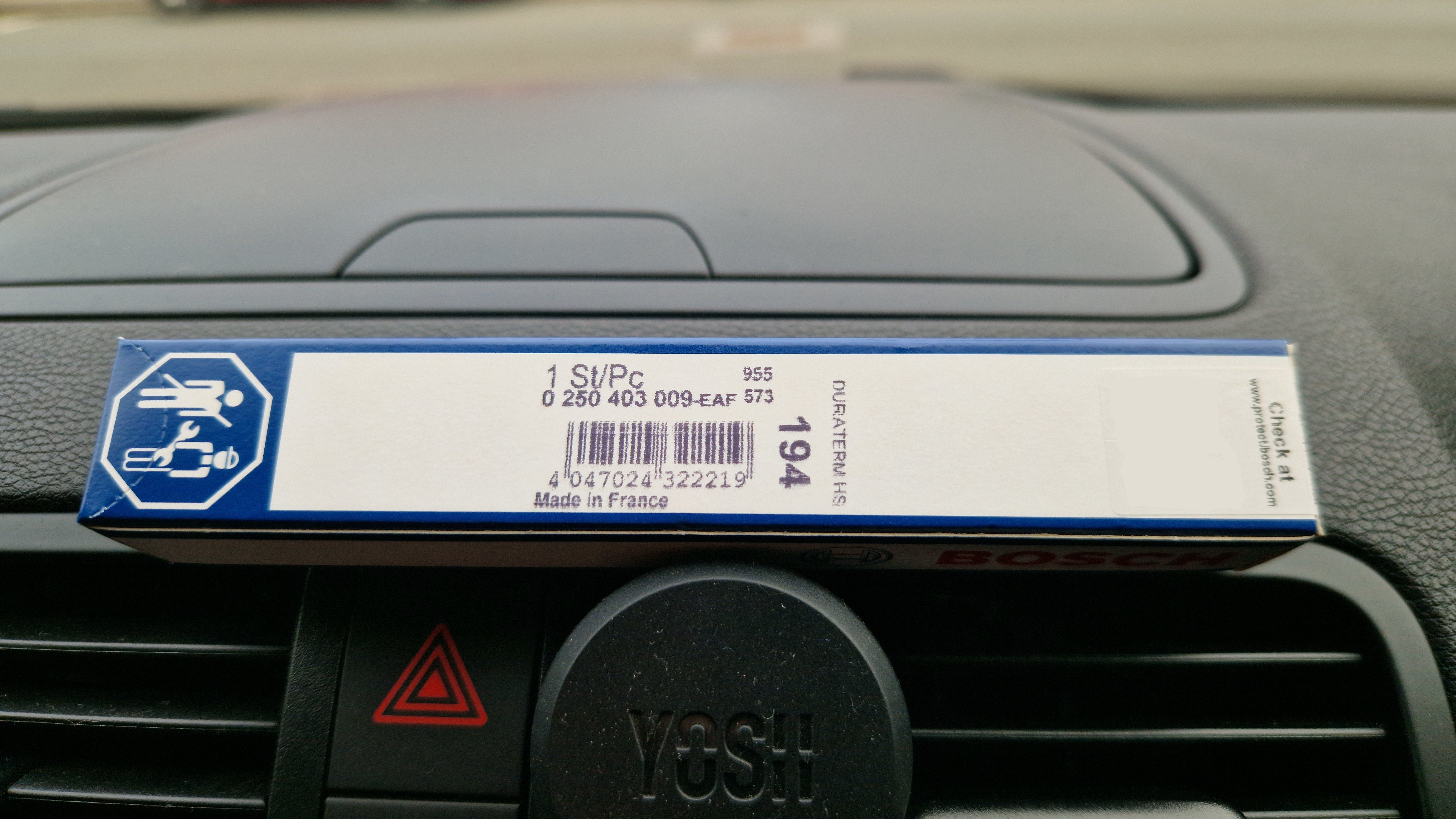

The glow plugs that we got fitted were also Bosch with the following information on the box...
0 250 403 009-EAF
DURATERM HS 194
955 573
Made in France
Here's a few pictures for you:
