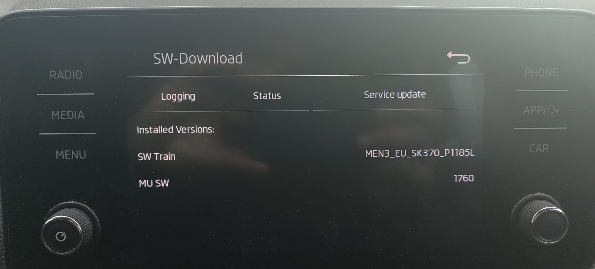

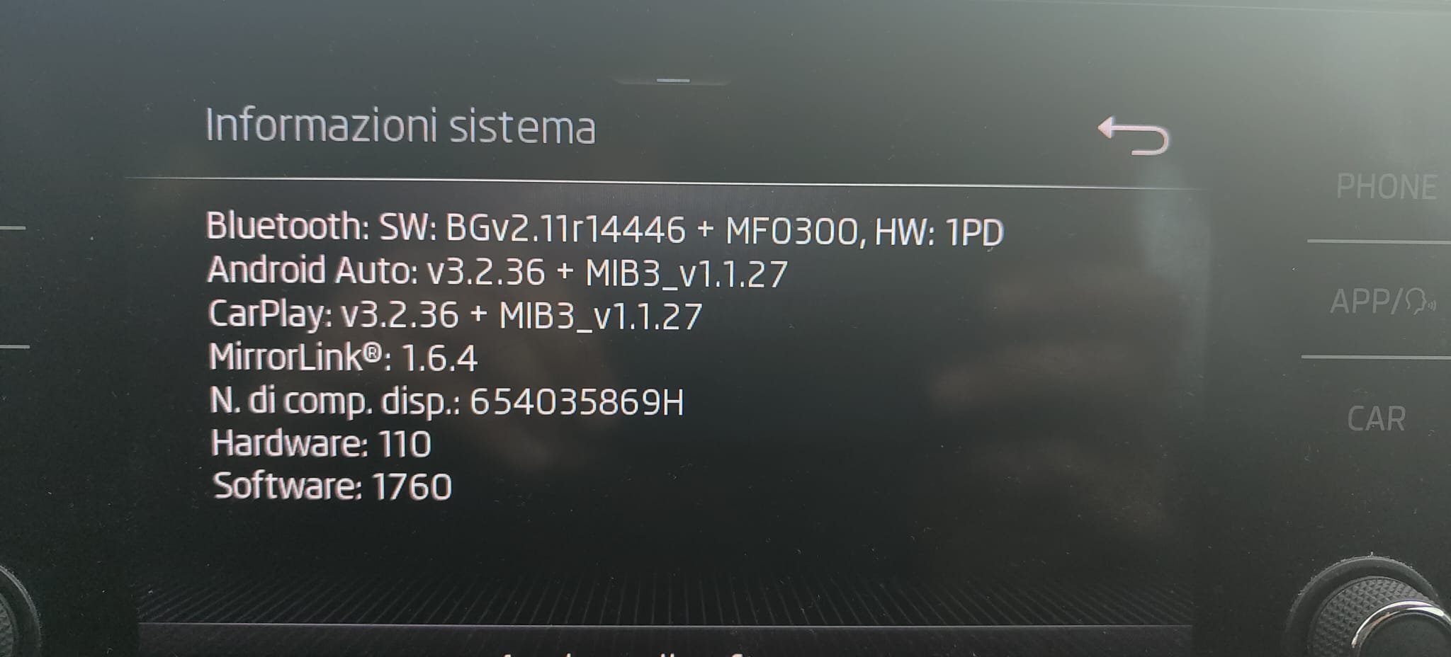

Here my model: SKODA FABIA 1.0 MPI Evo 59KW AMBITION Hatchback 5-door (Euro 6D)
Here the info of the infotainment system:
On 14/03/2025 at 16:41, Vlad-8 said:
I search for teh firmware, it seems to suggest it is available...but then I get lost in the folders and files!
