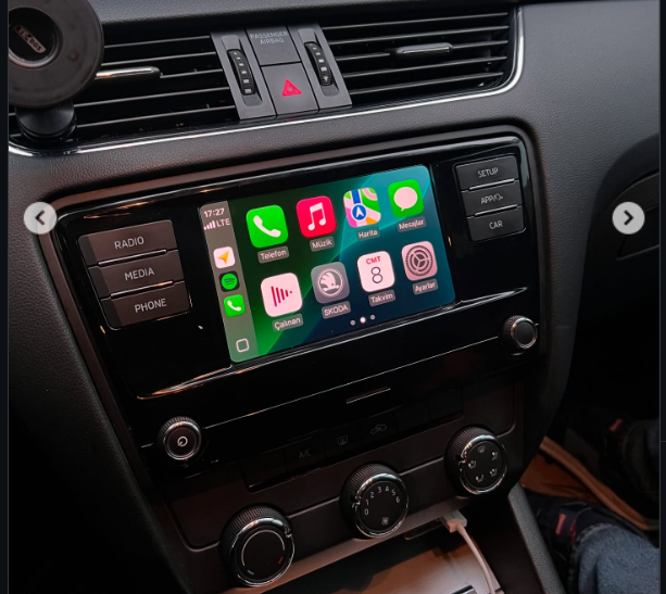

  • You Guys are amazing! Thank You for all. Everything Works perfect! Keep up the good work

Hi, thank you very much for the instructions. I struggled a bit with windows 11, but in the end everything is OK. The radio with SmartLink activation works. Thanks again Tom

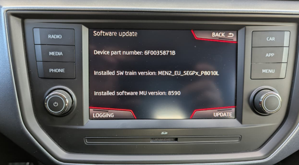

I stumbled on this guide some days ago searching for something similar, since i don't have a Skoda but a 2019 Seat Arona with similar head unit MEN2_EU_SEGPx_P8010L.
Can this patch work for this unit too?

Hi, I believe these head units are very similar, probably based on the same platform, so it’s possible that this guide will work for them as well. However, I haven’t personally tested it, so I can’t guarantee that it will work and you proceed at your own risk. If you decide to try it, take extra care and make sure everything is aligned with this tutorial.
Make sure the EEPROM is the same as the one used in Škoda units, and check that the script prints FAZIT and Train correctly, etc.
Also, even if the script is different for SEAT and Škoda and something goes wrong, you can always write the original EEPROM back. That should return head unit to its default state.
