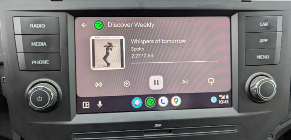

  • You Guys are amazing! Thank You for all. Everything Works perfect! Keep up the good work

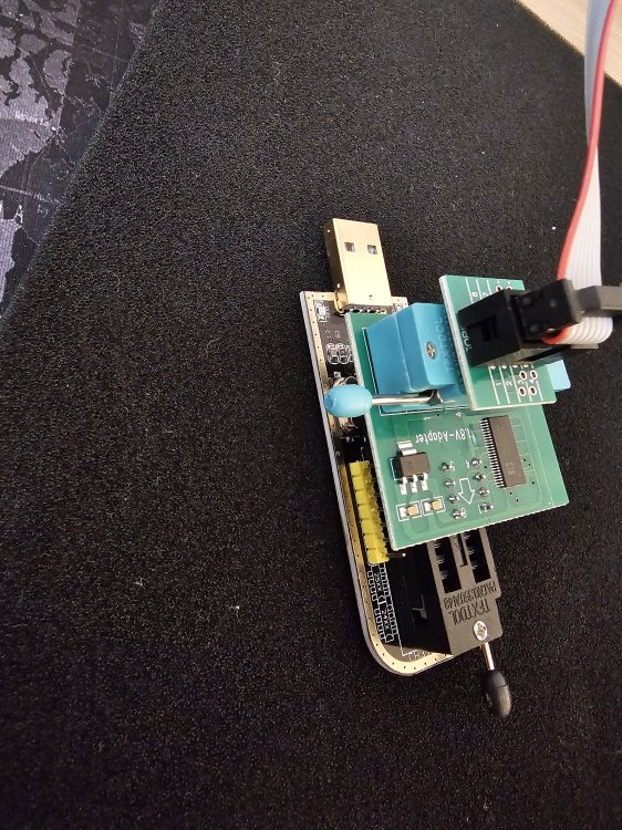

USEFUL TO KNOW! If the chip is not read via the 1.8V adapter, it means that it needs to be removed from the board.

Just did the patch on a MEN2_EU_SEGPx_P8010L unit (SEAT Arona), worked flawlessly. In the past I faced a memory corruption issue that happened because the IC didn't fully make contact with the "clamp" pins so I just desoldered the IC to be safe

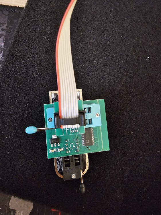

Hello,
Why does the LED on the programmer always go out when I connect the board through a clamp? I should have everything connected correctly.
Hi, did you try with 1.8v adapter?
On 21/02/2026 at 21:29, Zlatko580 said:
First try with 1.8v adapter.
No, i dont have this adapter. Do you think this would fix this problem?
Maybe yes, maybe no. What is your MU version?

It should work with or without 1.8 adapter, you can try both options. If it still dosent read, then you need to unsolder chip or at least unsolder vcc leg.

All working as it should, no issues so far.
