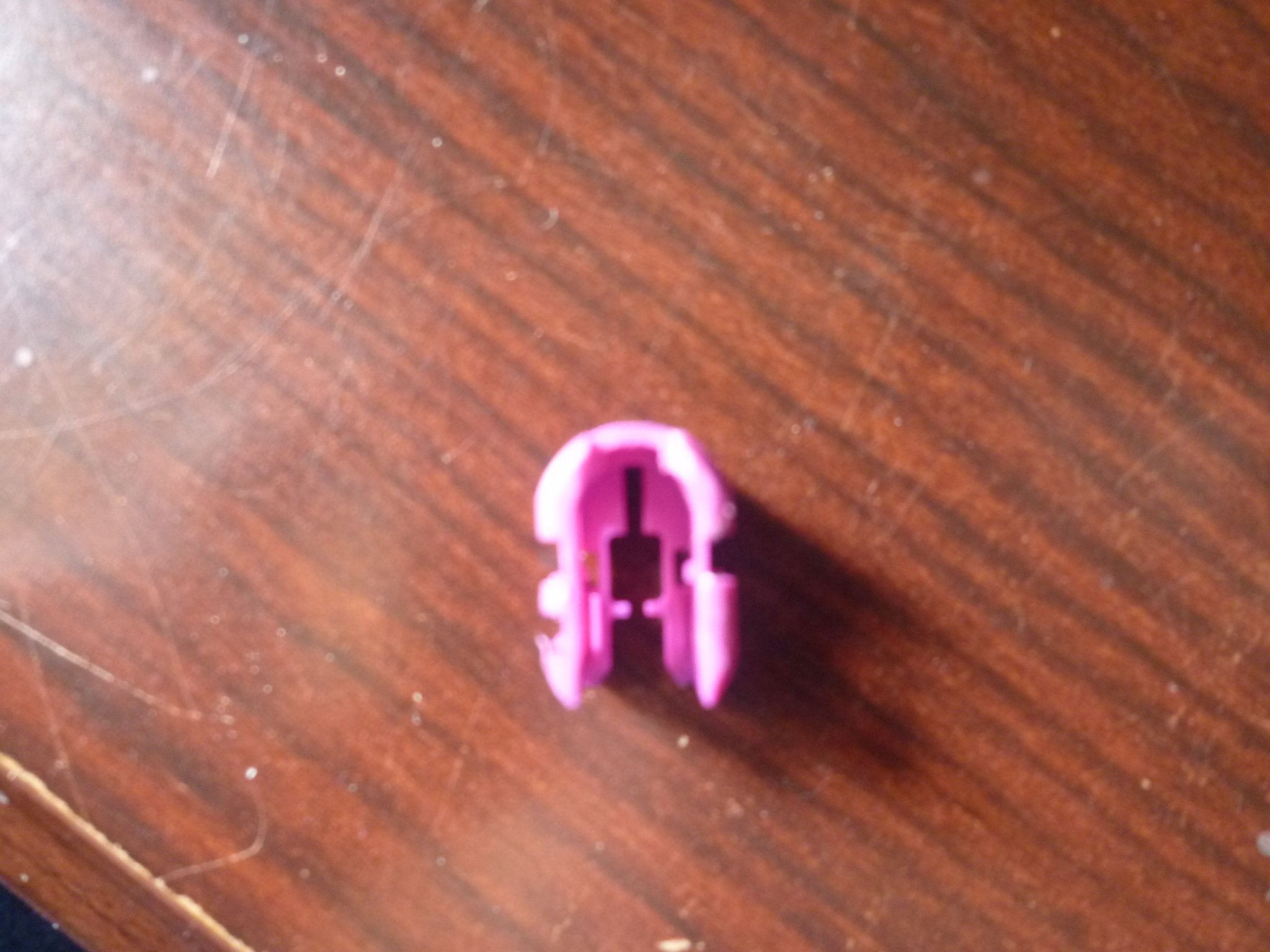

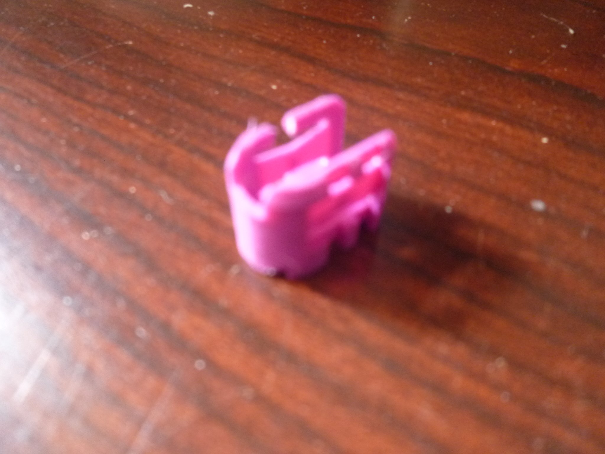

I took the alternator (Bosch 140A) off again to see why the plug wouldn't go in. The reason is pictured below. It fits round the connector within the plug and has one groove on one side and two on the other. The grooves were obviously right for the Valeo alternator, but not for the Bosch. With it removed the plug goes in properly. In the Bosch alternator socket the pins are numbered 1 and 2. The blue wire goes to 1 when the plug is in. If that is correct, then the problem is solved. The shape of the plug being what it is, it's hard to see the purpose of the pink insert.
  • Sponsor
The insert helps to retain the contacts, I think. checking pin numbers for you now, but I expect that's right.
  • Sponsor
Yes, I can confirm that pin 1 is the blue wire.
Interesting that the keying is different, I shall try to remember that.

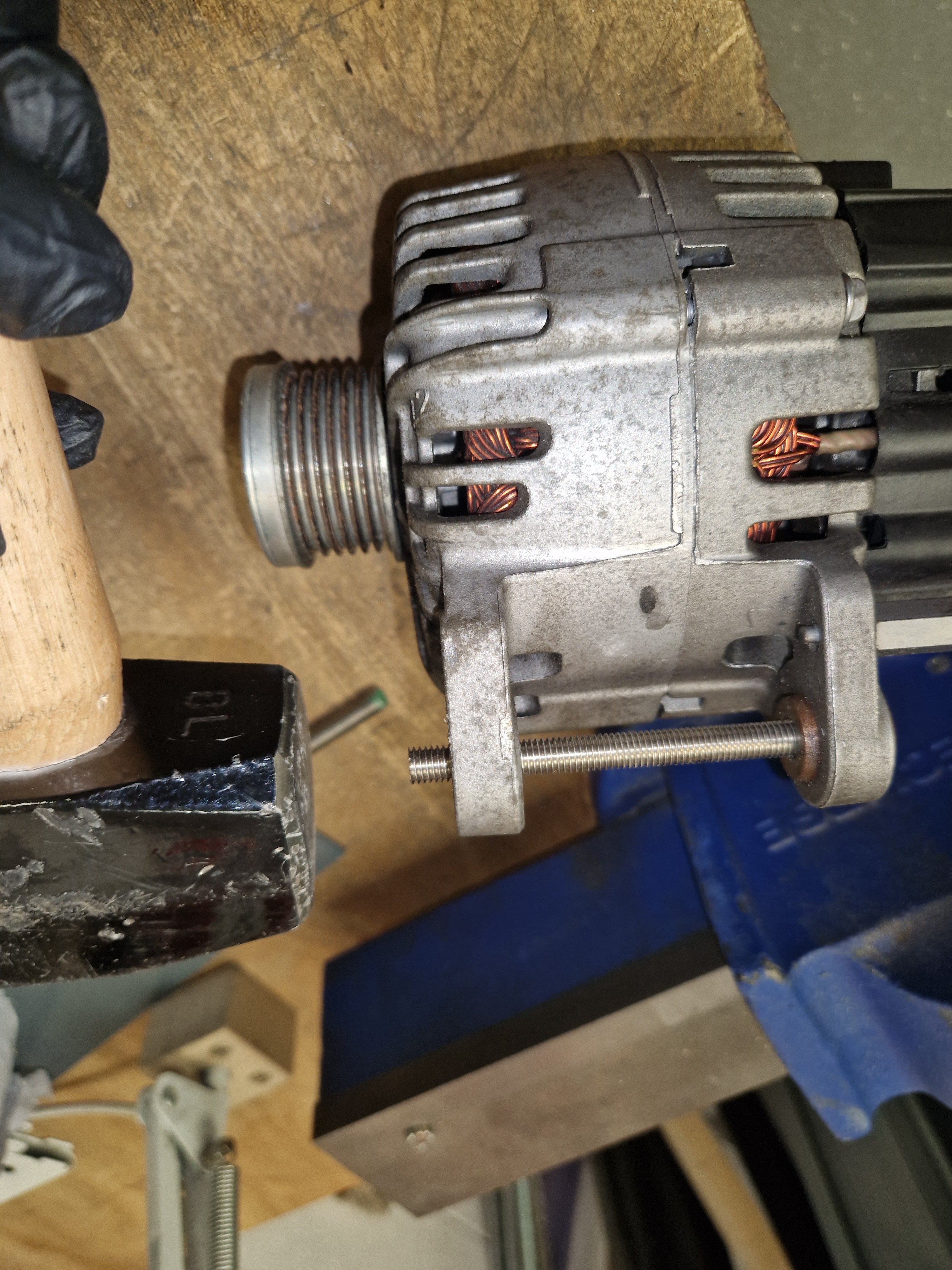

There's a trick with the lugs. The steel threaded bush is actually a tight but sliding fit within the inner alloy lugs. Before attempting to fit, you can move these outwards to increase the gap down the middle. Doesn't help with removal, but knowing it can make refitting much easier.
Put bolt in several turns with it off the car, supported around a hole in something that the bush can move into (e.g. open vice jaws), then give the bolt head a few taps with heavy hammer. Only needs to move a mm to make a world of difference.
  • Sponsor
Couldn't hold it all above open vice and take photo, but hopefully you get the 'drift'.
  • Sponsor
Might be room to hammer one or more of them looser for removal, depending on how crowded the engine bay is near the bolt heads.
