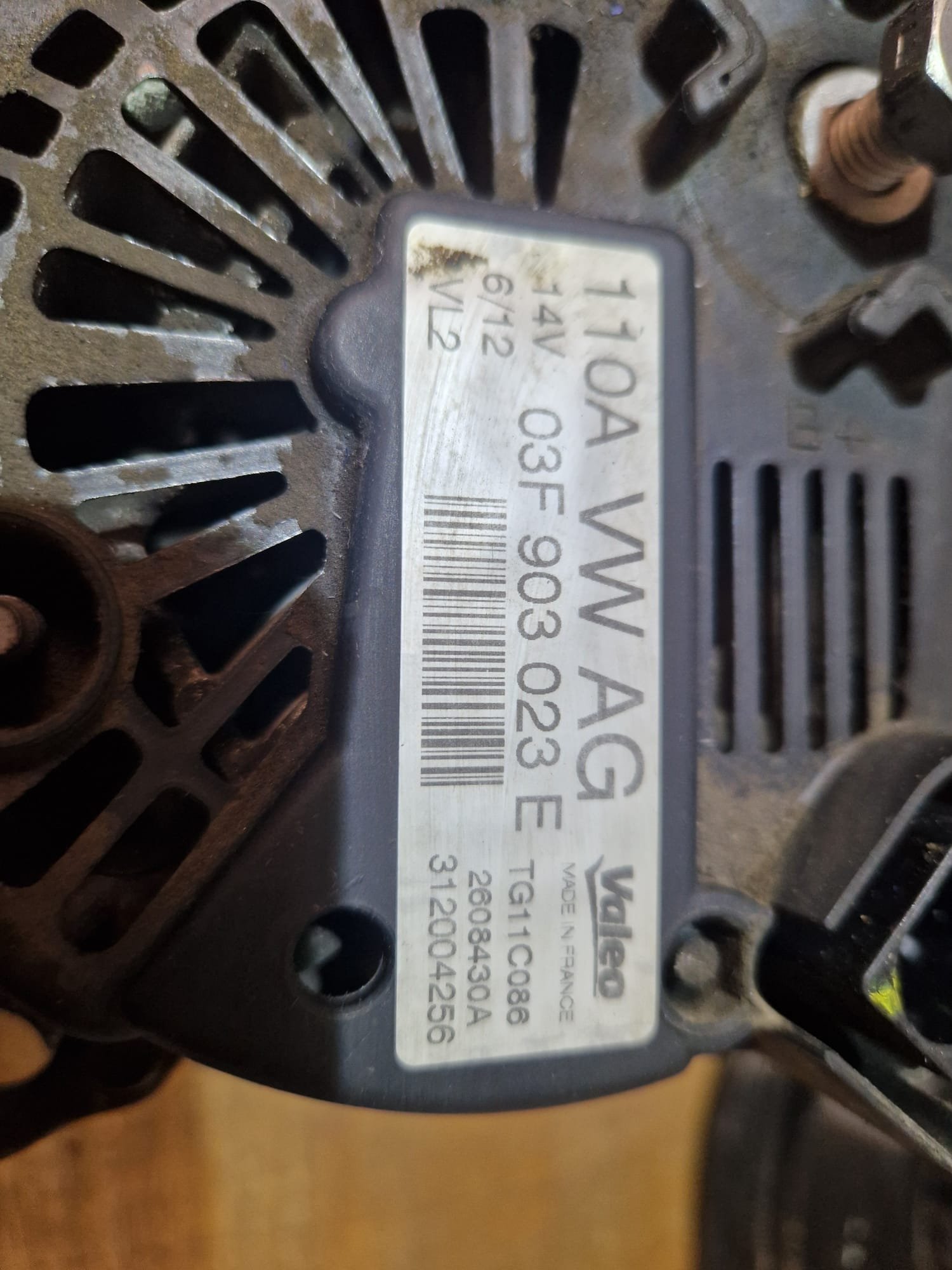

Things aren't going well! The Bosch alternator is a dud. One of the slip rings is knackered. My friend has checked out the origial Valeo 110A (VW AG 03F 903 023 E or Valeo TG11C086) and he reckons the diodes are all good, as are the slip rings and brushes, so it must be the regulator. The regulator/brush packs for these seem to start at about £52 on Ebay, whereas similar looking ones can be as little as £25. New alternators locally are from £145 and not much better on Ebay. Any suggestions? Is the Bosch 140A of any value, needing new slip rings and maybe a regulator brush pack? Only cost me £30 via Marketplace. Seemed nice folks!

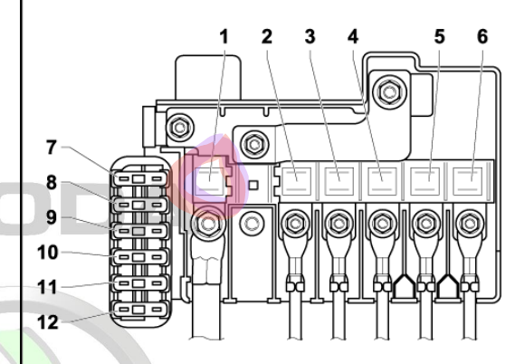

There may be a rather poor connection somewhere between alternator and battery. Can you prize off the plastic cap from the alternator output terminal and measure directly there, carefully, to be sure of not shorting probe to anything unintended? Red probe on that stud, black probe on alternator alloy body. If that's nice and 14.3-ish, but the voltage across battery posts is much less, you will have confirmed a poor connection.
  • Sponsor
The strip fuse at the battery end of the alternator output cable isn't blown, is it?
Measure volts on cable end of it and compare with voltage at other end (above it in image).

I haven't been working on cars today, but I've just done some research online. The new alternator I bought is a WAI 20588N. That is a LIN-bus controlled alternator, which is otherwise known as a smart alternator. It is computer controlled. The WAI 20588N is the correct one for the car, replacing the Valeo TG11C086 (VWAG 03F 903 023E). I can't find a full Valeo spec. to confirm that the TG11C086 is LIN-bus controlled, and nor can I find it under the VW AG number.
  • Sponsor
You bought the wrong alternator, unfortunately. Who told you it was correct? Please don't say ECPs look-up by reg number...
Please confirm explicitly that your car does not have start/stop.
If so, the 03F 903 023E original alternator does not have a LIN connection. It has the blue exciter wire and the other DFM wire.

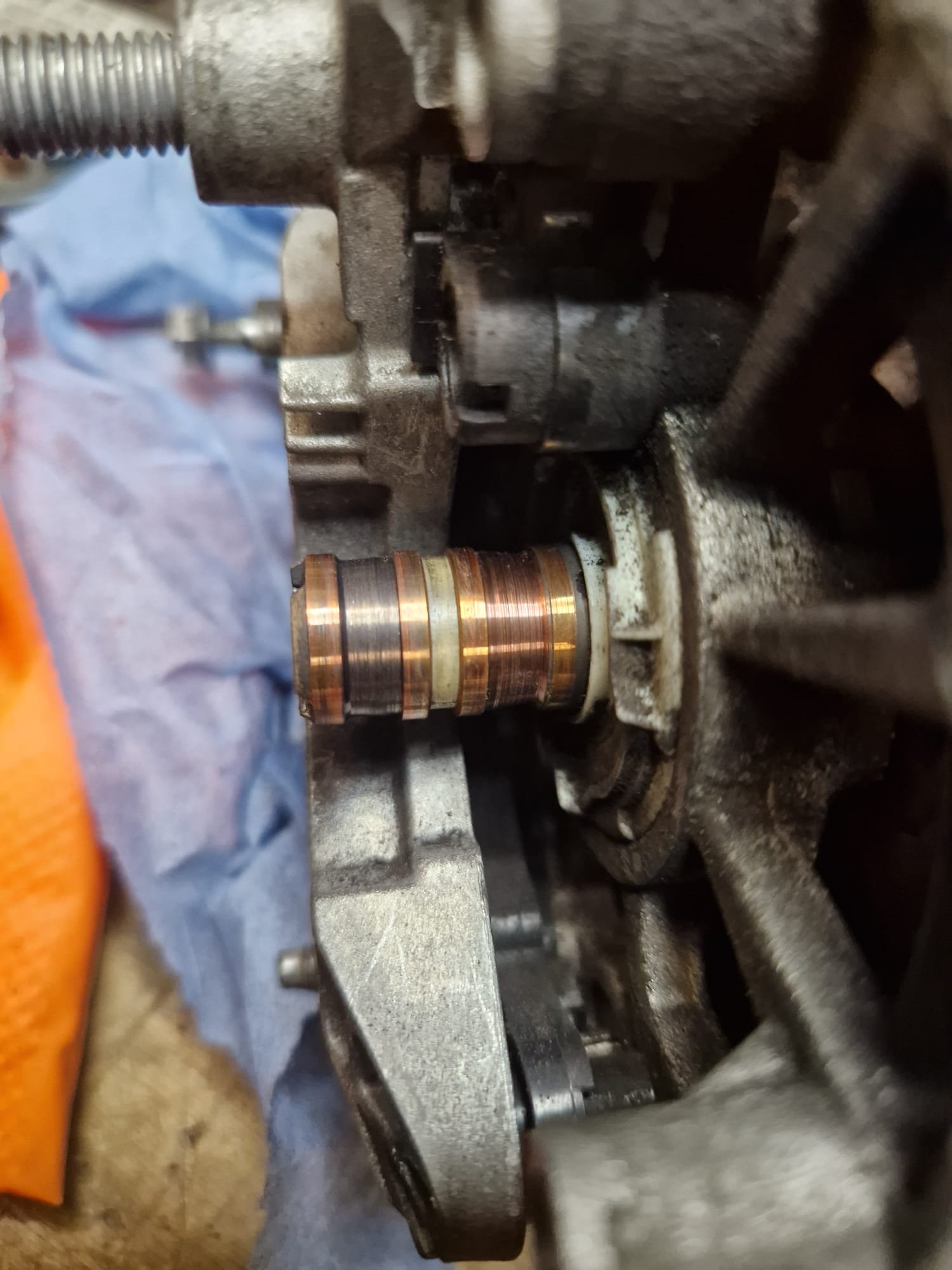

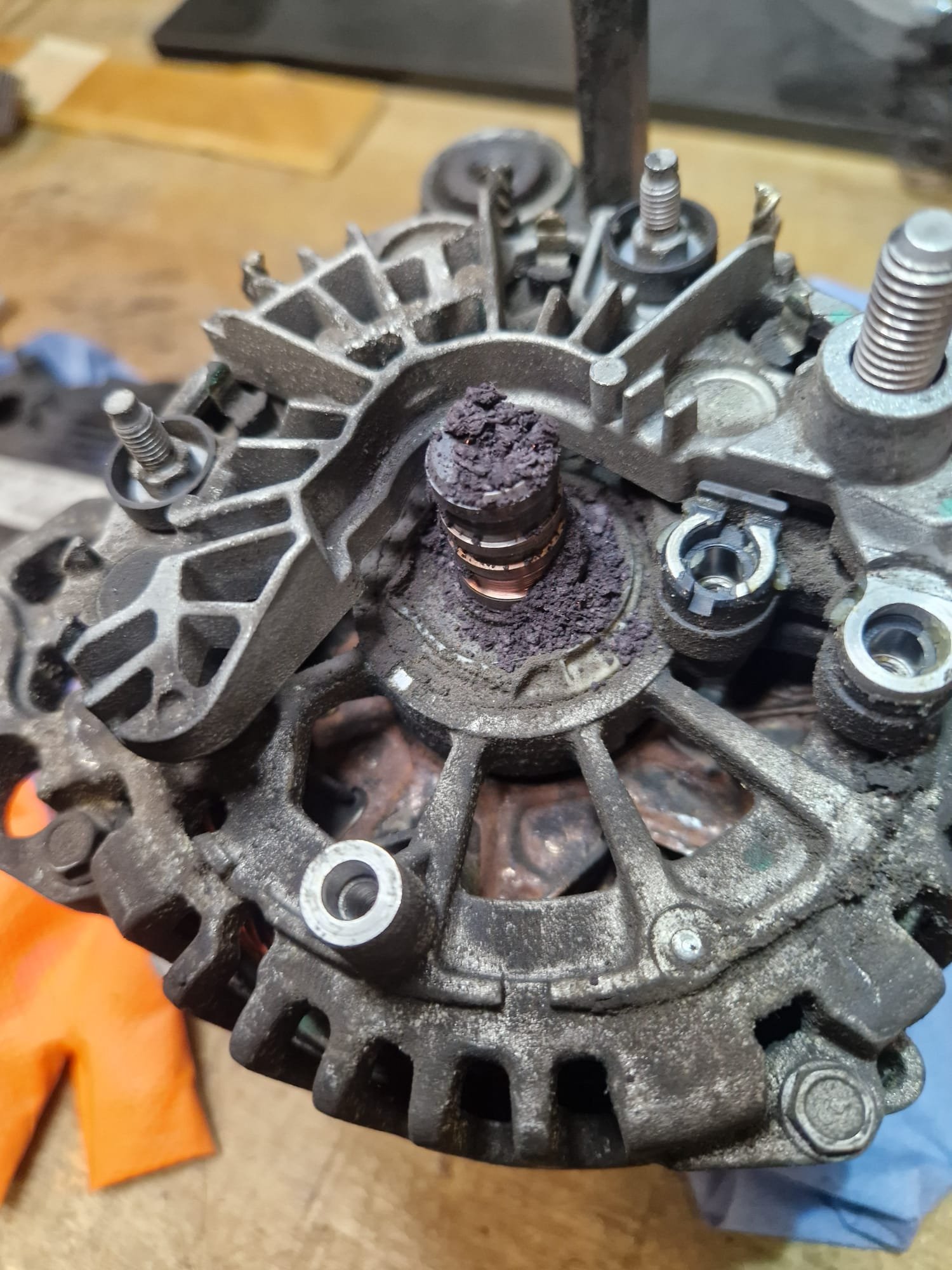

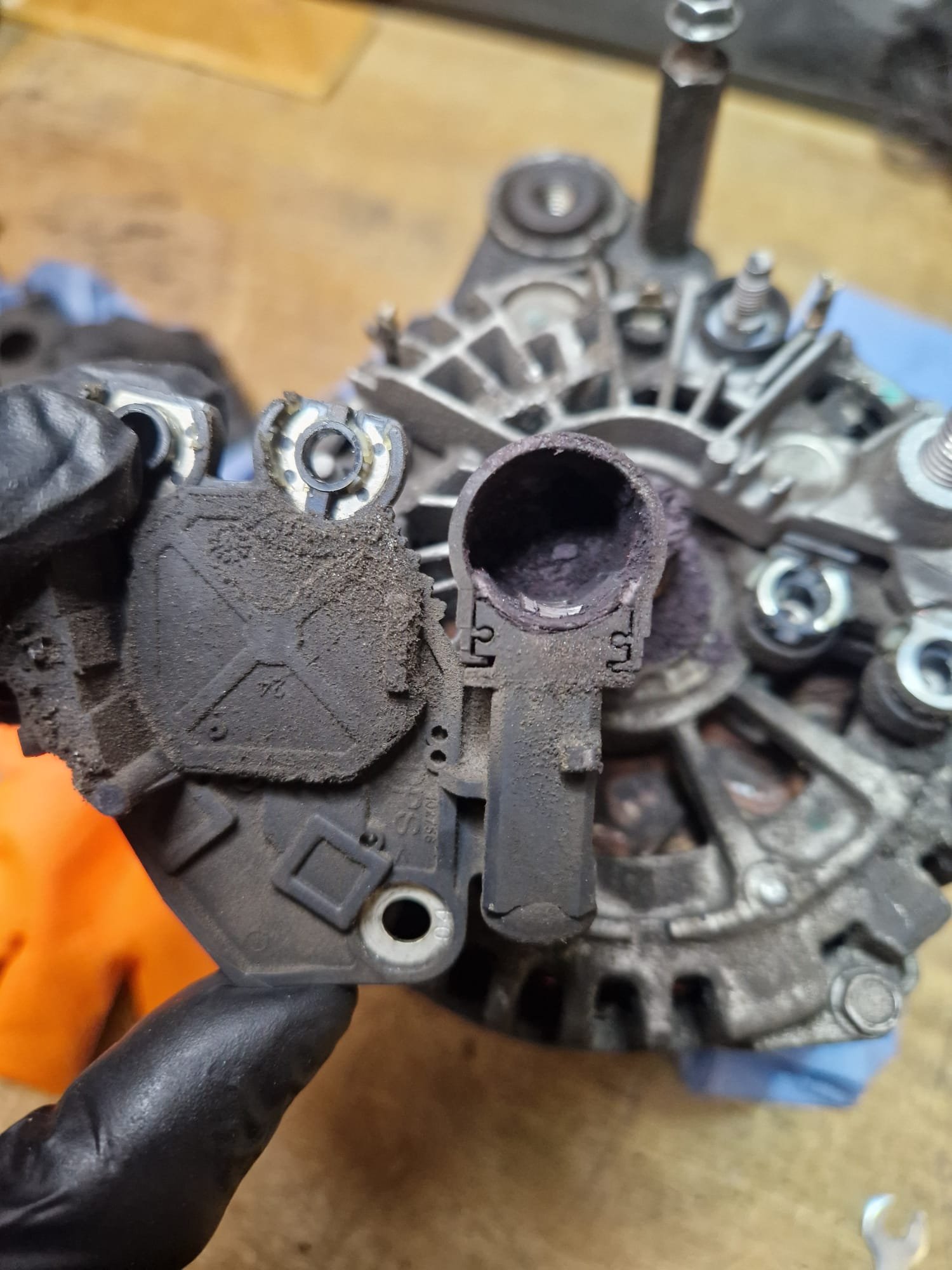

This one had every right to be struggling, major wear to sliprings and brush protrusion near zero.
Inner brush appeared to be just still making contact.
Not sure if you've tried, but the back cover prises off relatively easily, I just warmed up the plastic around the two M5 stud a bit first.
Then there are two M5 screws (8mm head) and one double stud with 7mm hex middle to remove regulator/brushpack.
