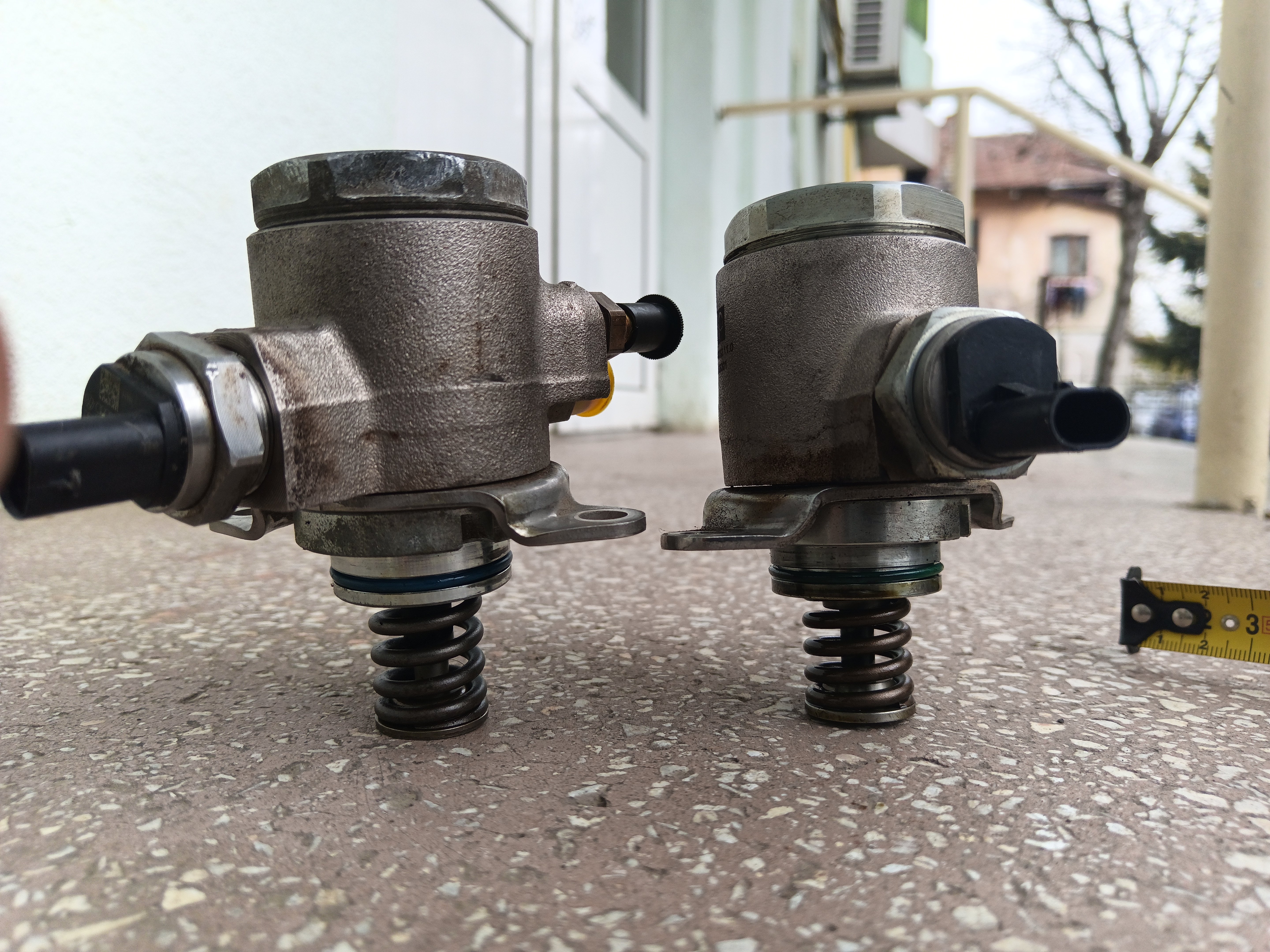

Hi. I found the source of the noise on my engine. I put back the old HPFP, and the noise disappeared.
The pump PIERBURG has a different rod length than the original pump, with ~4 mm, so the spring and cam follower jump inside, creating this noise.

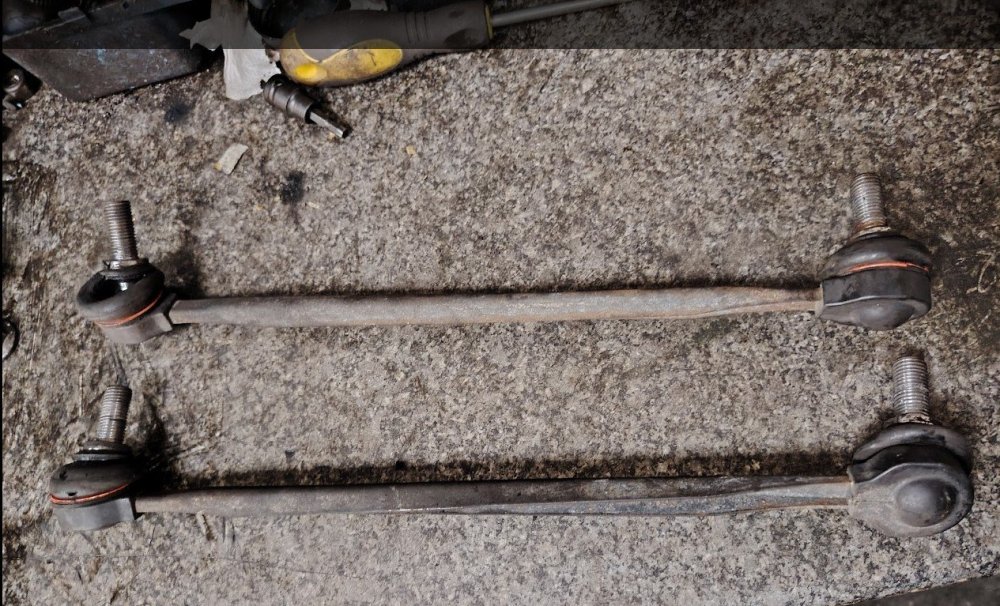

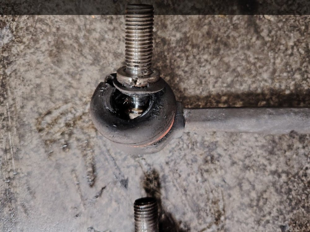

After replacing the ARB links on both front wheels, the noise is pretty much gone now. There's still a slight rattle from a panel or something, but it's nothing major – totally bearable.

On 25/03/2025 at 00:51, automass said:
... or any of the other suggestions put forward here.
Cough..... errrr....
On 20/03/2025 at 10:07, Gaz said:
Drop links creaking?
Gaz

They are worse than mine and they were bad. I seem to go through them quite a lot. Check the bushes in anti roll bar as well. Mine looked ok but decided to change them anyway as I still had a small knock sound. They were pretty poor once I removed them.
