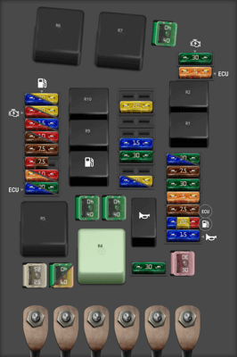

You need to get the CANBUS gateway back up online first and make sure that you are getting power to pins 16 (+ve power) and earth on Pin 4. If these aren't there, then you have a problem and the wiring has been messed around. Also check the uses and make sure they are hot both sides as well as making sure that you have all the fuses for all the services in the car.
This is a good guide to show you what you should/don't have etc:
2019 Mk3 Skoda Octavia fuse box...
No image preview
2019 Mk3 Skoda Octavia fuse box diagram - StartMyCar
