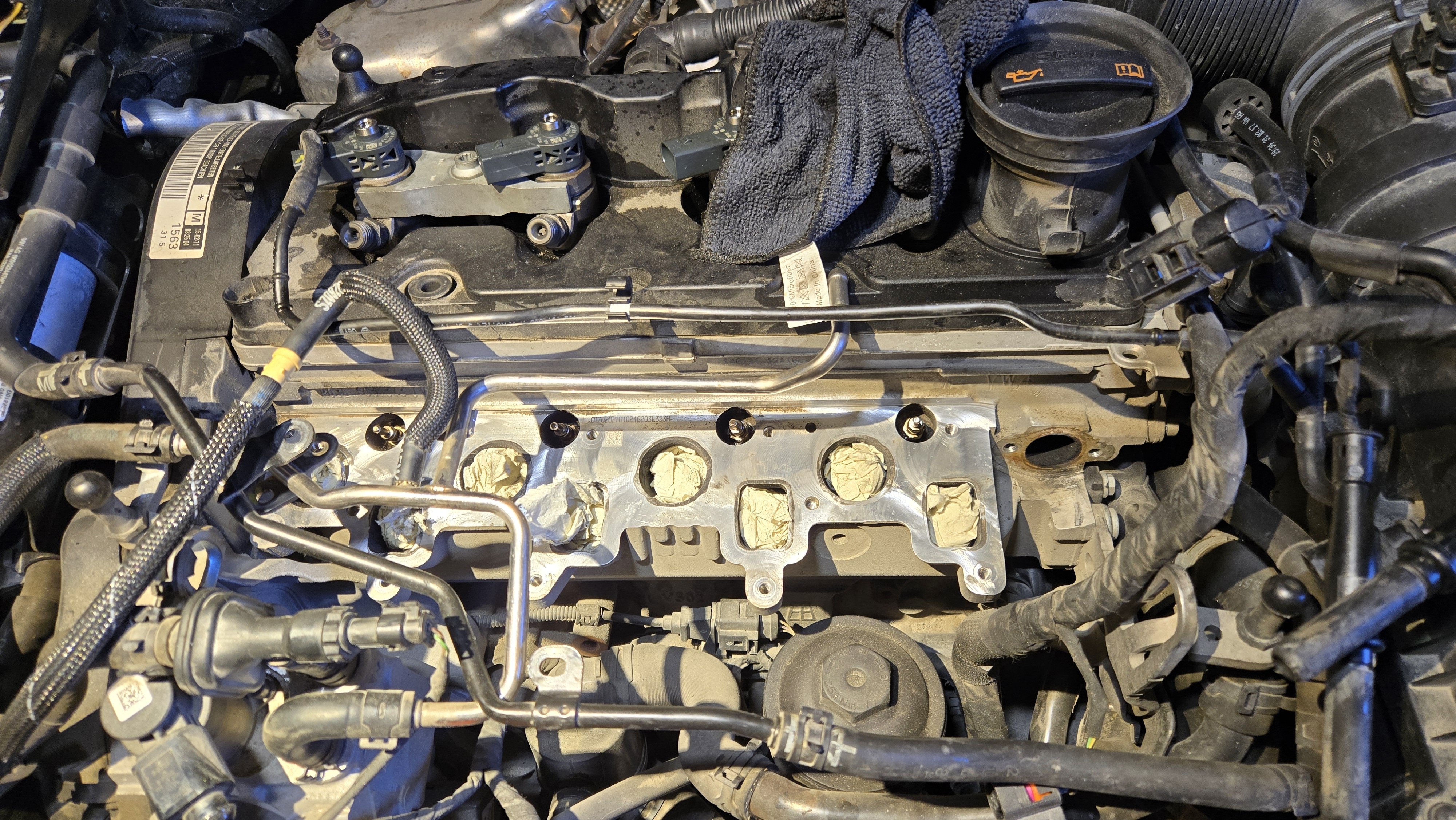

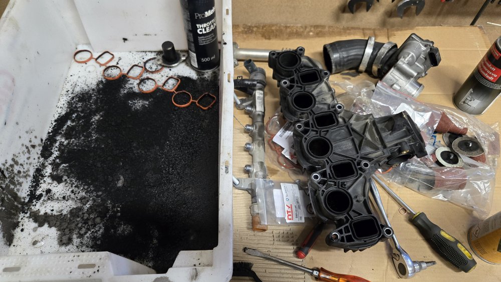

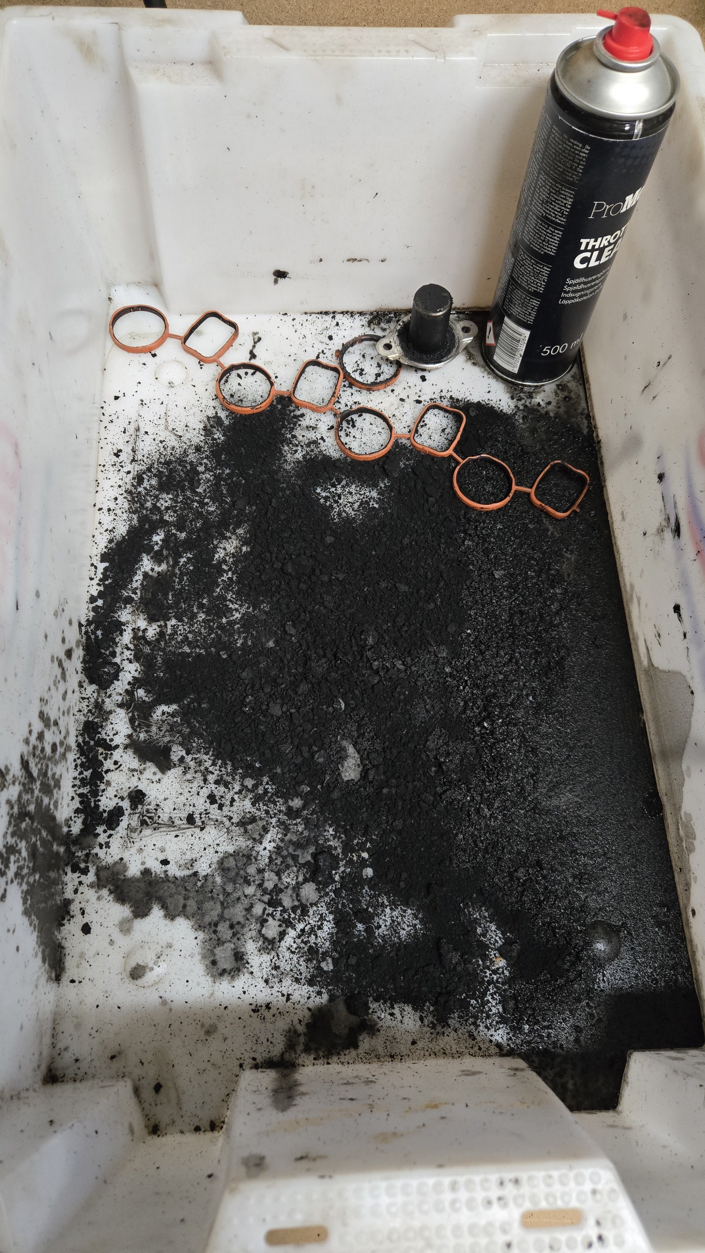

Clean your intake manifold
Well done, I did clean mine one year ago as I had to change throttle body. Unfortunately I did not take any pictures by yours are a very good representation of all the work that needs to be done.
You did glows plugs as well, what is the mileage of your car? I am considering too to change them as I have done 160K miles on my car
232 000km/145 000miles. But glow plugs are already replaced once approx 70 000km ago/43000miles
