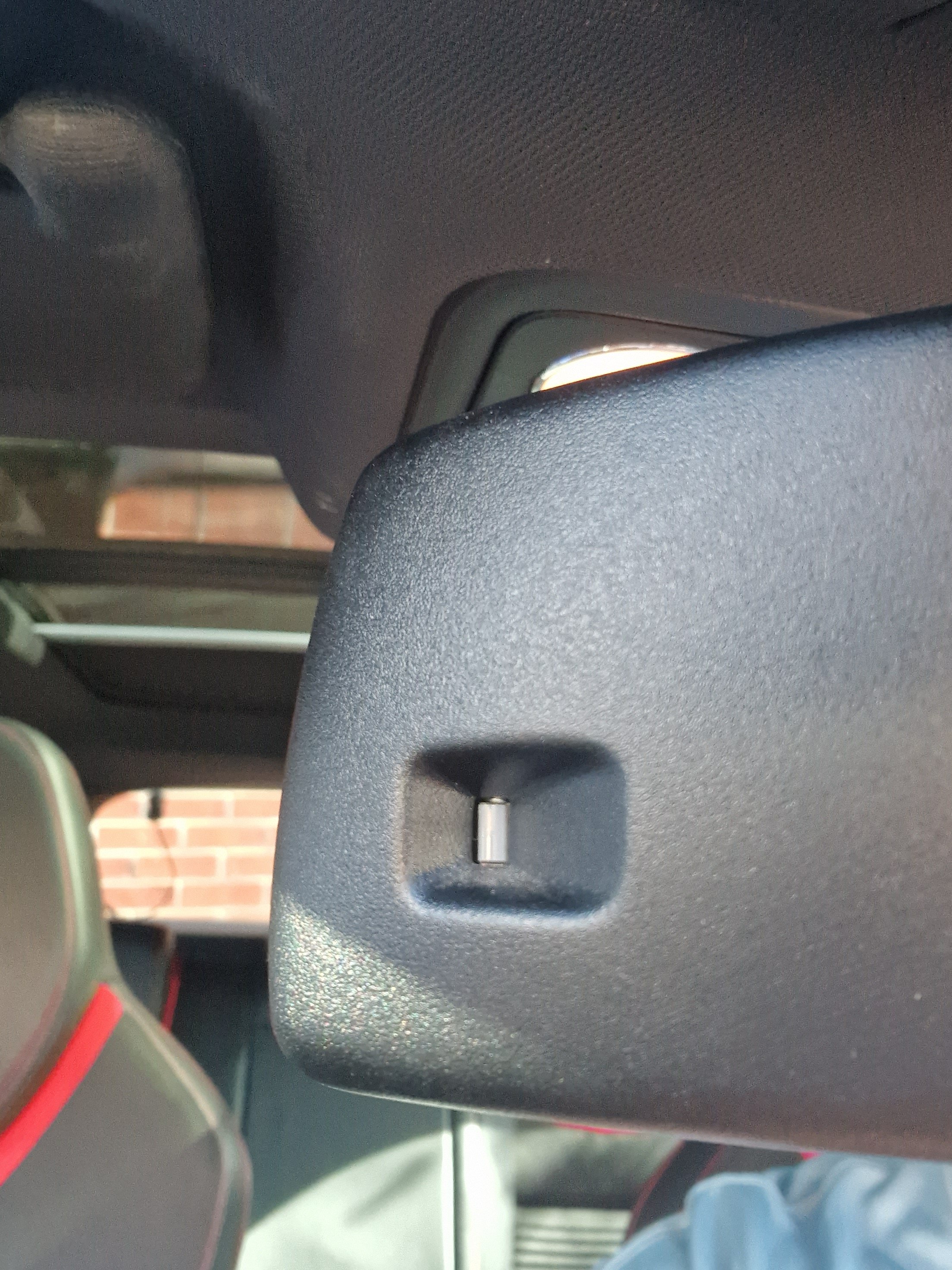

You probably have Lane Assist, but that is a different sensor to the sensor for high beam assist. Have a look at the back of your mirror - and if you have the appropriate sensor, it should show up as a black square on the back of the cabin mirror. No square - means no sensor and without retrofitting, you won't be able to do high beam assist.
Ahh that would make sense.

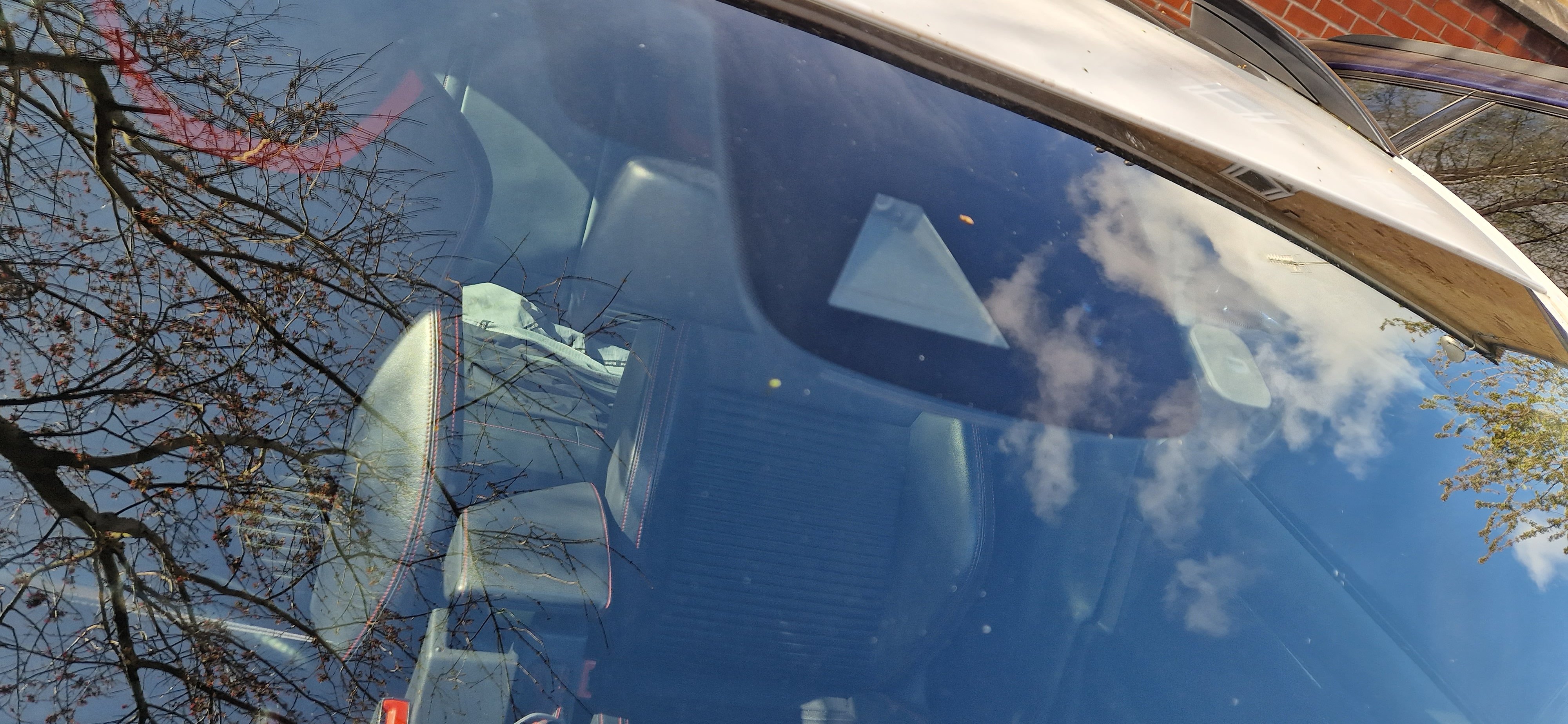

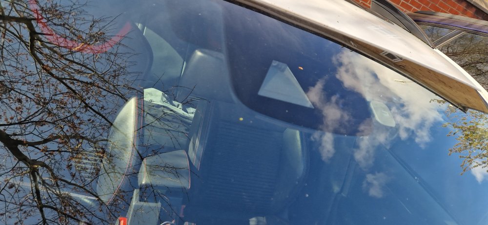

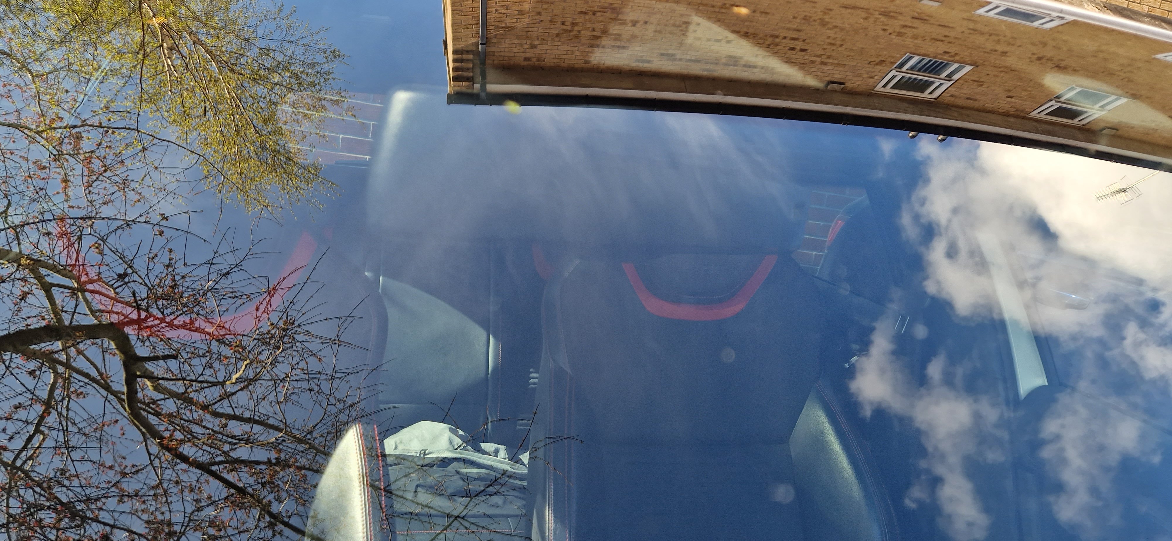

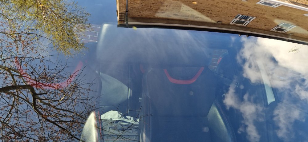

There's two sensors in the windscreen glass, then there is a small square on the back of the rearview mirror with a sensor inside, but not sure if it's the right one, pics attached.
Edited by Ripmax12345
and yet...there seems to be an intermediate option!
It looks like you have a light sensor (updated) and a camera in your car. I think we might need a full scan of the car to determine the modules and then we can advise on coding.

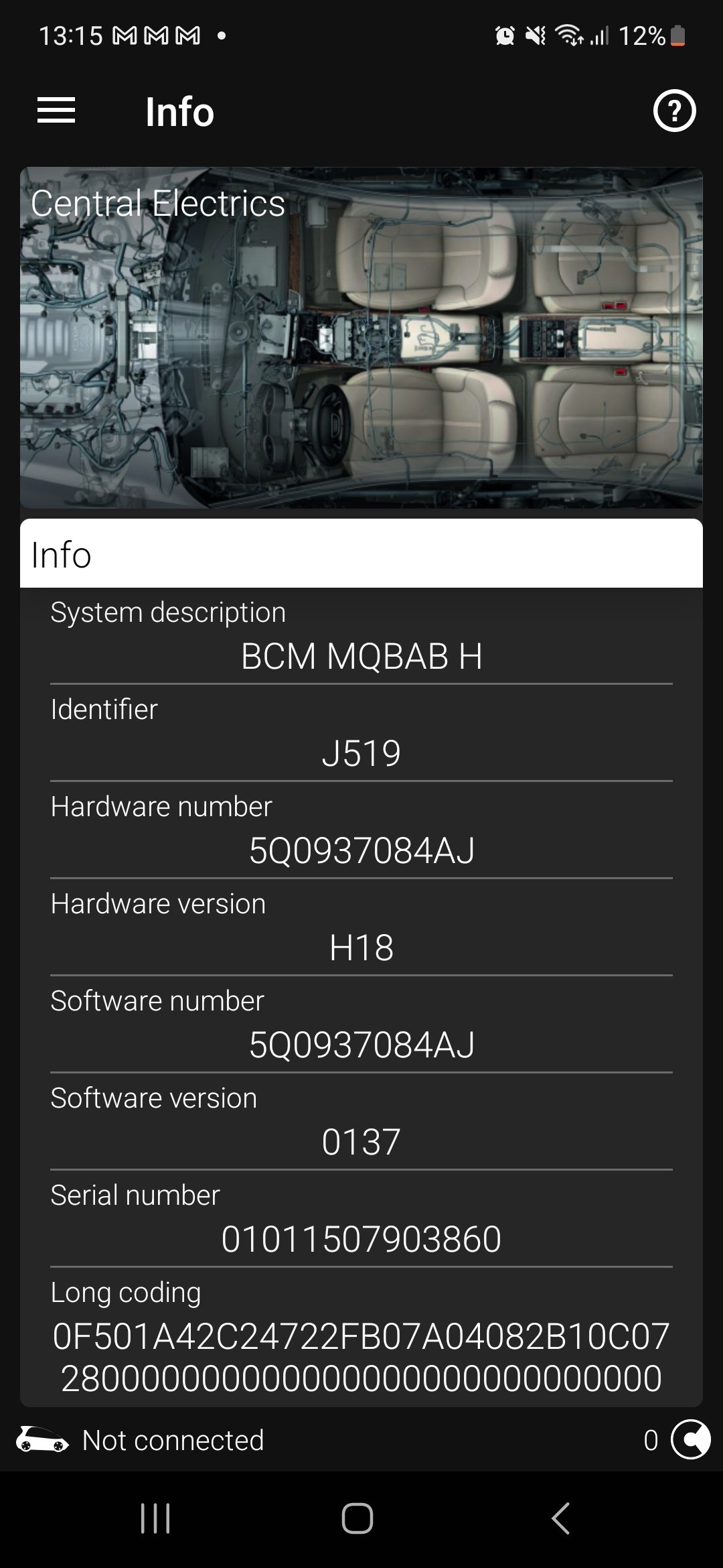

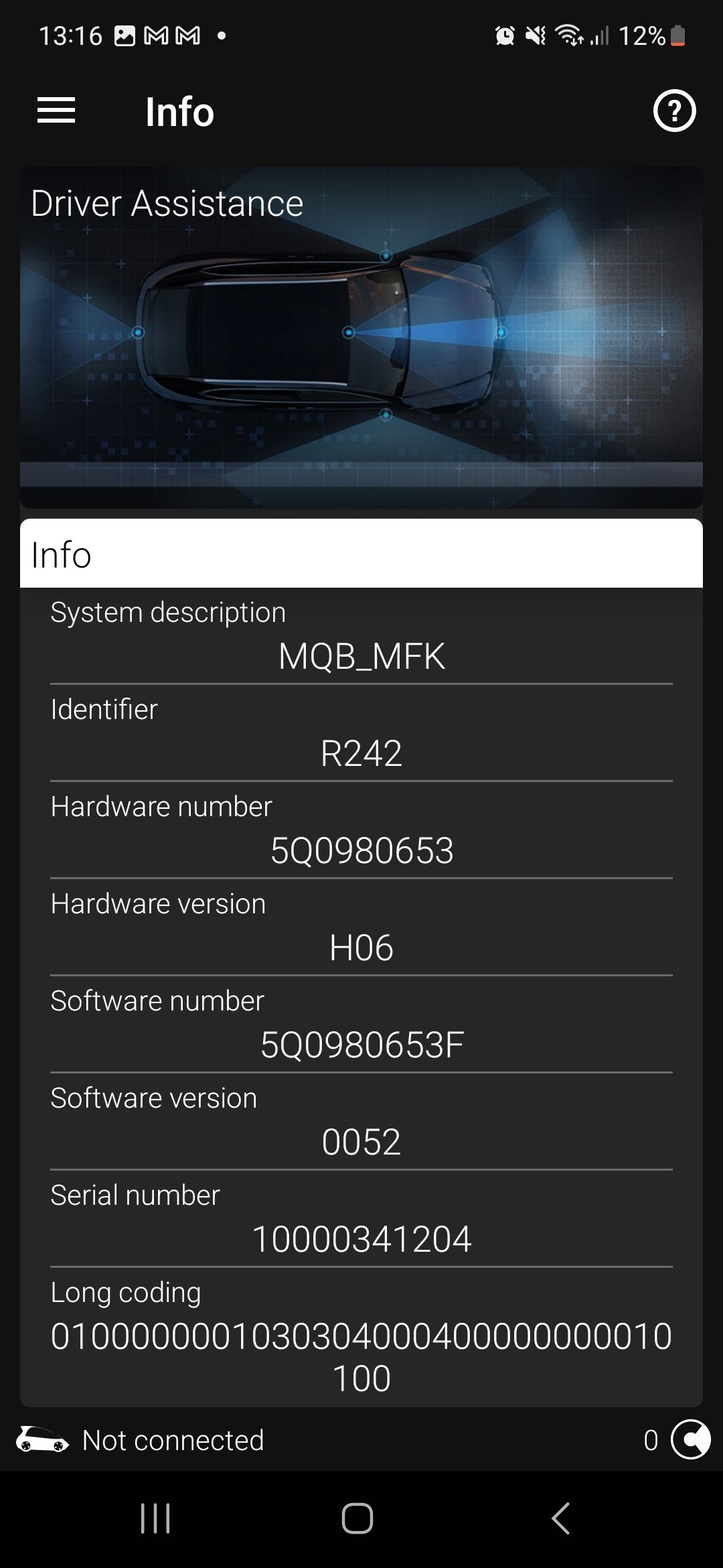

Here's the info pages from my 09 Central and A5 assistance modules.
Sorry I am not totally sure how to do a full scan with OBDEleven
Thanks :)

Unfortunately the issue for me was that the software version of my A5 module (windscreen camera) is too old.
9 hours ago, Ripmax12345 said:
Hi, glad you got it sorted.
You have a 5Q0 camera, right? The FLA (Front Light Assist) is activated differently on this camera than on the 3Q0 camera. I've never had any problems with it.
5Q0 980 653 software version 0052.
