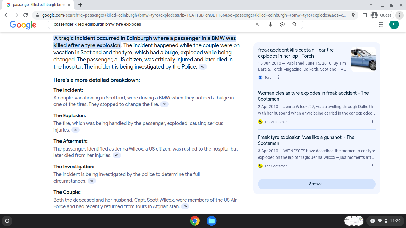

The guy in Scotland put it behind the seat in his BMW and it exploded and killed the passenger.

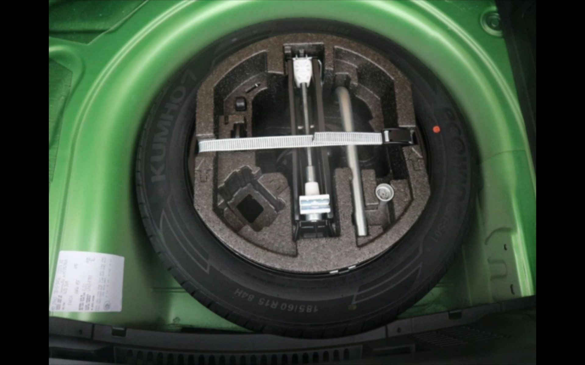

Green Favia Mk2 vRS OEM standard spare.

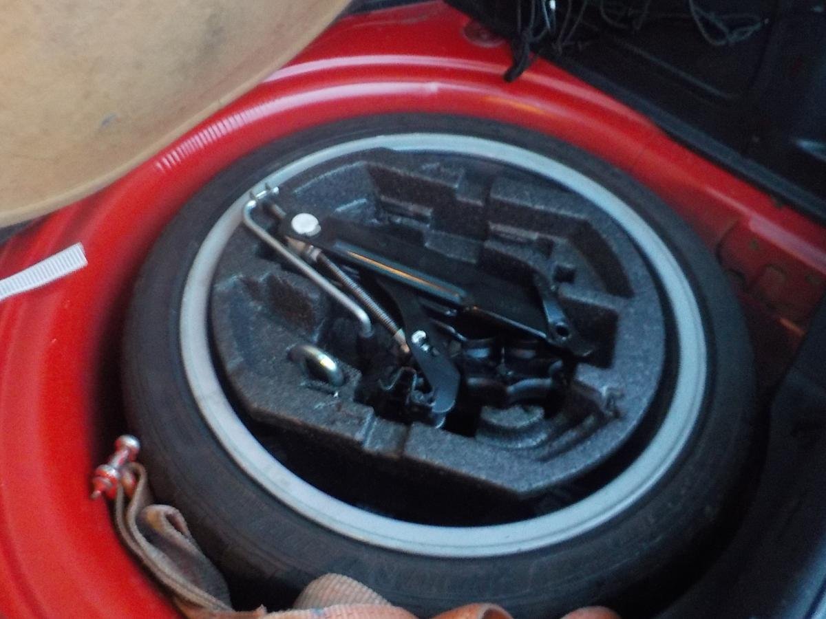

Red vRS, mine 215/45 R 17 Spare wheel.
