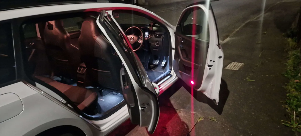

I have just finished retrofitting the footwell lights to my pre-facelift MK3 Octavia VRS. Everything worked first time and the install was super straight forward. The coding was easy using OBDeleven, and I can control the brightness of the lights with a shiny new "Footwell lighting" option in my MIB unit! :) The lights come on full brightness when I open a door/remove the key, then gently fade down to their set brightness when the car starts (if the headlights are on). Definitely a worthwhile upgrade, it makes the car feel alot more premium, and only took me about 45 minutes to install!

Picture attached of my car post-retrofit. Unsure whether to change the overhead lights to LED too, as the colour temperature mismatch bugs me!
