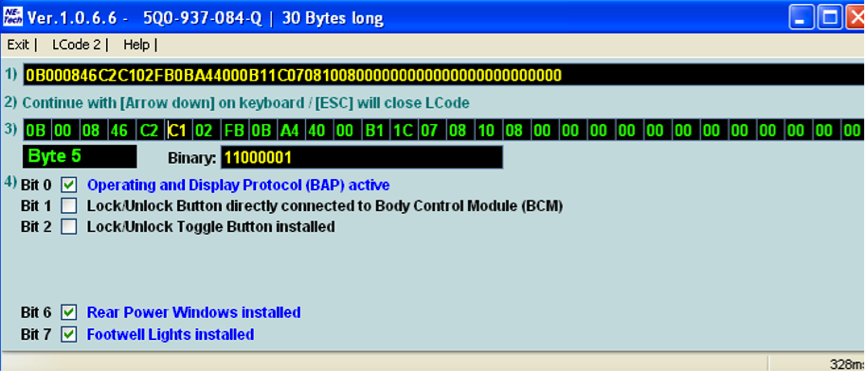

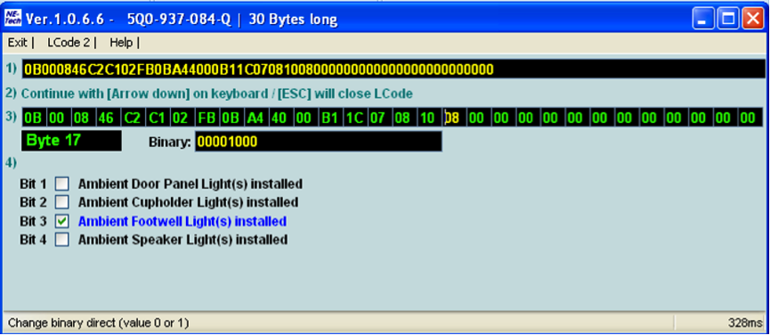

    Success!   Finally got the footwell lighting retrofit fitted, coded and working fully. They come on 100% with the interior lights when unlocking the car – the same when the doors are opened and are

  • Well done on working it out!   I'll copy across to the O3 VCDS thread BUT I can't see your screenshots for some reason???   And get your profile changed to VCDS expert LOL
Ha! Thanks Andy.
Yes not sure what happened to the screenshots - what's the easiest way to upload them - I've not done it before.
I paste the screenshots in to a word doc as I am working through a coding.
I then save them as piccies (png files I think), by right clicking on them.
Then you can add them as attachments to a post, use the 'More Reply Options' button in the bottom right corner of the quick reply text box to see this.
Once they are attachments you can insert them in line, but be careful as the cursor position keeps resetting after each one!
Screens shot of the Long Coding sections that didn't insert on previous post.
