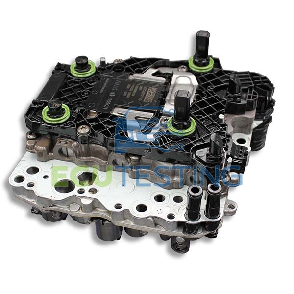

@Kevinmaj Hi, it is faulty clutch position sensor K2 ( even gears + R ), error p1736.
K1 sensor is odd gears.
Find someone who can fix it, way cheaper then new mcu board.
You will need 6L of gearbox oil, new filter and sensors which can be orderd here: https://getriebeshop24.de/products/hydraulikdrucksensor-satz-kupplungspositionssensor-inkl-dichtun

Many thanks @ile7, this is a perfect solution and reasonable considering everything. I like the fact that the company above fixes the issues with the unit and upgrade the poor components as well. I assume they replace the K1/K2 sensor as well?

No need for fitted parts from Germany and paid that price for refurbished mcu board, all you have to do is remove mcu from the car and send to company above, after repair it is plug and play game without programming, otherwise any other mcu new or repaired from Germany request programming which is extra cash waste. Contact the company for details and change both K sensors ( in your case K1 is fine, for now.. can pass away anytime )
Check "rebuild details" from link above!
