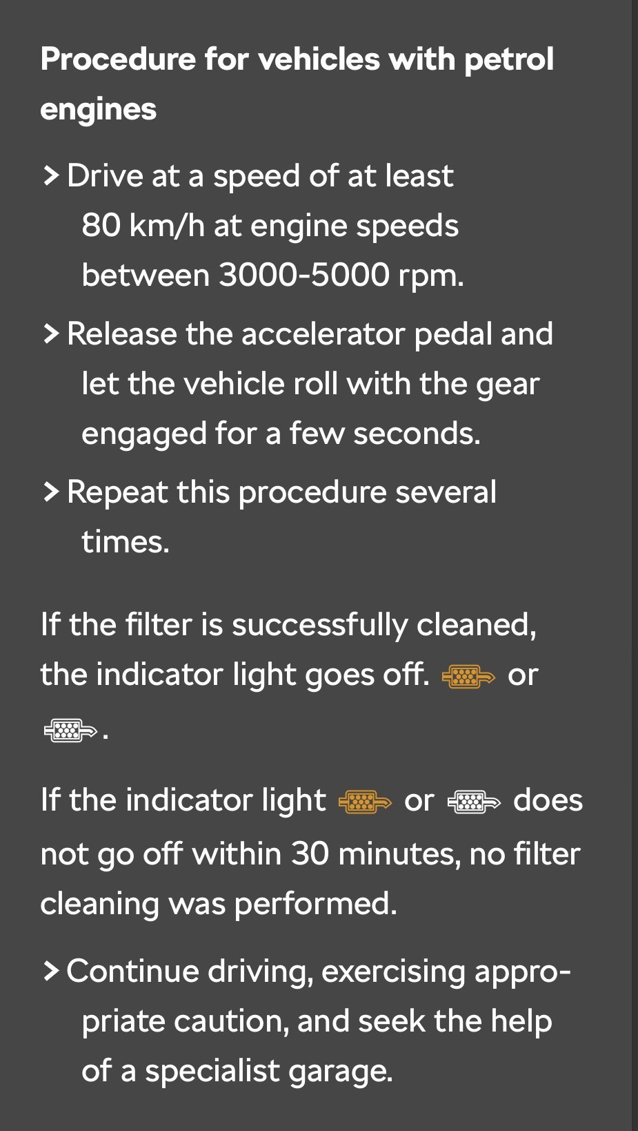

Try the way of getting the light out as comes from the owners manual.

The key for the OP is to follow the instructions in the manual to clean the particulate filter. If that does not work then professional help is needed.
13 hours ago, nta16 said:
Just getting the existing battery to a reasonable state of charge and following the driving instructions for the particle filter should help you at least in the short term.
Spot the similarities. I was referencing Ootohere's post where he's put up the driving info for the filter from the 'Owner's Manual', something I often do but Ootohere had already done this.
