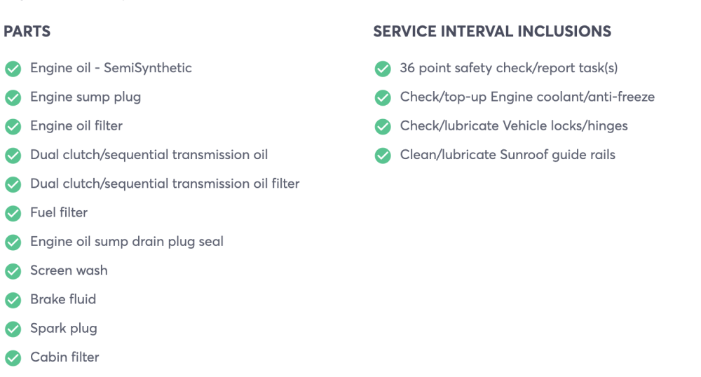

Im considering this performance garage that does BMW's and audi's and they gave the quote for $1082
Edited by ThatBlueSuperb
VW use FULL SYNTHETIC Castrol 5 W 30 LL or A3 B4 if you want to save money
Penrite Enviro+ Full synthetic is what I always used and supplied it myself as I bought it when on special
Edited by Exkiwi
Alright, i will enquire and if they use semi and i will supply them with LIQUI MOLY Top Tec 4200 5W-30
