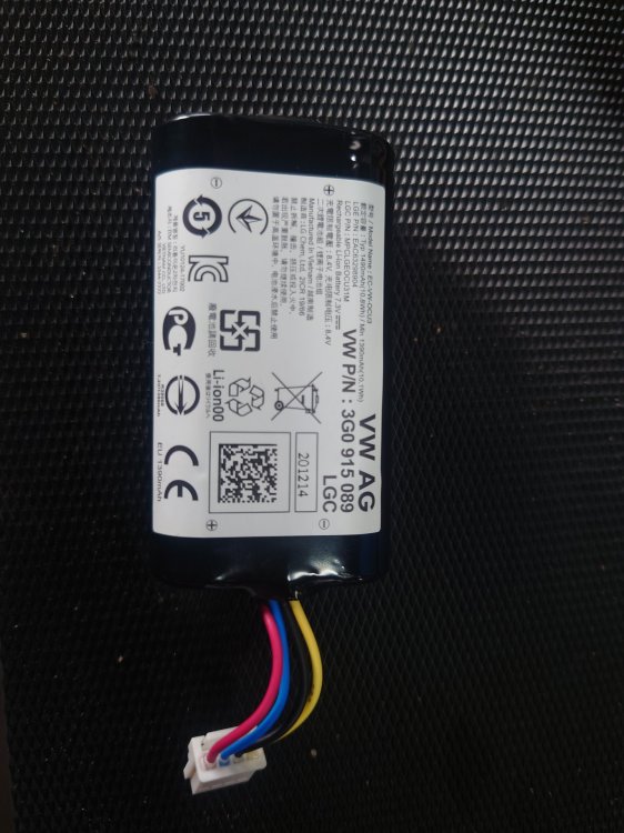

My battery was recharged at the service center at the beginning of July. Today it was found that the error persists. So, I will have to replace the backup battery in the unit. The battery has the number 3G0 915 089.

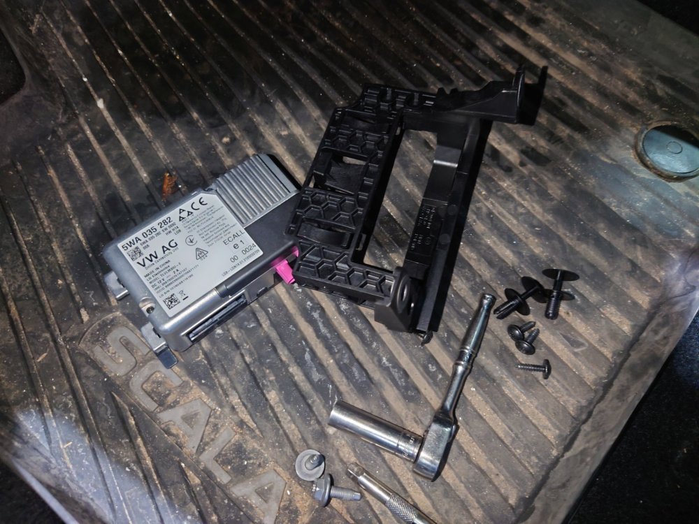

The OCU's backup battery isn't charging. If you get an error message, good luck replacing it...
Do you have more pics of dissasemle of plastics to get to the eCall module ?
This was Scala
47 minutes ago, Cairus said:
This was Scala

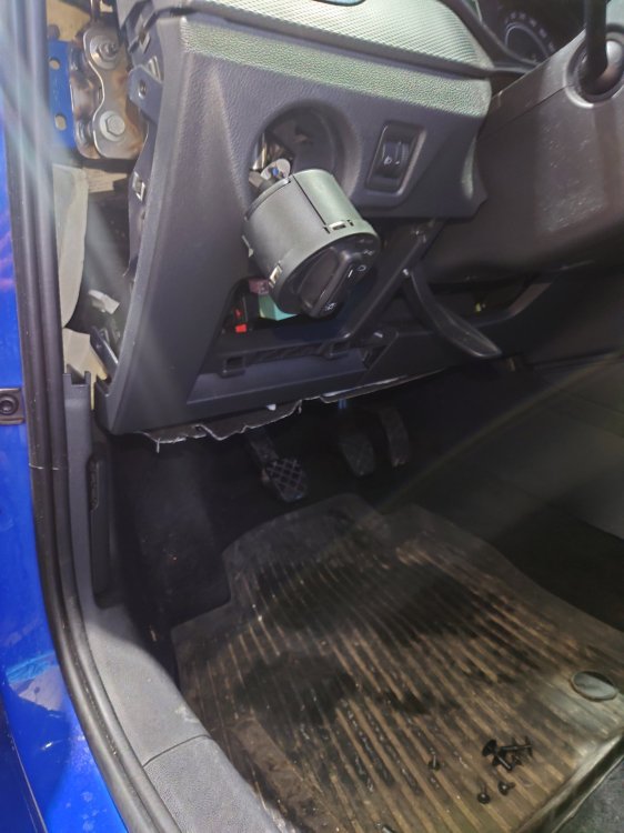

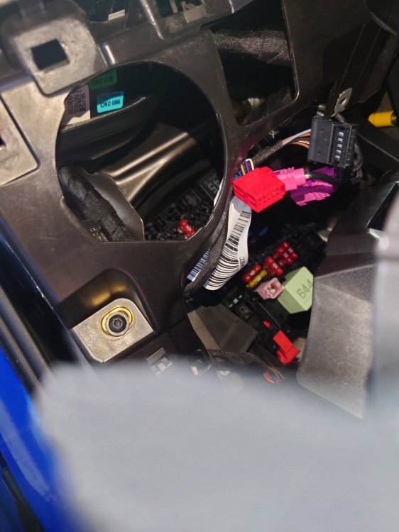

I have scala 2021 and the same issue
This
Thank you. Is left plastic bezel that is shown after door open, is on plastic clips or screws ?
