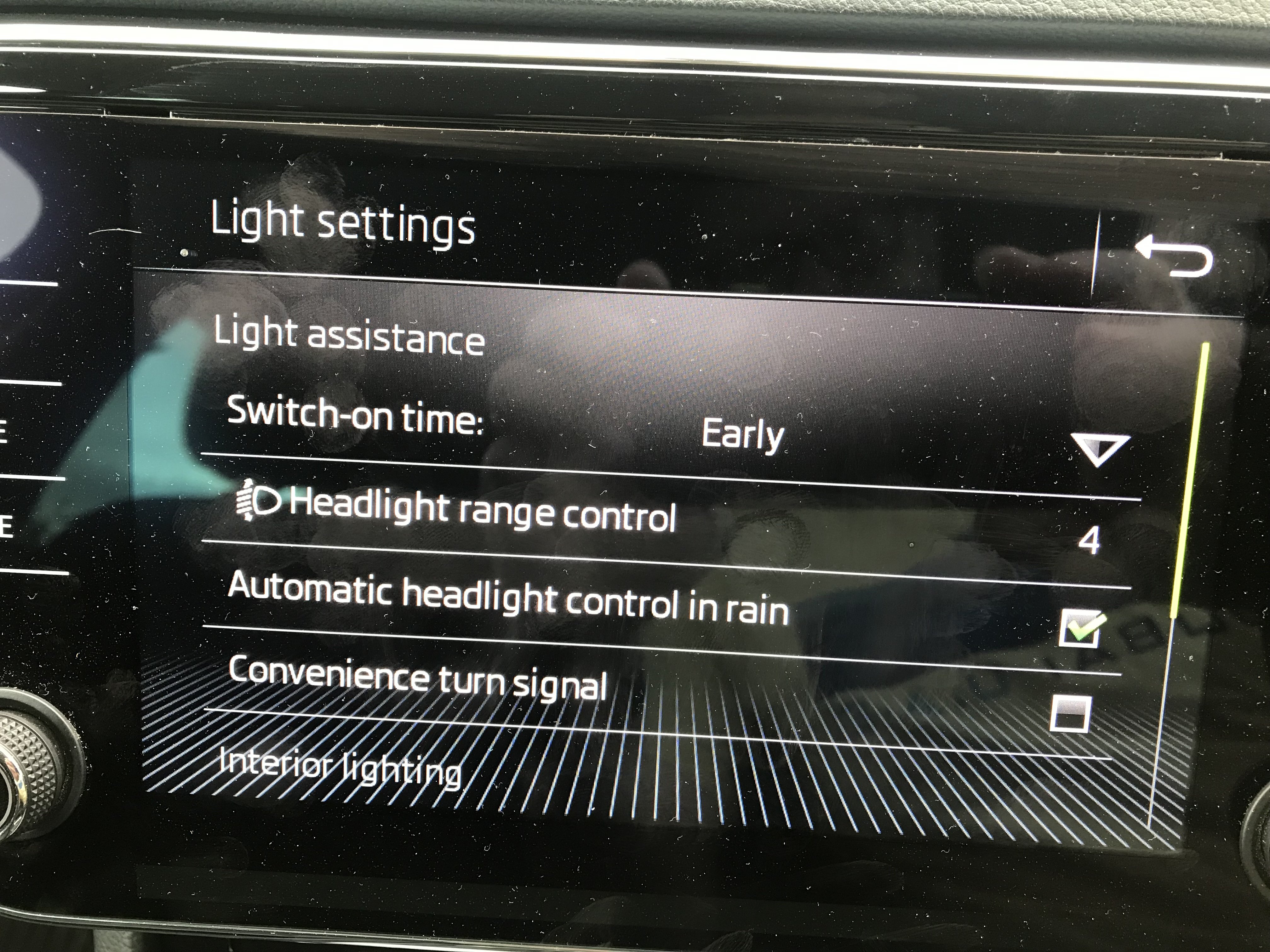

This might help:
No need for those nasty stickers on headlights
Strange that your local dealer didn't tell you about this setting...
Well, like the linked post, mine has non- matrix LED headlights and there is NO such function in the light menu settings to change for continental driving.
( 2020 SE post facelift model)
So still looking for the solution.

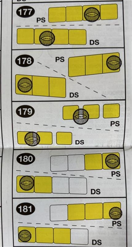

I've struggled to find the answer before. The Eurolites branded deflectors simply do not have the headlight pattern on my 73 plate SE Technology listed. When I went abroad in Easter I fitted them as per 177 in the photo (beam for Octavia Full LED 07/2020 on, Kamiq 2020-2024. However when I looked more closely only the outer two lights are on when beam is dipped. When I travel next week I will be fitting them as per 180. This is apparently the beam pattern for an Audi Q4 but we shall see.
