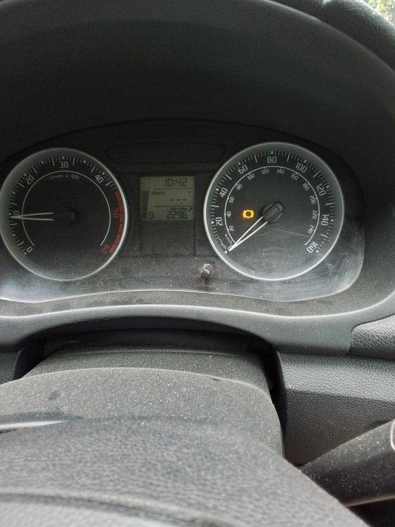

Can you post a photo of the warning light?
Photo of thr brake warning light with the engine running.
