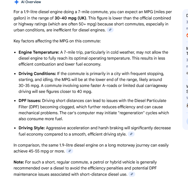

Screenshot 2025-11-11 at 10-21-23 1.9 diesel expected mpg doing commutes of 7 mile - Google Search.png
Ai appears to agree with what most of the replies so far have said.
Putting 77 litres in when almost empty and guessing at the outcome is not really helpful.
Accuracy requires full to full refueling and monitoring to get a "real mpg"

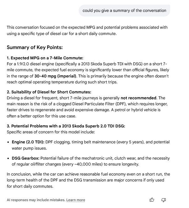

Summary after a deep dive conversation
Screenshot 2025-11-11 at 10-29-28 1.9 diesel expected mpg doing commutes of 7 mile - Google Search.png
Edited by Stonekeeper
