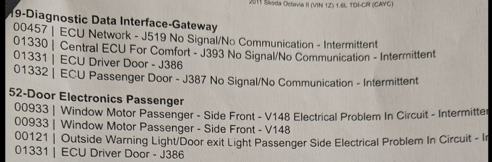

I have attached a photo on what the scan tool picked up for the window.
I have meticulously gone over the wiring for the drivers area and inspected the cabling going to the fuse box as well as inspecting the relays underneath the steering the wheel.
The drivers door motor is currently removed so please ignore codes for the drivers door.
I am assuming there is a problem with the passenger door motor as there is no breakage in the wires for the passenger door as well as in the rubber boot.

Disconnect passenger motor. If it still blows then its a wiring short somewhere. If it doesnt then reckon its the motor. Not sure on the Ovtavia but on the Fabia mk1 the drivers window unit controls the passenger side as well. Check the bulb in the door exit light and wiring. It may be the same fuse?
