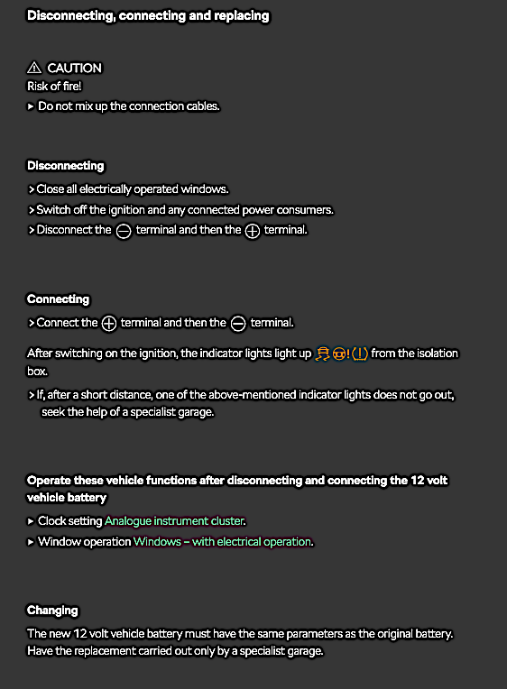

This is covered in the Fabia Mk 4 Owner's Manual (printed and online versions) and this guidance is copied from the"12V vehicle battery" section of the 20.6.2022 Manual.
If the online Manual is used, clicking on the "Clock setting" and "Window operation" green text will link to the procedure to be followed: if the printed Manual is consulted, the relevant page numbers for those procedures will be provided.

In the "12V vehicle battery" section of the Fabia Mk 4 Owner's Manual is the following advice:
Recommendations when the vehicle is stationary for more than three weeks
Disconnect the negative terminal of the 12V battery.
So - as you are only going to clean your Fabia's battery terminals (and if you are prepared to reset the time and window settings afterwards) - disconnecting and reconnecting the battery should be problem-free.
