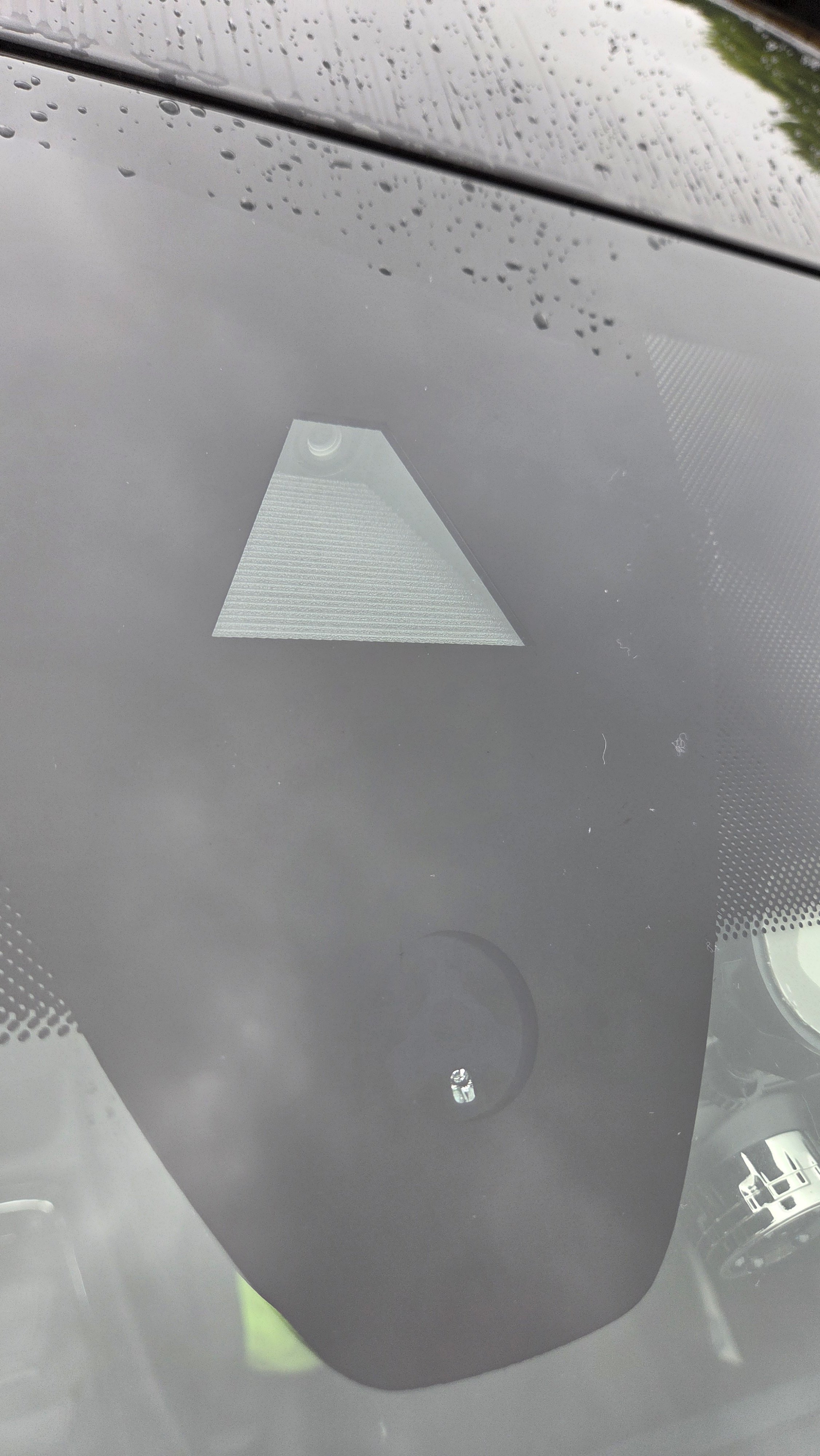

Hi, can anyone tell me which sensors are in the windscreen of my 2023 Sportline. I don't have ACC or lane assist, so I'm guessing they're just rain and light sensors (my understanding is the emergency braking sensors is behind the front grill) but happy to be educated. Apologies for the poor quality picture, windscreens are a bit reflective! 20251020_102833.jpg
You have unit A5. You can Code the Lane Assist
Thanks Cairus
It’s possible that the camera is the higher spec one that supports TSR, my 73 plate has this camera. Unfortunately the coding is protected and TSR cannot be made functional. Mine is June 23 build, if yours is an earlier build date without protected coding, if might be possible.
Every 2Q camera have SwaP Protection by TSR. Patch IT with the Dataset
