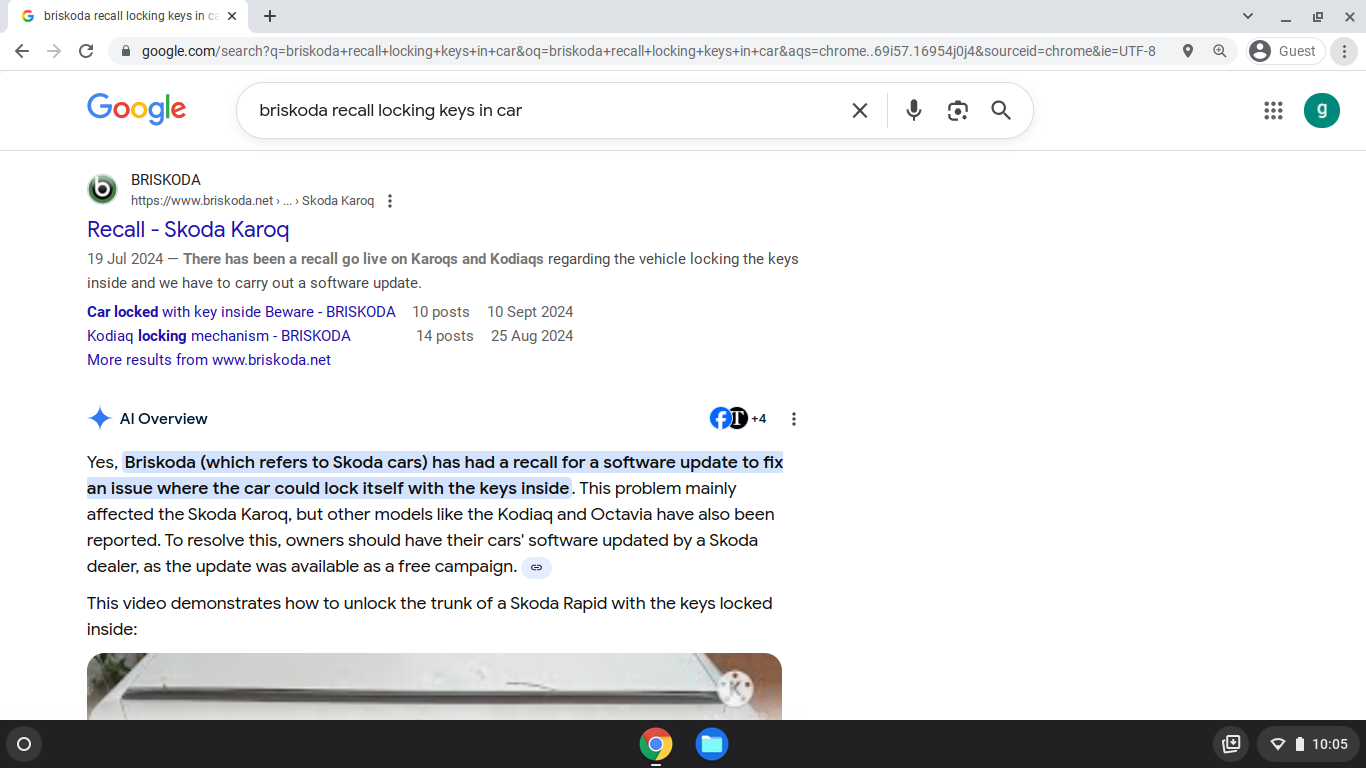

For those with newer cars, Check for the Service Campaign Software Update.
Edited by Evolution13
Hi folks
Seems this is a known issue - You can call Skoda for a free fix if you mention 'Service campaign 57NL' - Its a software fix in the car that needs Skoda service to fix.
