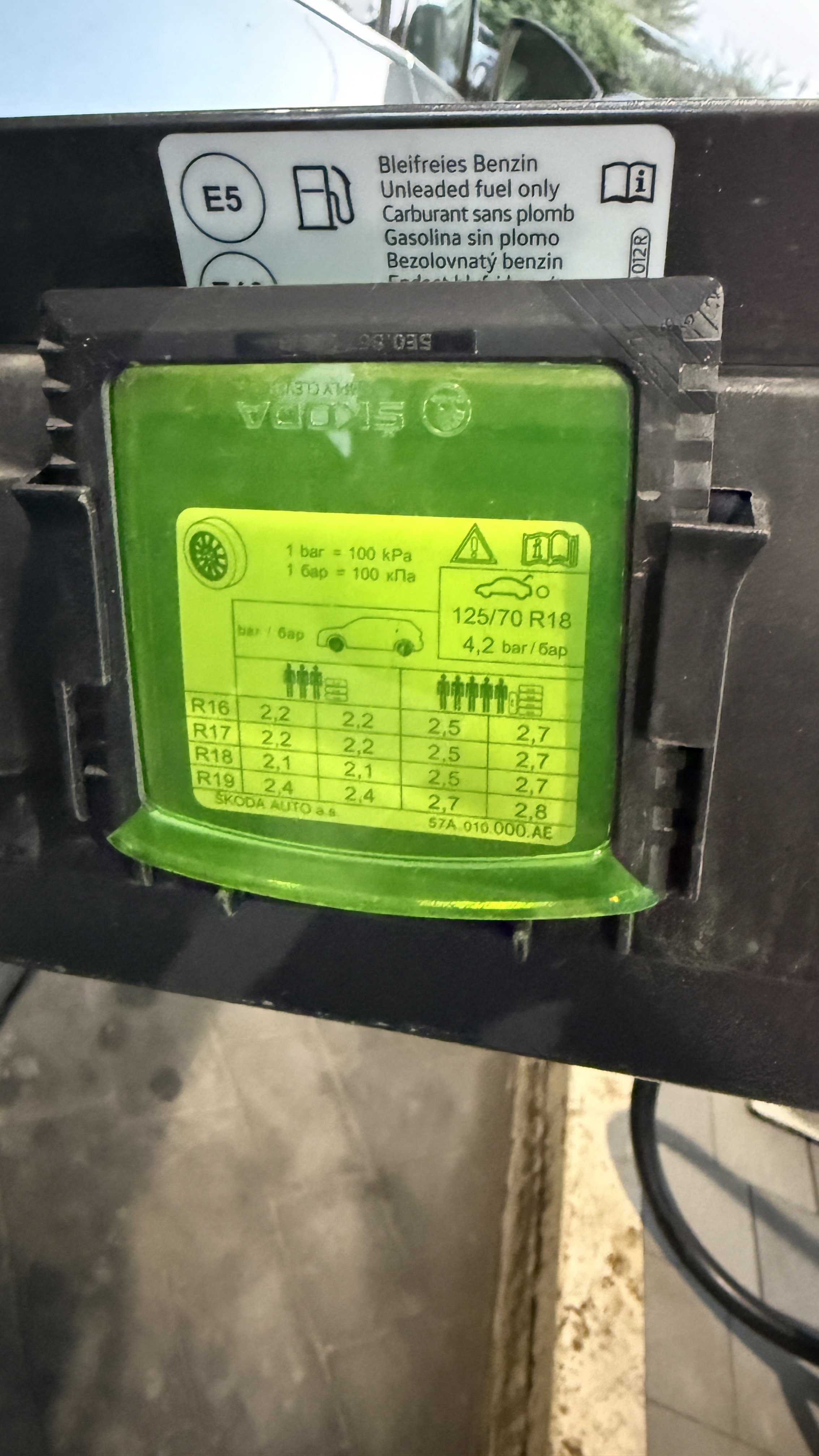

As many user of the forum, like @JR RS , I retrofit the Direct TPMS on my Karoq, definetly more useful than OEM one! I also generate the file for VCP/Odis/Binary in order to update to the control unit!, using the label on the Fuel lid (see attached file), so depending on the tyres/rims and weight I fitted on the car I can choose right pressure, just changing the wheels (on which I installed the sensors of course).
Only doubt I have is seeing the label, it refers only to STANDARD (upto 3 people and moderate luggage) and FULLY LOADED (upto 5 person and full luggage): is there a specific pressure for COMFORT (usualy we travel in 2 and with few pieces of luggage) and eventually WITH TRAILER (as I'm planning to retrofit it in the future)?
Of course I refere to the pressure for all the wheels size, that means: 16, 17, 18 and 19 inches rims

I use:
Standard: 2,5bar
Komfort: 2,7bar
Full: 3,0 bar
Same pressure on all wheels for each parameter?
Sure
On which rim? 18/17/19/16? usually how's the weather where You live? here (Rome) it's pretrty variable, from hot to cold
Edited by Benja77
17/18"
