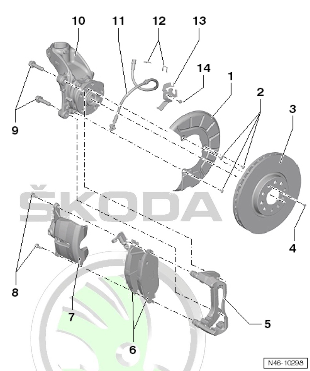

Here's a new tutorial to replace front brake pads on a Kodiaq Mk1. To begin, here's the system:
Only screws #8 have to be removed and replaced. Make sure they are supplied with the pads when you buy them. Otherwise, their OEM P/N is WHT003250.
They're already coated with Loctite.
Required tools:
- 13mm wrench for screws #8
- 17mm wrench to lock the guide rods (not marked, but included in assembly #5) and protected by a dust sleeve.
- High-temperature grease (graphite or copper-based / less than a pepper grain for each pad)
- G-Clamp and wooden block to push the piston back
- Brake cleaner spray
Tightening torque: 35 Nm
