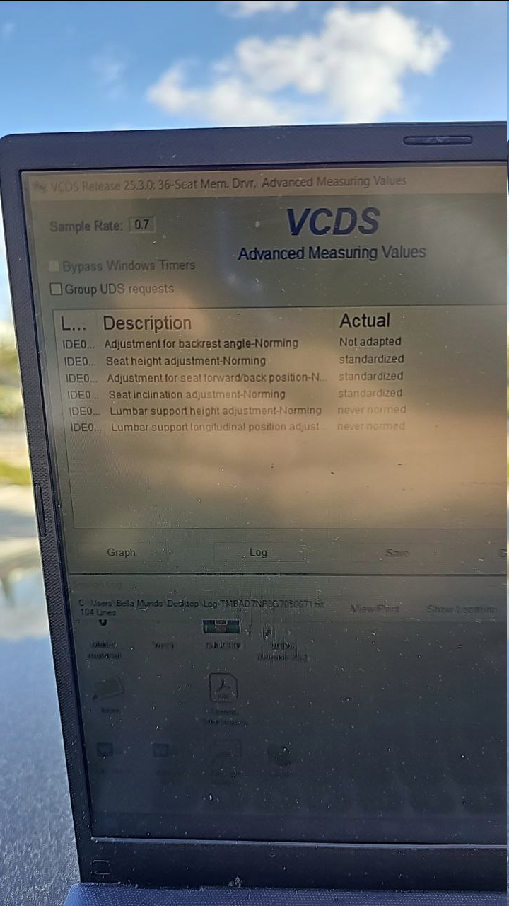

here is the error codes i found, also checked in adv mesures, all the other norming position are adujsted and only this is not "standarnized"
the motor on Backrest manual works fine and when i try to do norming only on this backrest it is trying i hear the motor for a moment and then stopping and give me "aborted due to malfaction"

here is also a picture of the adv measuring
Another update, the backrest does respond to the calibration, but at some point when it is going towards the steering wheel, its stopping, then i get the error, but it does respond and trying to do it so the motor is ok and such.
Maybe something stuck in his gear? Or something similar?
@Cairus what do you think?
maybe something got stuck in his gears and making the power spike and shutting down the motor thaus the error i get on the backrest and not finishing the calibration
