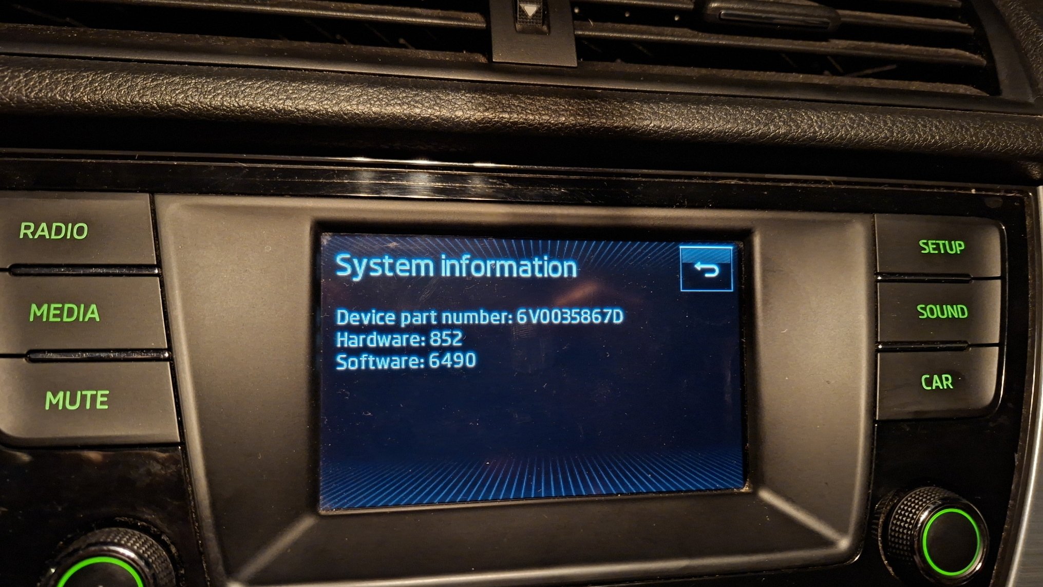

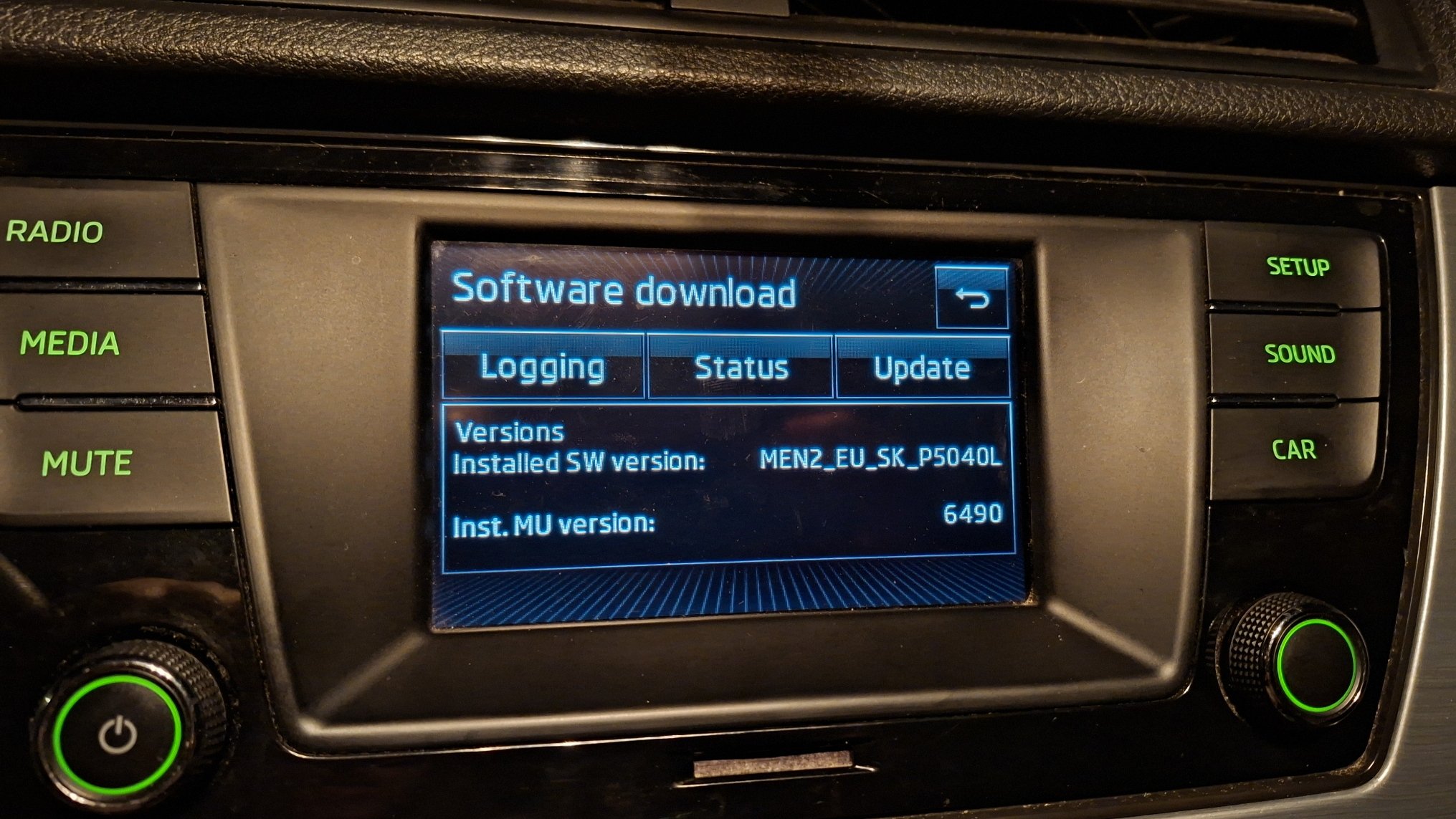

so ive recently gotten a second hand 2015 Fabia stationwagon and i have some questions about the infotainment system.
my car has the SWING radio infotainment system. i have been told my version is an older version and does not have bluetooth capabilities. (which kinda sucks)
part number: 6V0035867D
software version: MEN2_EU_SK_P5040L
MU version: 6490
i mainly have 2 questions about this system.
1: is there an update available for this particular system?
and
2: is it possible to replace this unit out for a (newer) SWING, bolero, or amundsen infotainment system for me to have access to the bluetooth function.
i have attached some pictures for clarity i apologize if their quality is subpar.
(P.S. i apologize if im asking some stupid questions. ive been researching for a while and i am quite lost)

Ad. 1 I don't have any update for your unit.
Ad. 2 - yes, it is, fortunately in SWING units Bluetooth is NOT covered with FEC/SWaP codes so just removal of Component Protection and adding a microphone is enough.

@pab567 thank you so much for providing some answers! i do however have small follow up. what would i have to do to remove the component control. or would that have to be done by a proffesional?
be done by a proffesional - contact your Skoda dealer or someone having ODIS online account for Skoda.
