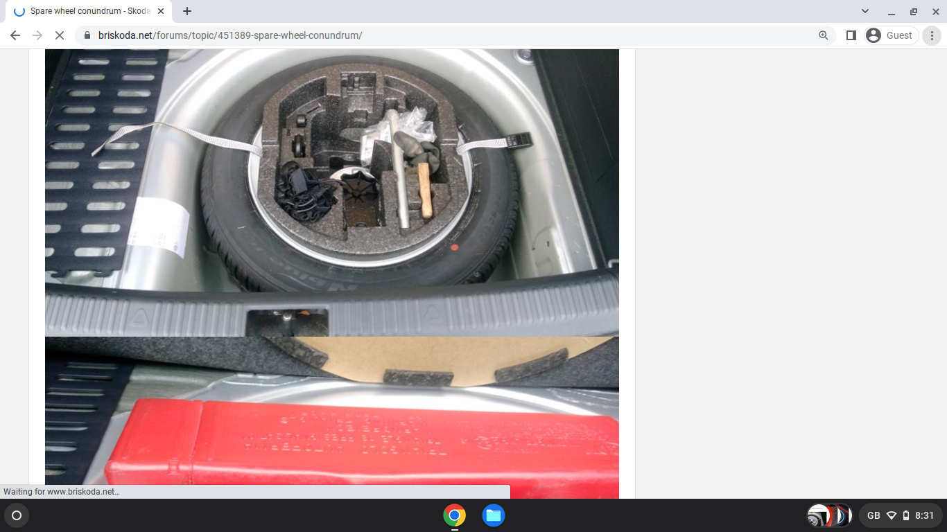

The wheels and tyres on the car now will fit in the spare tyre well. Well one will. Take one off the car and try.... If you have a spare and a full car and need to change the spare the tyre off the car should go in there flat or not. Loads and loads of threads in this section asking about Spare Wheels / Tyres. worth doing searches sometimes.

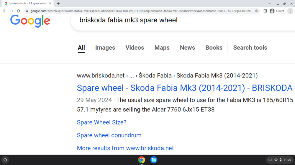

Skoda sell a spare wheel kit for the Fabia MK3 that fits in the spare wheel well. It has OEM part number 6V0093860B which includes everything except for the actual spare wheel. The spare wheel that's normally fitted to these is 185/60R15 6Jx15 ET38 5/100 57.1 and can be ordered separately.
This spare wheel kit can be ordered from any VAG parts department by quoting the OEM part number, ie. 6V0093860B
The below "skoda eshop cz" website doesn't ship to the UK, but it's a useful website for finding out the OEM part numbers of spare wheel kits, etc.
If you want to order a 185/60R15 84H 6Jx15 ET38 5/100 57.1 spare wheel (tyre fitted to steel rim)...this can be ordered from any VAG parts department by quoting OEM part number 6V0601011M. However, if you want to choose your own make and model of spare tyre a 6Jx15 ET38 5/100 57.1 steel rim can also be ordered from any VAG parts department. They should be able to find out the OEM part number for this from their VAG computer system using the car's VIN number.

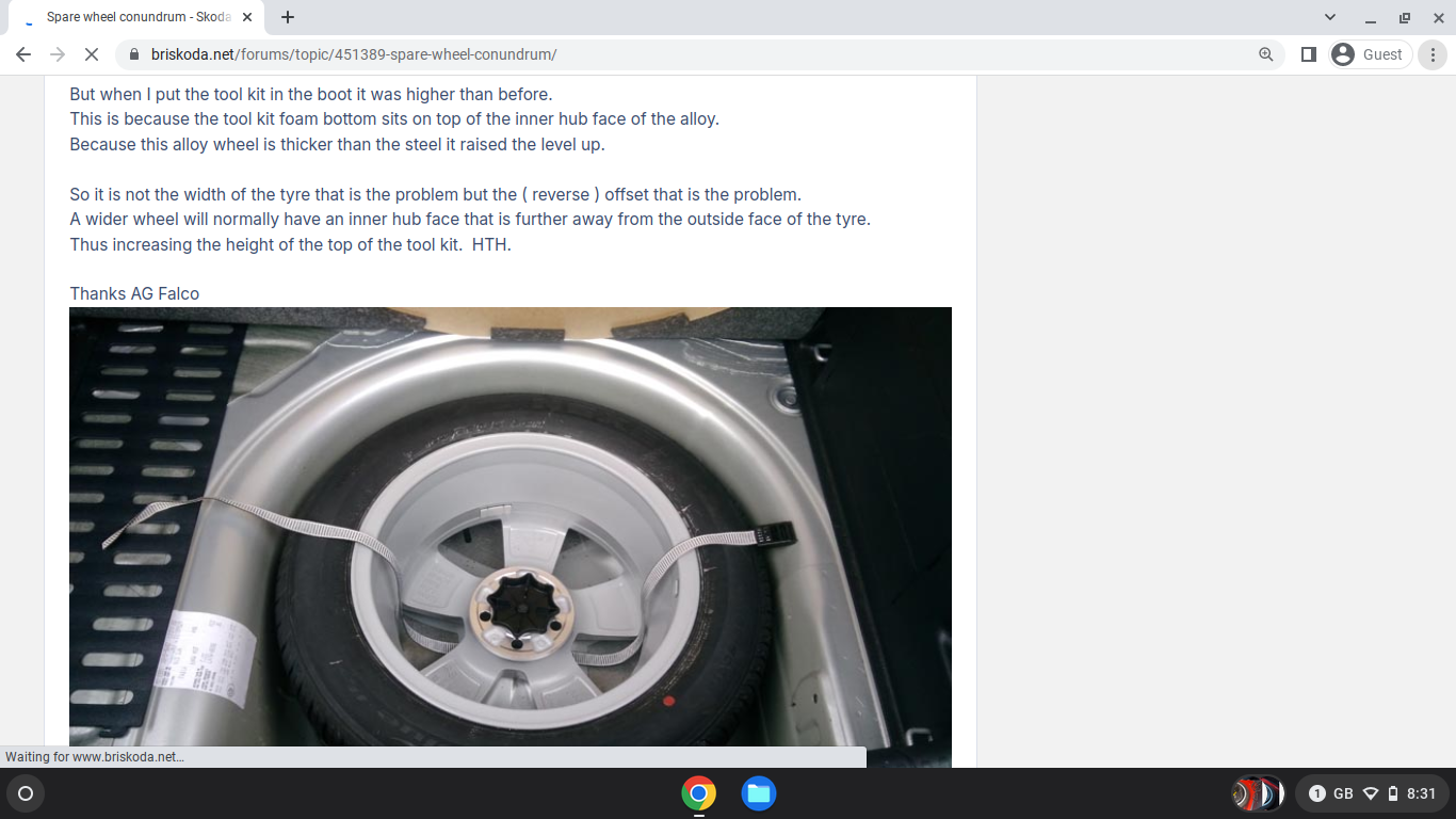

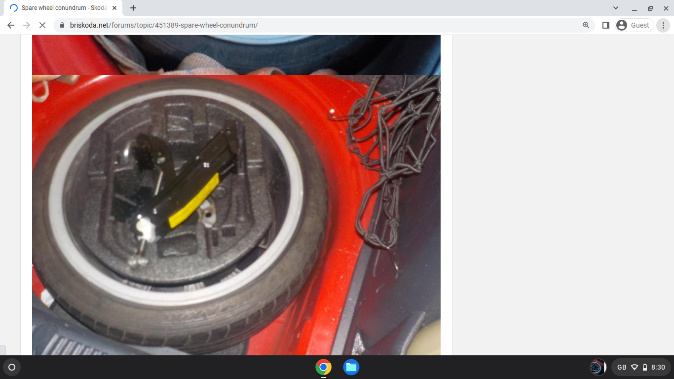

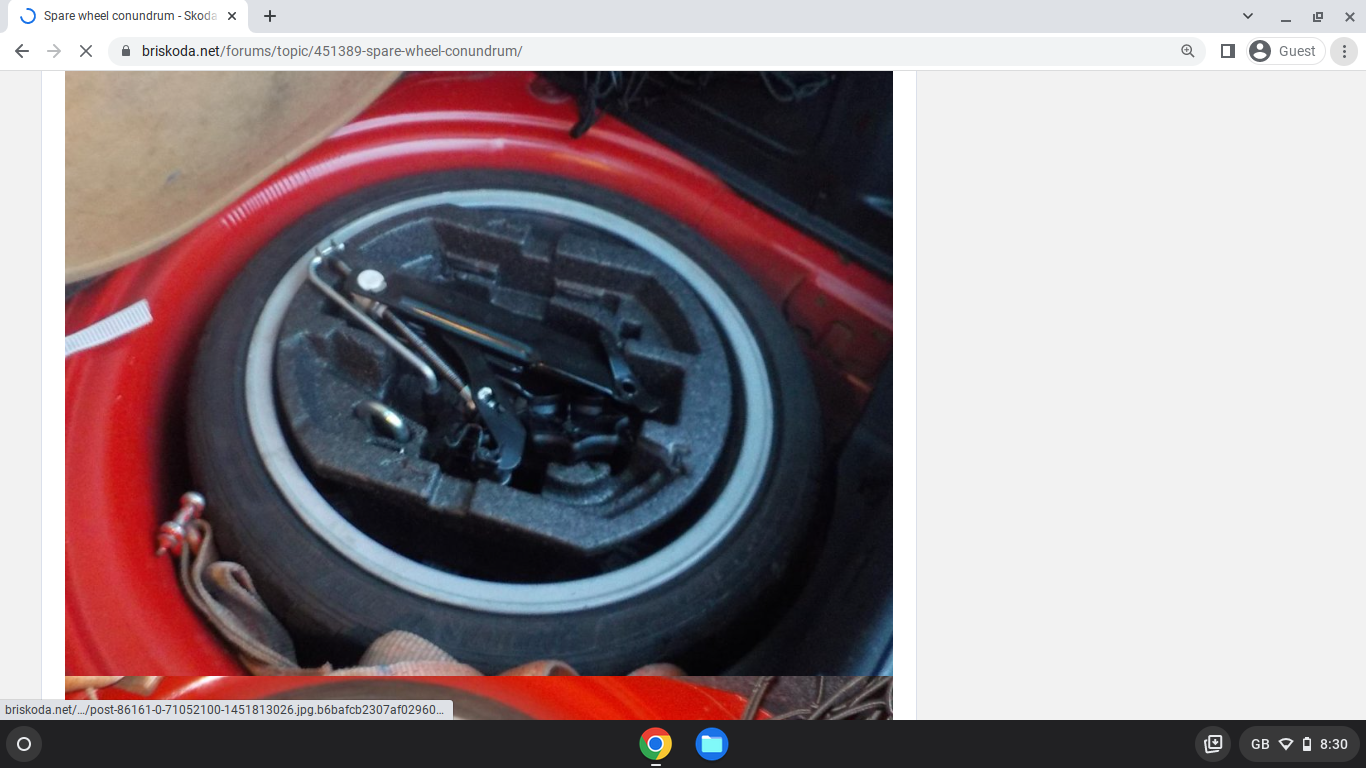

But as seen above, loads of room and even a 215/40 R17 or 205/45 R 17 fits in. AKA Full Size Rims and Tyres as might fit a Fabia, and without the floor sitting higher.
Just looking at that photo only, which might or might not be accurate (stock photos) 205/45 r17 might be a bit tight being nominally 1/2" (15mm) wider but sizes are nominal and will vary by make and model of tyre and might depend on whether you keep the spare tyre at the highest pressure for the car against the lowest.
A 215/45 r16 is nominally slightly not as wide as a 185/60 r15 and given the generous space above the tyre lying in the footwell (of that photo) should fit easily.
It is damn easy. Take a wheel off the car and try in the spare tyre well. Less of a song and a dance and this might and that might not crap needed.

Many a car have front wheels and rear wheels of very different sizes / widths and no spare, even Skoda ev,s. As to trying thd road wheels fitted to the car, in the space for the spare am i the only person that has done it? I think not. The spare wheel well is thd same dimentions mk2,3 and 4.
