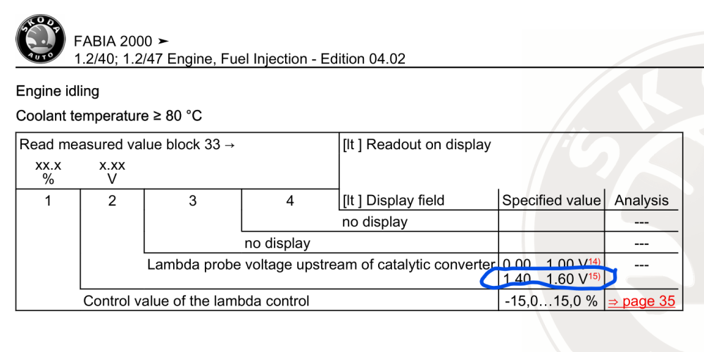

I looked back at the workshop info, and 1V could be correct if you are looking at measuring group 31, (red ringed info) or 1.5V could be correct if you are in group 33 (blue ringed numbers).
Perhaps you looked at 33 before the sensor change, and 31 after?
Note 15 is for AZQ engine code.
Please check again the numbers in groups 31 and 33, with engine fully warmed up.

Just realised that group 31 is lambda nominal value, not voltage, in the table for AZQ engine.
Group 33 is showing voltage;( for AZQ, the 1.5V I had remembered).
