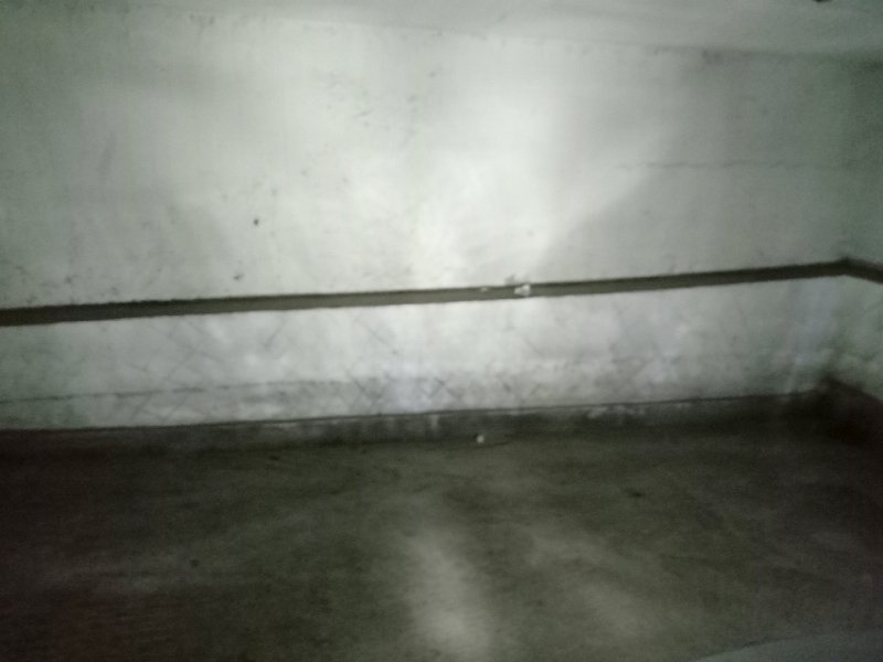

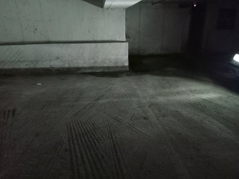

I tried to find a dark area with no external lights and take some pictures from my new bulbs that i have installed,the spot isn't ideal but it's impossible to find a dark alley here to take photos.
The new bulbs are 2.5W and 5500K but the result is very different with the previoys ones.

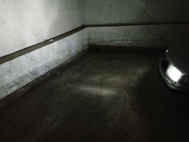

I am standing upright in the driver's side and below

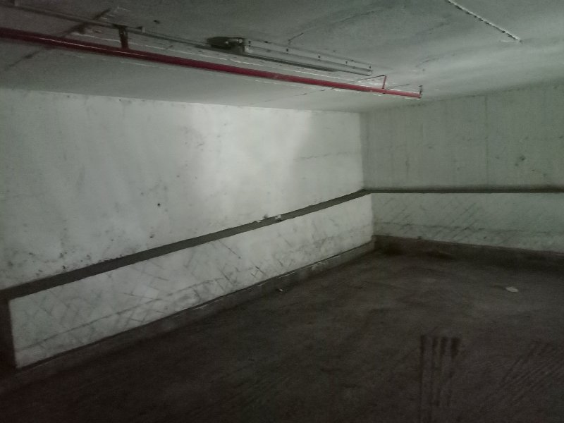

is how they look from the side.

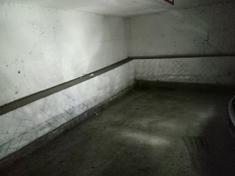

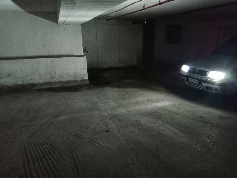

Here, from closer distance.

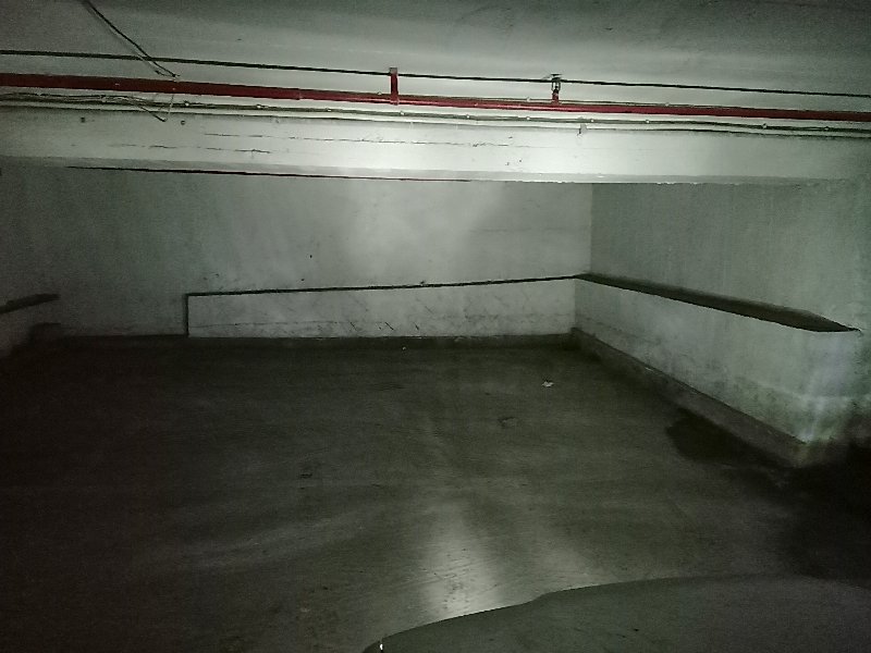

To me look like a WWII A/A gun projector searching in the sky for hostile aircrafts. 😲
parking lights are meant to be all over as to be able to spot the car easily but these are very bright
2.5W LED is like 15-20W incandescent. You need something below 1W.

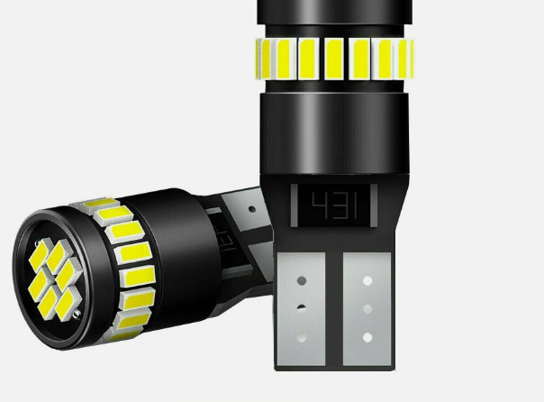

You will not achieve anything, I use these on all my vehicles where white W5W are needed and they play rather well with canbus.
Except for Felicia's license plate, where I use these.
In licence plate i have White 6000K now (the factory yeloowish burned after so many years).
Look like these:

Look like these:
Very similar, I just chose a metal body for better heat dissipation.

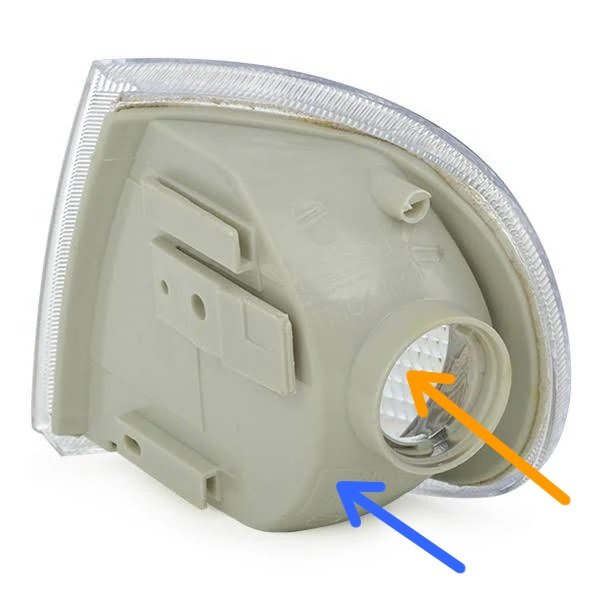

This is Skoda Felicia's front side indicator (here we calle them ''Flash")
images?q=tbn:ANd9GcQXuD6koyaeHCxHOsMspYZ
Here is how it looks from inside
Orange arrow = the socket for orange bulb

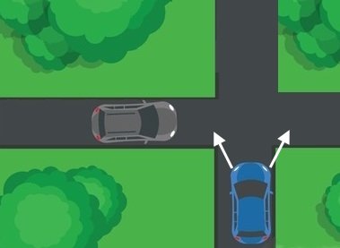

Blue arrow = my idea to make a patent, installed a extra Led bulb and turn them on when i am in City at night looking for a parking space, lot a small dark side roads and danger from other drivers so these bulbs give a more wider \ / pattern in my light so let's say ''in advance'' the other drives can see (via that light) that another car is coming.
Here is an example (my photoshop)
I will post pictures in the future.
Yes, us oldies at least, in the UK may call the indicator lights flashers (but there is another use of the word to mean something very different).
The lens pattern is to disperse the light from the indictor bulb so how would the secondary LED give a wider pattern unless the LED is specially angled to do so?

The extra led bulb isn't something strong so does not create problems (blur) to other drivers although the cover is plastic, just shows one click better than another car comes from corner.
In City dark small roads in low speed helps a lot, no gain in Highways or Mountain roads.
