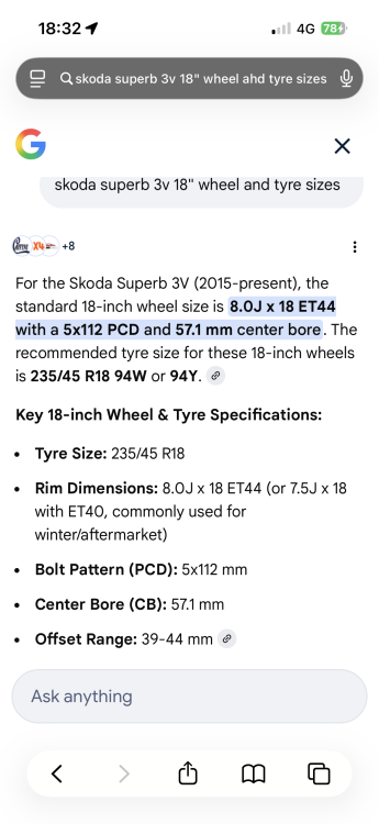

Hi - looking to fit 18's instead of the standard 19's for a more comfy ride.
Can anyone advise the ET and tyre size to maintain diameter ?

This should be it
No less than that ... i got Kodiaq wheels (cannot find the post, sorry) with a smaller channel and ET43 and I will add spacers come spring, as they look a bit "too in"
Thankyou travs - wont be going smaller than 18s
