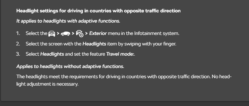

Reading the helpful reply from @Stonekeeper , it seems that the lights themselves probably have a flat beam and so need no adjustment when travelling on 'the wrong side of the road', whatever side that may be for you.
What does clearly need changing, based upon the manual, is the detection technology which scans the road ahead for cars - both those ahead of you and oncoming. I had this same issue on our RR Velar and, on the occasion when I forgot to reset it upon our return to the UK, the adaptive high beam was causing issues because it was scanning ahead incorrectly.

As @Stonekeeper says, it’s a very easy switch over. Much easier than tape!

As my Mk4 SE L has the option to change in the settings, I’d be surprised if it changed automatically to be honest. Check out the settings before travelling would be my recommendation.
