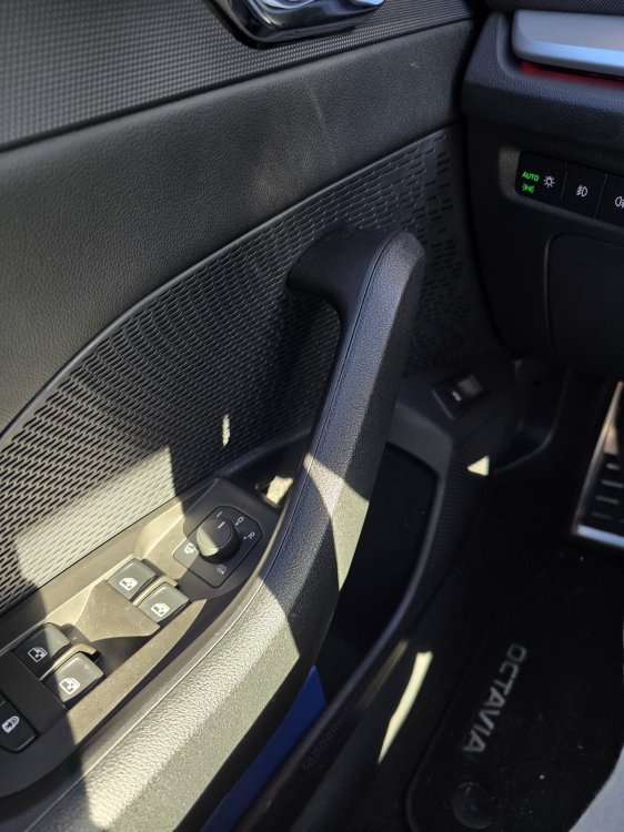

Squeaky internal door handle
As the title reads, this door handle squeaks a lot when driving due to my knee resting on it. Anyone else has this same issue? And any potential fix?
Ive tried to adjust it already to see if maybe a clip needed to go in somewhere but it keeps on squeaking.
Any help will be appreciated!
I assume you mean the door pull ? It bugged me, my previous Octavia and my wife's Fabia's door pull were (and are) rock solid with no squeaks.I even tried packing the hollow parts of the door pulls with foam. Made a little bit of difference.Then I tried teflon spray on all the touching surfaces.Much better. Not perfect,but I can live with it.
Yes the door pull is what i meant, good to hear that teflon spray helped! I was going to try that as well, just did not want to mess with the interior. Thanks for the response!

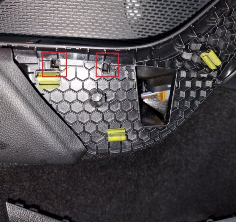

So,yes you are right. Its also possible that the window switch trim is squeaking.
For this case take the handle cover off an spray into these little holes. There are the clips of the window switch trims which are causing the noise..
