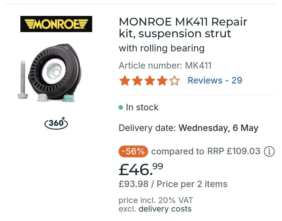

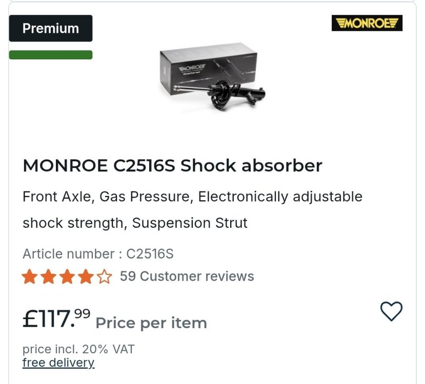

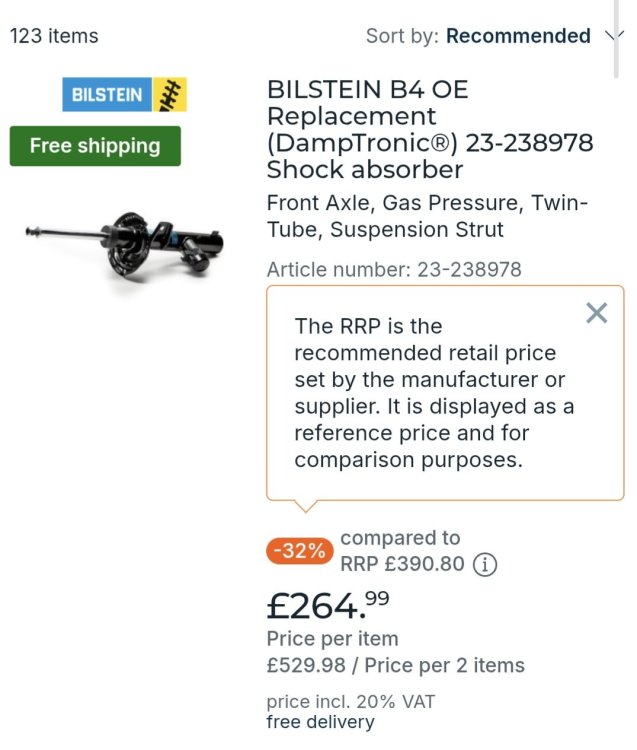

Can someone confirm if these front dampers are the correct ones i would need for my car which is a 2023 superb 2.0 diesel estate 200bhp.

The Monroe one? Autodoc seems to have it down as the correct part.

The big pity about the Monroe seems to be build quality. I had a front start to leak at about 28k miles/4 years.

Mine started to go at 60k or just over.
But the prices above compared to TPS is around £450 cheaper so i can live with it if they go bad again.
